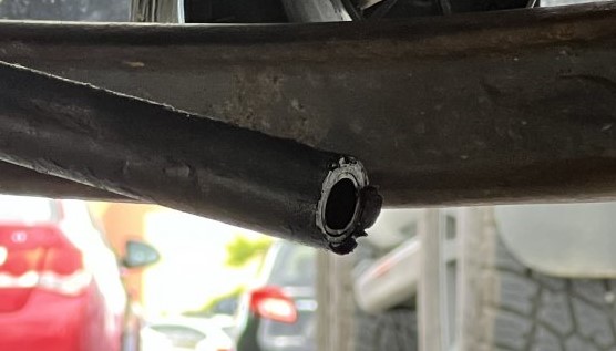

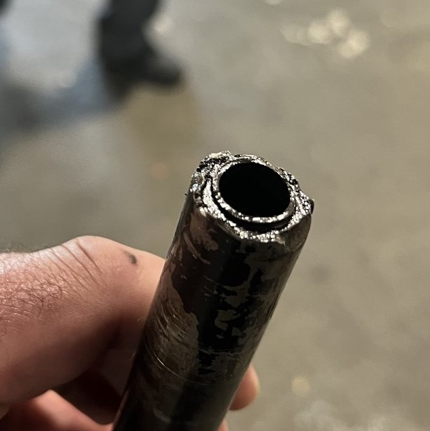

    is that a thin wall slug on the inside? I have done fabs like that using an heavy wall outside sleeve of known quality steel..

    Seems strange to have a tie rod that is welded in the middle...All of mine are threaded one piece tubes....No welds to break....

    Most likely, the part was welded well, but then someone didn't like the weld build up so they ground it off smooth and painted it pretty.

    Well the comments are correct , when welded properly safe as a solid tube . The correct way is to cut the length off a threaded end and retread not cut in the middle and stick it back together .
    I can tell you I have stuck lots of lengths of pipe together , the welds were x ray tested and are stated to be stronger than the parent metal of the pipe . All of the pipe welds were hydro tested for stress also . I really think you are the luckiest man on the planet at the moment she gave up the chase .
    This is a prime example of because many think they are a pro , doesn’t always provide you with SAFE workmanship . This very easily could of killed many .

    Looks like a piece of thin wall tubing for alignment, and then about 30% weld penetration (if that), none of which got to the useless slug. I'd be crawling all over and under that beautiful car looking at everything suspension and frame related. This tie rod breaking could be the canary in the coal mine.

    When ever joining two pieces of tube leave a slight gap , fill the gap with your weld . Weld the slug and two pieces into one . This is the last resort , cut it to length and rethread or have a new one of correct length made
