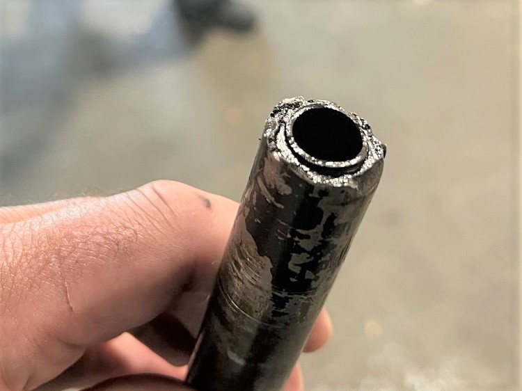

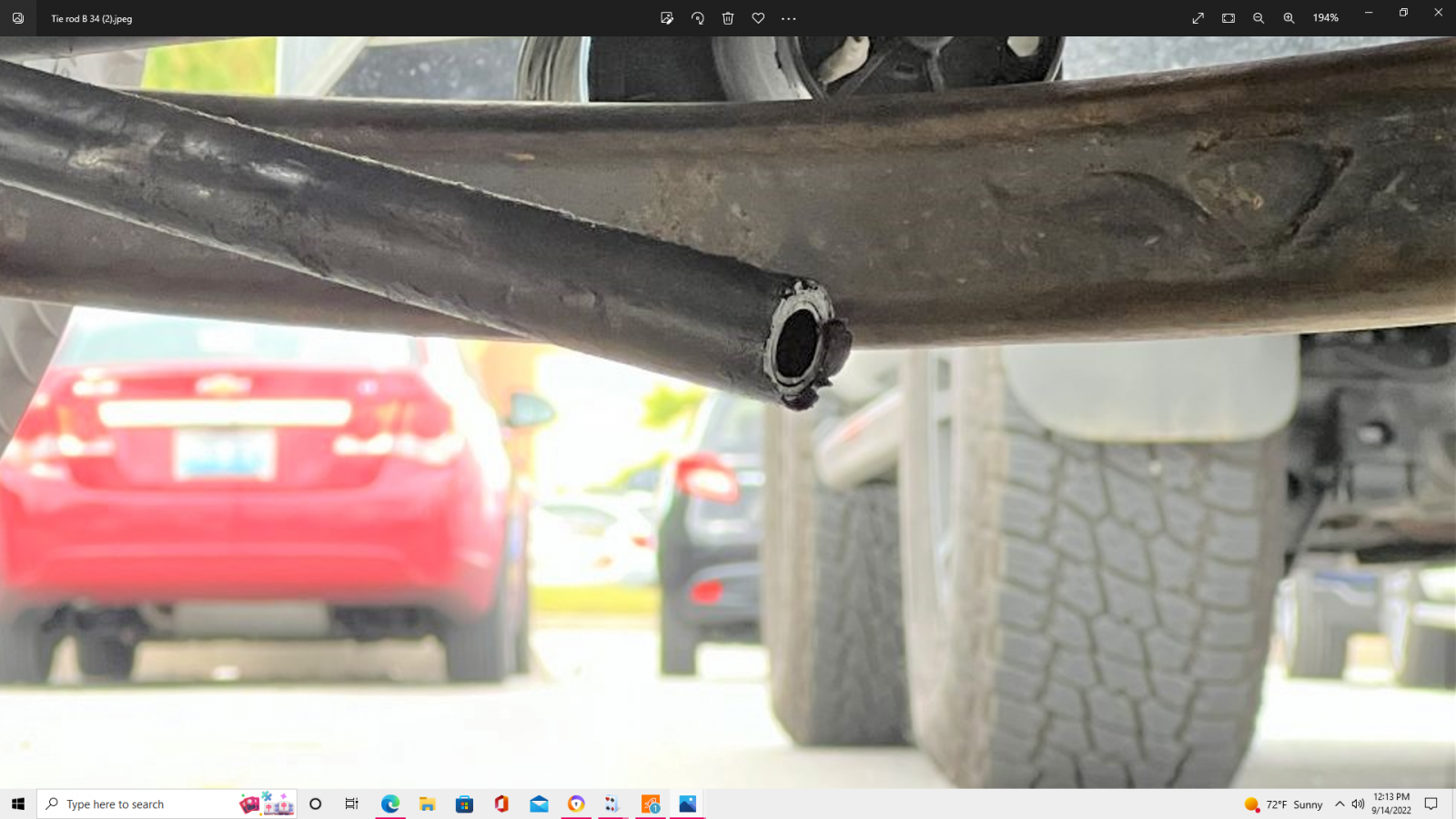

    Almost word for word on what I was thinking, after they ground what weld they had on it down most of the work was being donee by that thinwall.
    It rather looks like that the tube slipped down the inside of the tie rod when they stuck the other end on. That looks like a cut end rather than a break and tear.

    In the above picture it shows that the weld has no penetration. You are so lucky that you weren't hurt and your car wrecked.

    "Magnafluxing" to what purpose? If the weld is properly designed and executed, magnafluxing isn't going to add anything. As @choptop40 pointed out, that tube should have had a heavier slug and rosette welds instead of a weld with almost no penetration.[​IMG]

    "that weld would have been fine if it was done right." Really? Driving hot rods on public streets and roads, whether on a once in a while basis or in daily use, would make it necessary for those vehicles to be built to industry standards. Whoever made that weld did it to no standards whatever so, it wasn't done right. Butt welding a piece of tubing in the steering system with little knowledge of what the welder needs to do to make it safe isn't right and you can't make that weld right without changing how it's done.

    With that blown up pic we can't even call that a weld. Looks like a rat went around it takin a shit.
