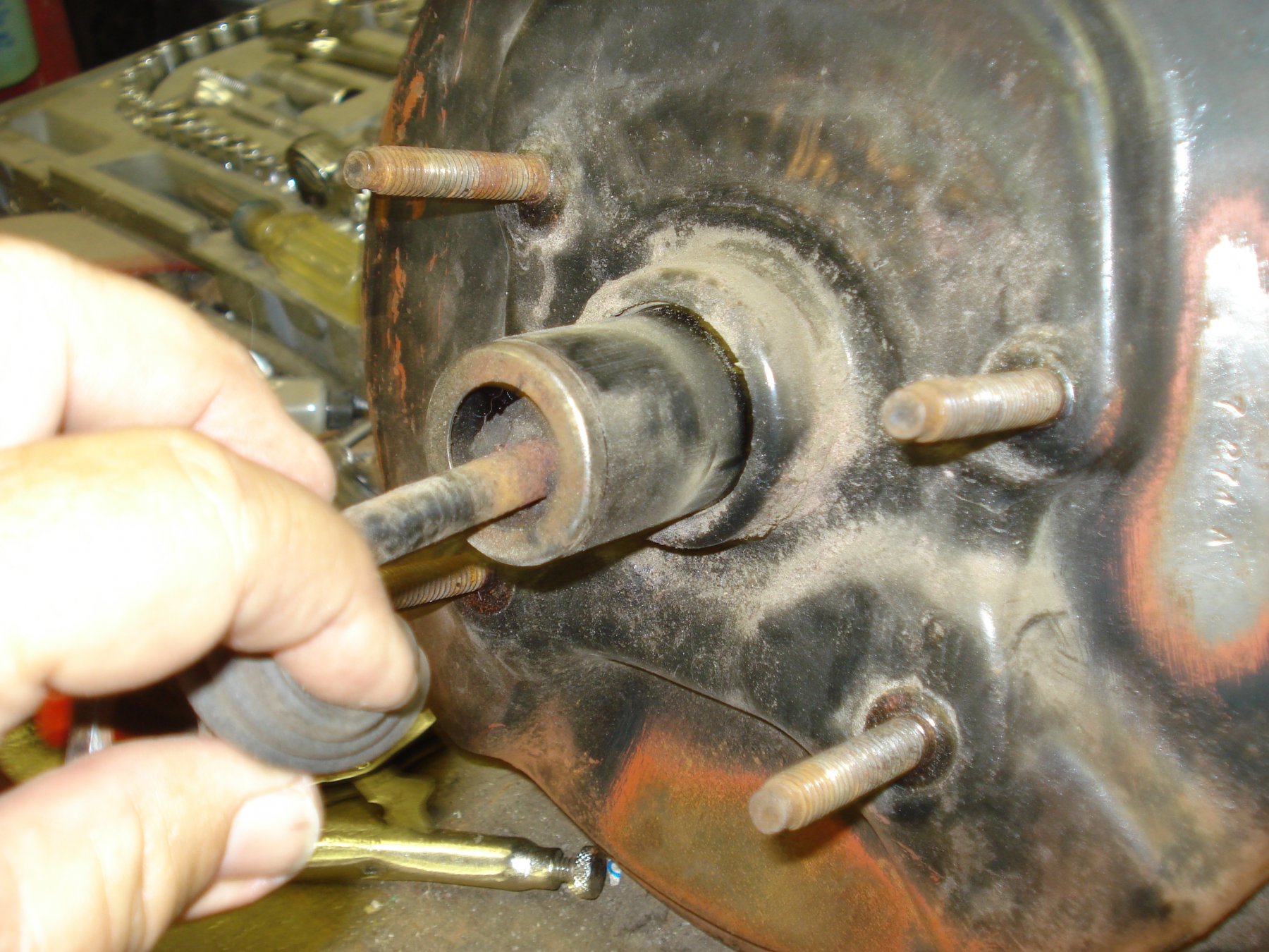

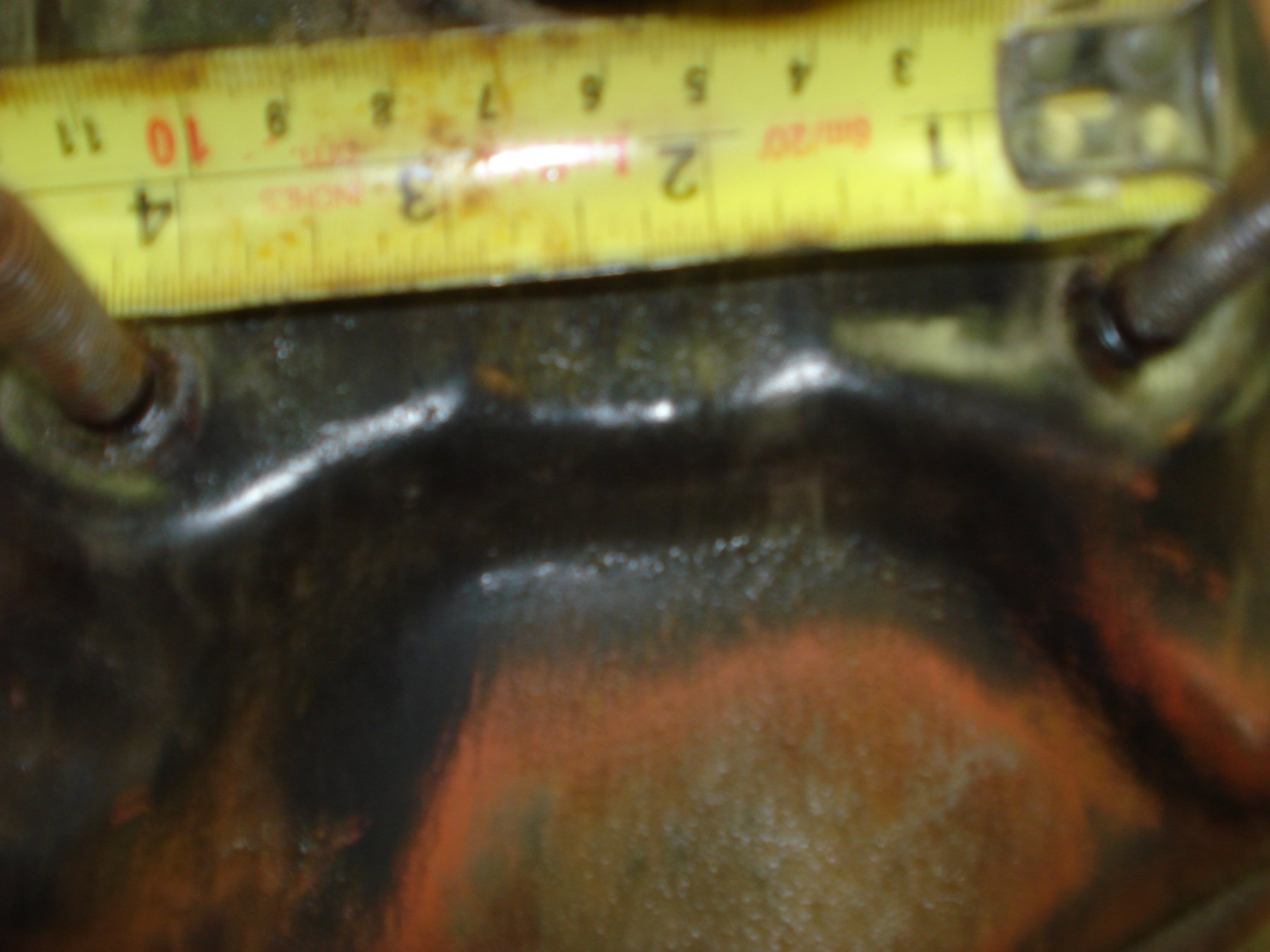

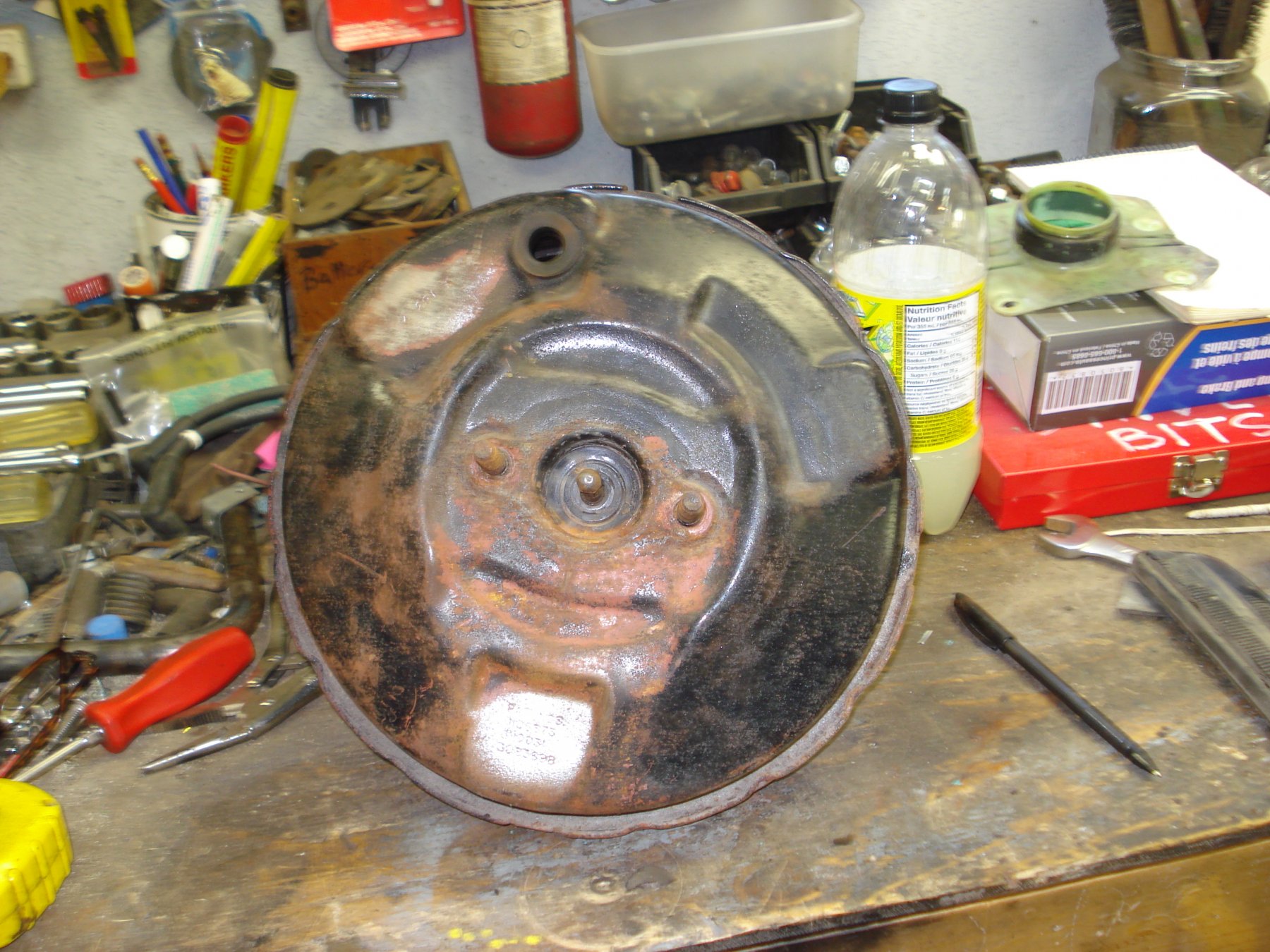

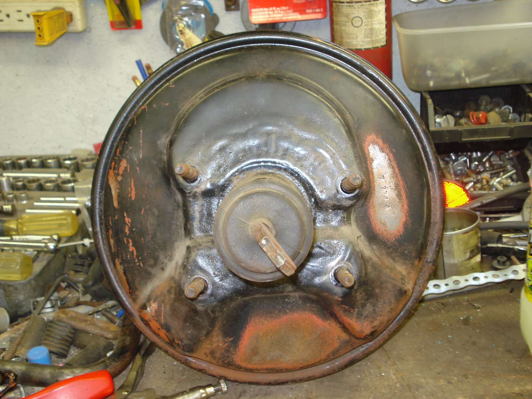

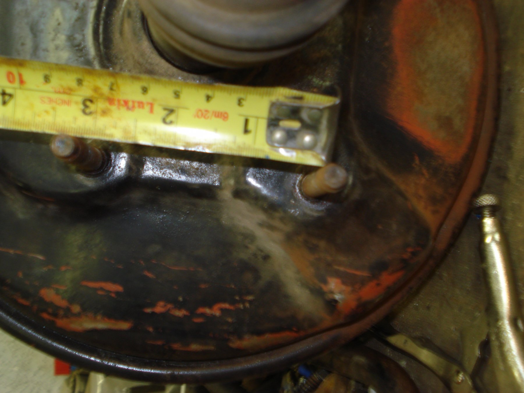

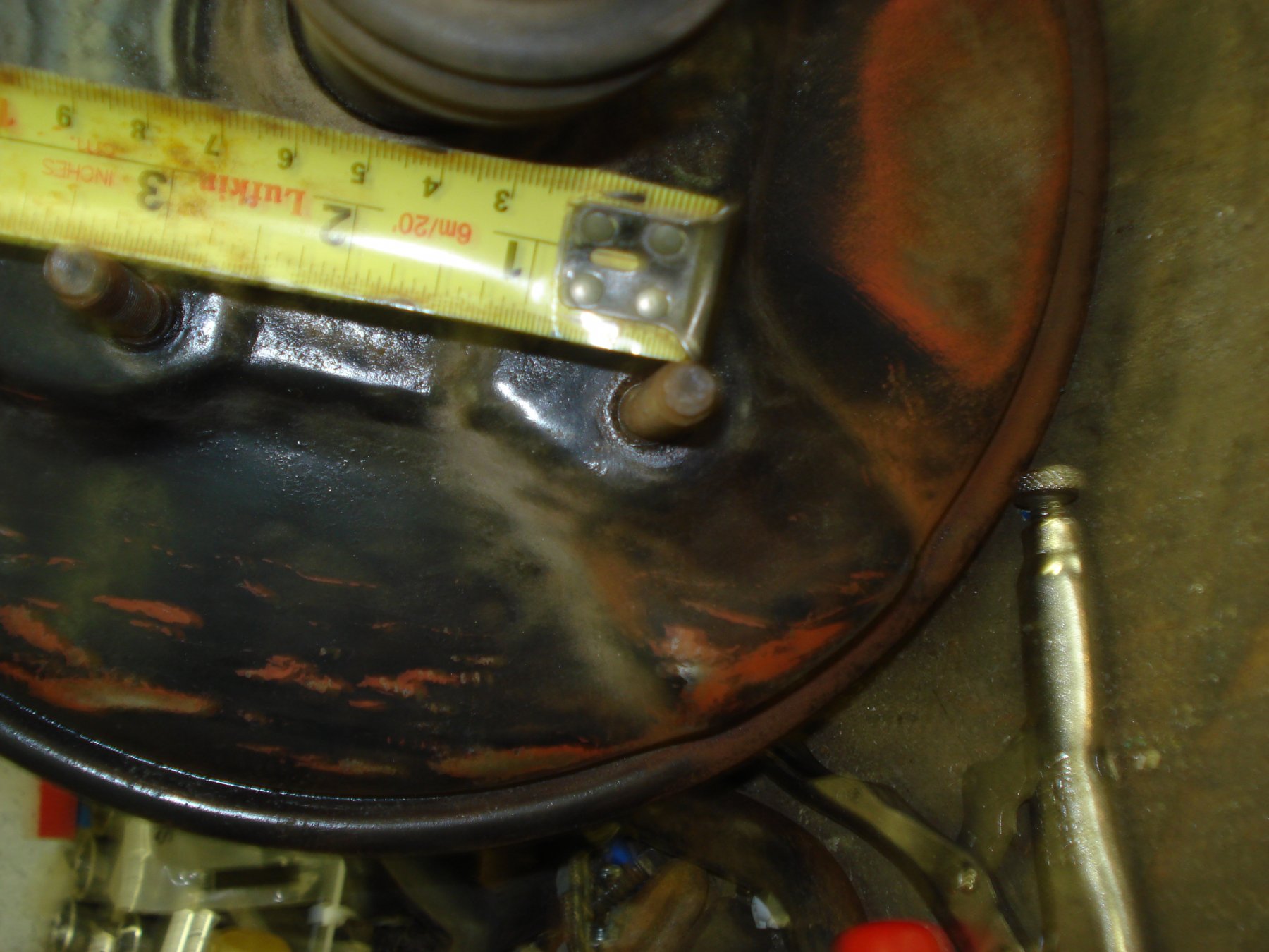

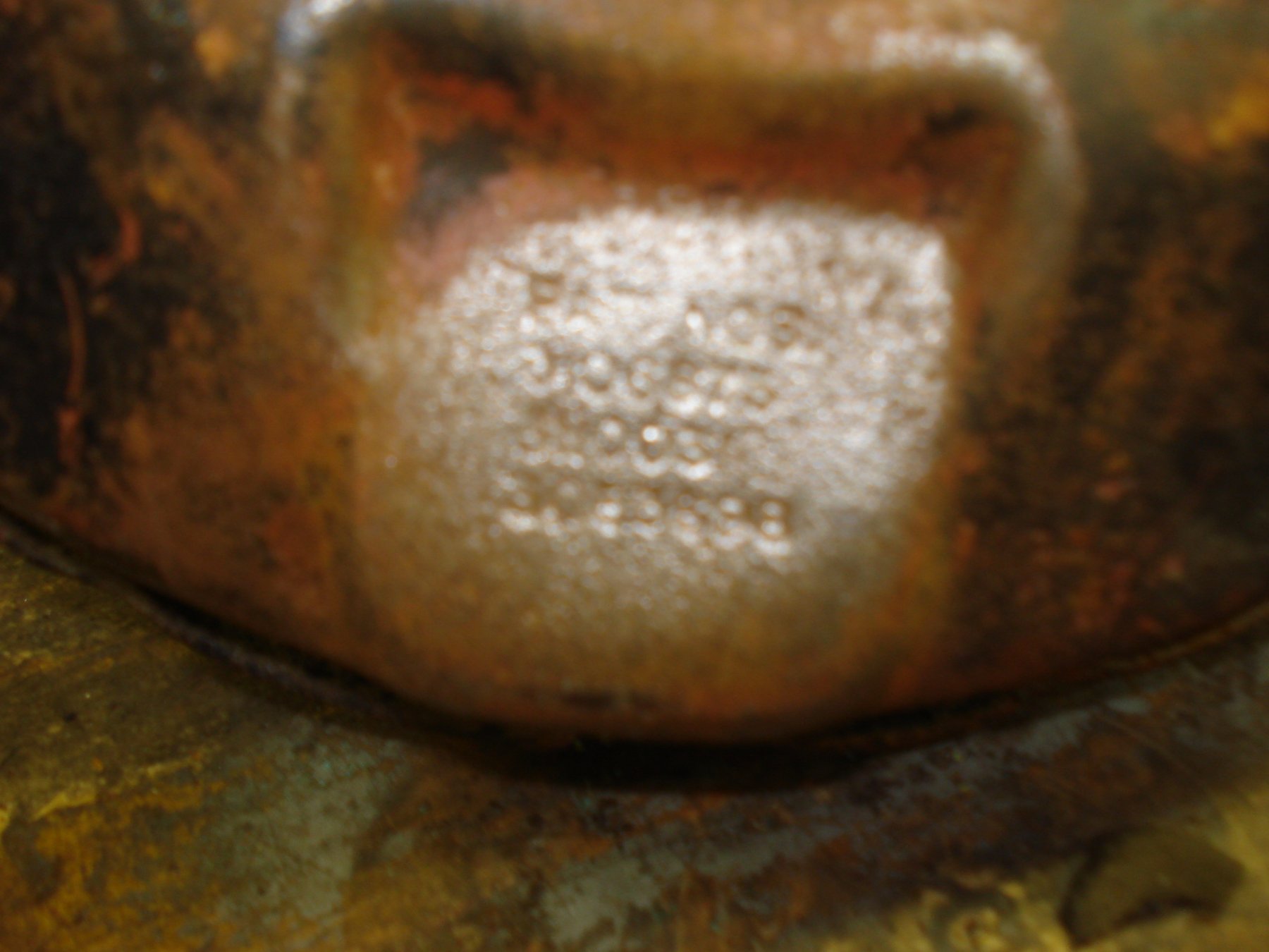

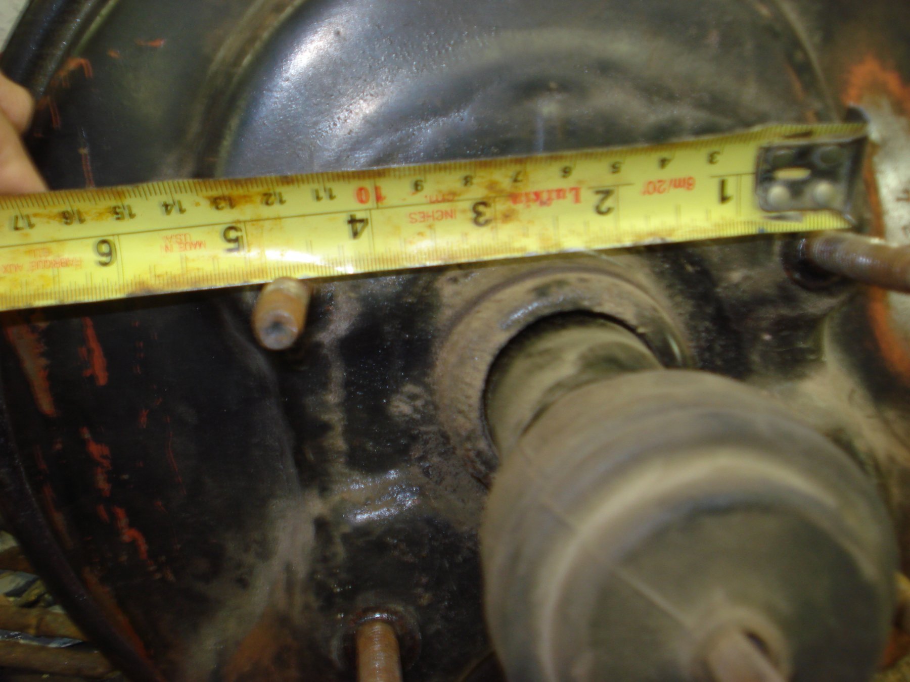

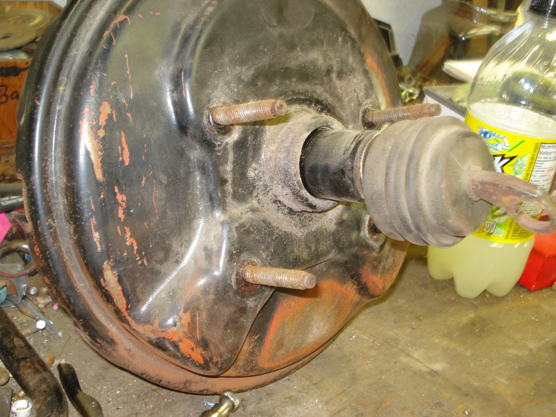

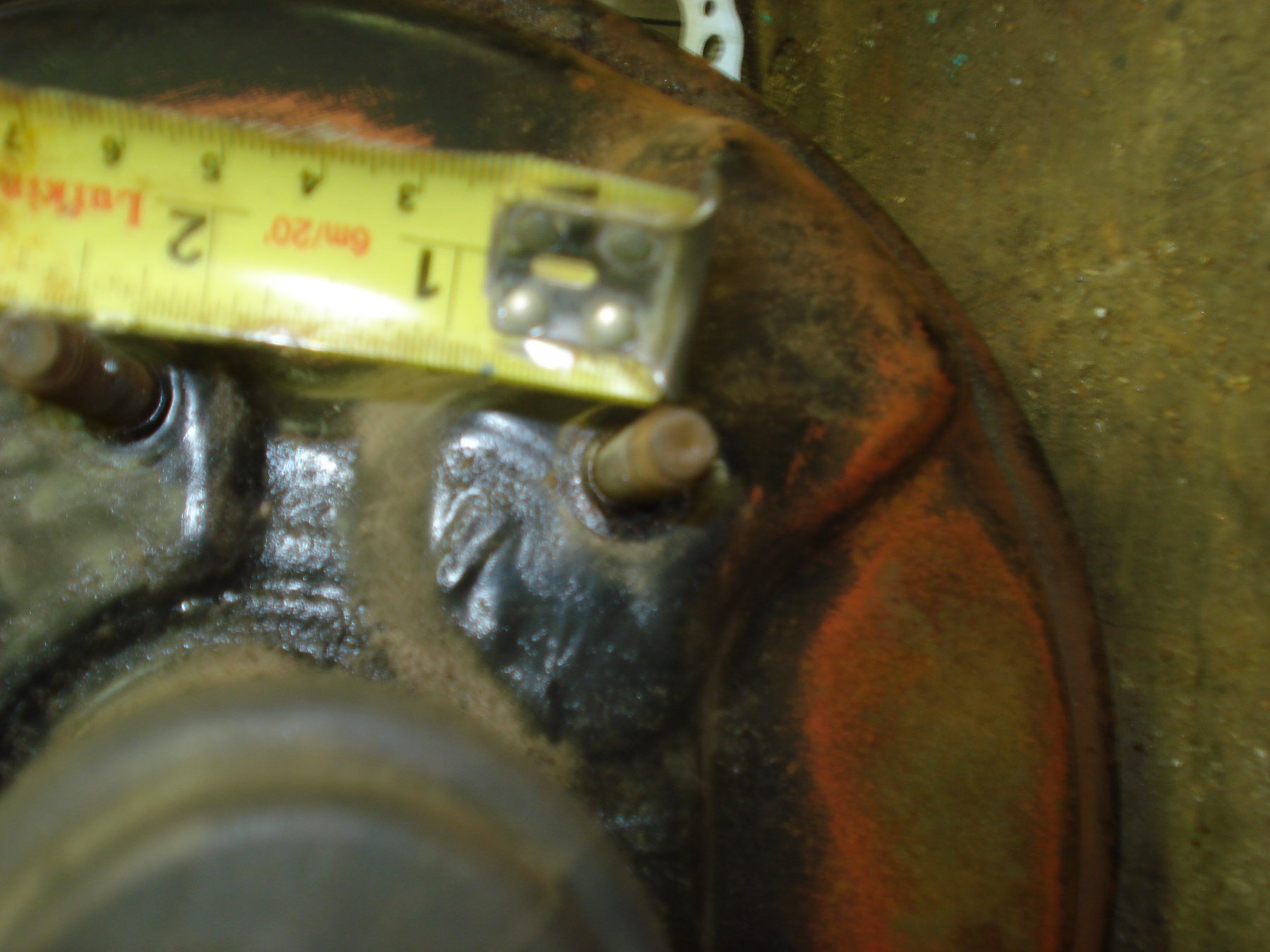

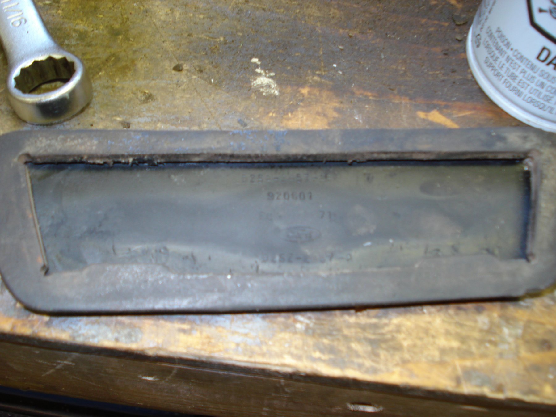

    First, its on my 36, I built it with spare parts not knowing what this was. It has failed, now I need to know what it is, the master is ford, the pedal and pedal pad say ford, but the booster has no markings other than random numbers.

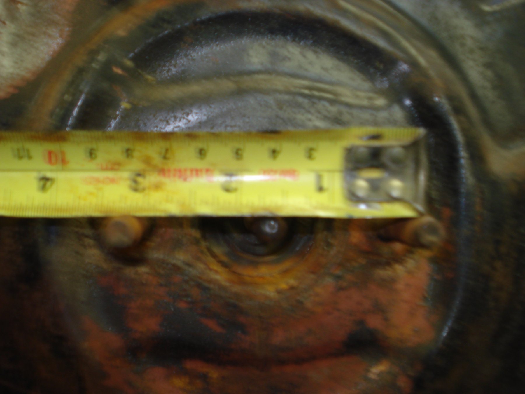

    Diameter is 10.5
    cylinder studs 3 1/8 apart
    front corner # L281A
    middle bottom front J10 6373
    JH 0031
    3063698
    Irregular mounting pattern on the rear.
    Its been on my old dog for 25 years, my 36 ford hoping you guys can help, internet searches haven't been helpful. Thanks, LeRoy. DSC07894.JPG DSC07895.JPG DSC07896.JPG DSC07897.JPG DSC07898.JPG DSC07899.JPG DSC07900.JPG DSC07901.JPG DSC07902.JPG DSC07903.JPG DSC07904.JPG DSC07905.JPG DSC07906.JPG DSC07907.JPG DSC07908.JPG DSC07909.JPG DSC07910.JPG DSC07911.JPG DSC07912.JPG

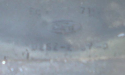

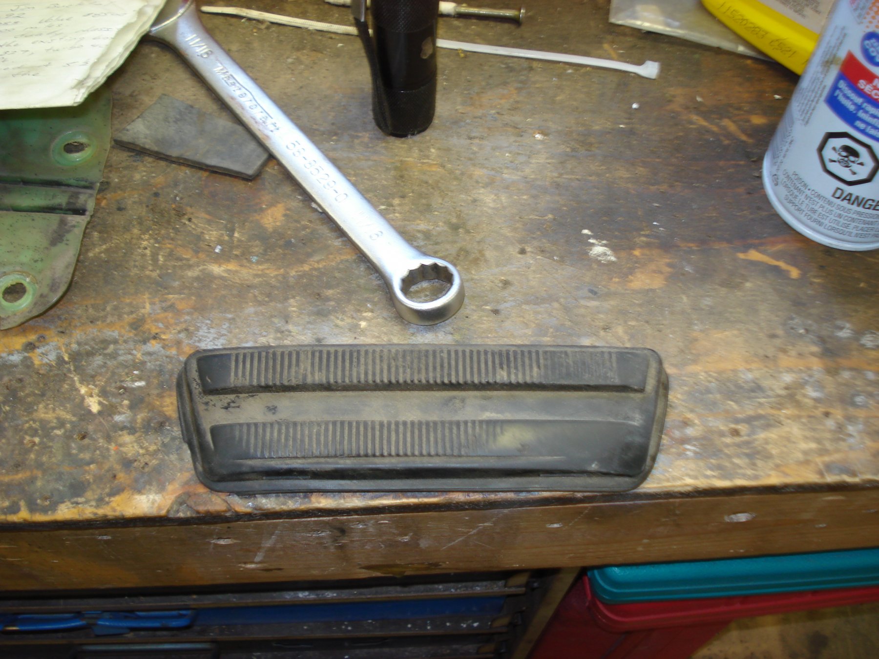

    what does this say? back of the pedal pad. it looks like D2SZ?
    D2S means 72 Tbird
    pprather, Hnstray and VANDENPLAS like this.
  3. squirrel
    Joined: Sep 23, 2004
    Posts: 59,874
    squirrel
    looks like it might be that...
    catdad49, anthony myrick and Hnstray like this.
  4. lostone
    Joined: Oct 13, 2013
    Posts: 3,571
    lostone
    from kansas
    My gosh! Squirrel remind me to never play trivia games with you!!
    I'd say you nailed it !!

  5. squirrel
    Posts: 59,874
    squirrel
    heh...it's easy if they give you enough clues!

  7. trollst
    Joined: Jan 27, 2012
    Posts: 2,104
    trollst
    So squirrel......if I can get to bonneville this year, IF they open the borders, I'm gonna run my 36 over to your place, and give you the biggest, beardiest, ugly wet kiss right on the lips.....I just need your address.
    Thanks man, LeRoy.
