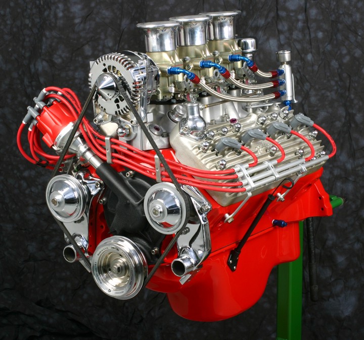

    A few years back Mike Mavrigian did a series of articles in Shop Magazine on building a flathead (8BA) and one whole chapter was on mounting an alternator on a 3-2 setup - I think with an SU-349 Edelbrock manifold. It was chapter 6 of the series. He used a Tuff Stuff 7781 alternator. I just finished an install on a 59AB using the same style alternator. Pic is of Mike's flatty.

    Demon carbs ( a little bigger than a 97) and the article shows how he built the bracket.
