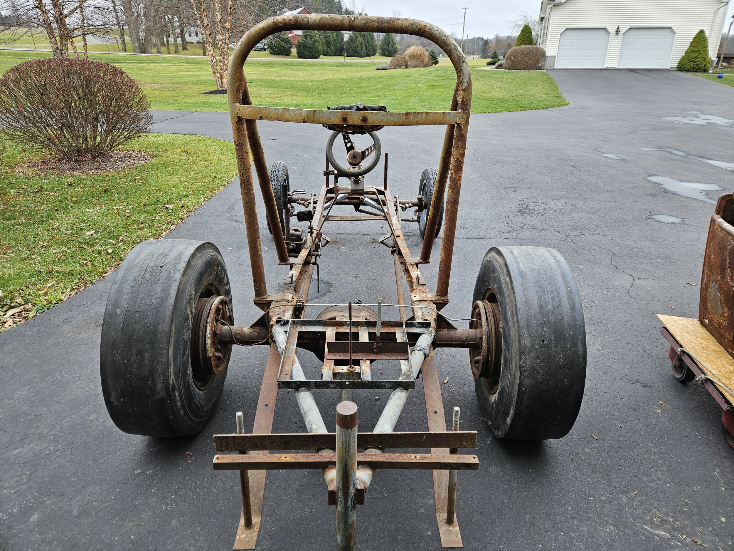

    I've decided it's time to start the resurrection of this altered I picked up a couple years ago as a retirement present to myself.
    I picked this up in eastern upstate NY but have no knowledge of it's history. I'm ***uming it's a late 50's, early 60's build. It uses c-channel frame rails that I haven't identified as of yet. The body is steel with the right side door welded shut and the turtle deck is fibergl***. It has a tri-5 Chevy rearend rigidly mounted to the frame. It appears to have been a relatively nice car in it's day as the complete front suspension and steering was chromed and there is evidence of two different metal flake paint jobs.
    The intention is to restore/rebuild with some additional ch***is strengthening but no major changes to the original build. I intend to make the engine/transmission mounts so that they will accommodate both a small block Chevy and a flathead Ford using 2nd and 3rd gear of a three speed trans in both cases.

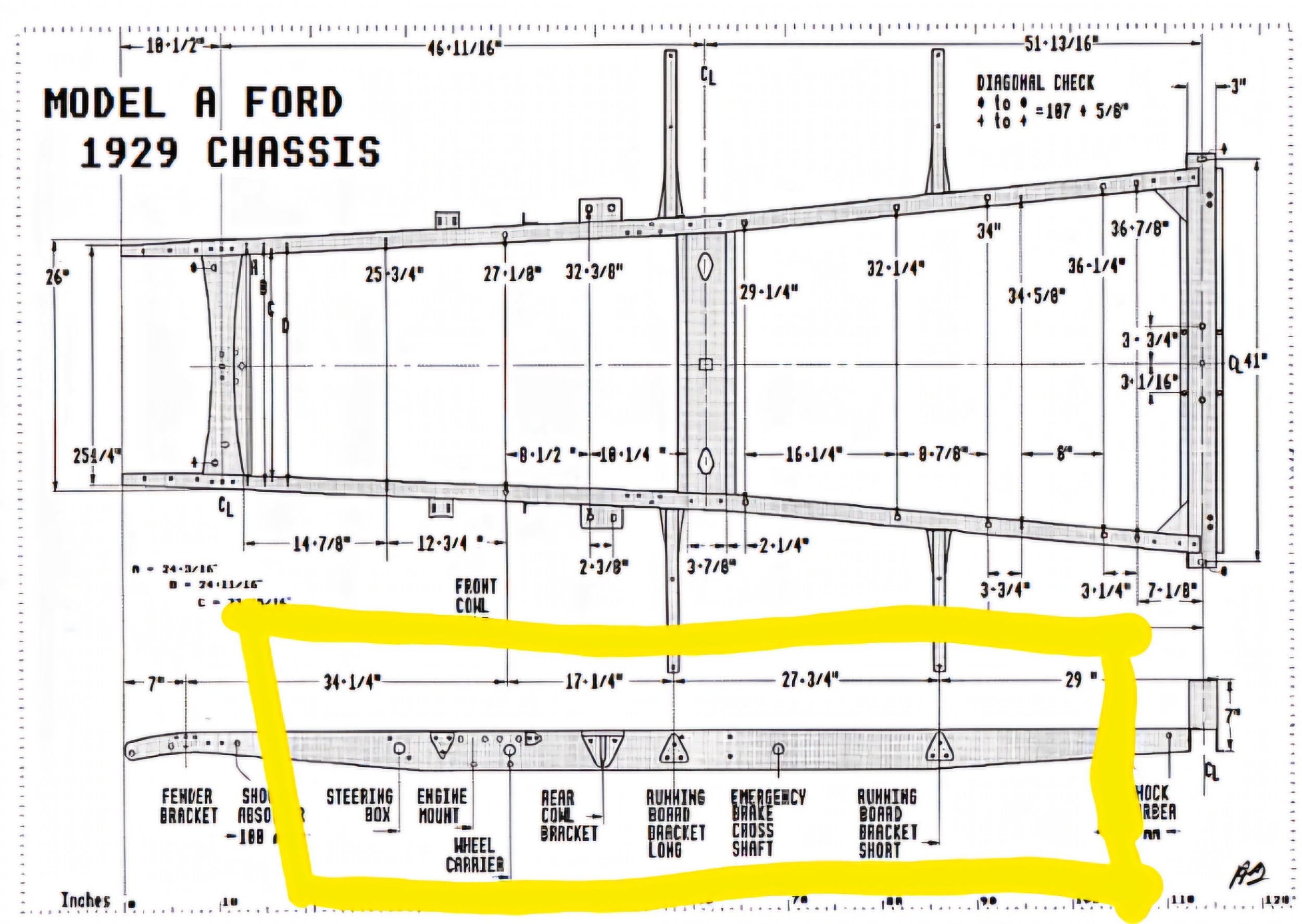

  6. porkshop
    Joined: Jan 22, 2004
    Posts: 1,988
    porkshop
    from Clovis Ca
    looks to have used Model A frame rails...?

  7. whiteknuckle
    Joined: Feb 6, 2007
    Posts: 173
    whiteknuckle
    from Dryden, NY
    That was my original thought, but I seem to recall the model A frame having a slightly raised boss around the 3 holes behind the steering box hole.

  8. whiteknuckle
    Joined: Feb 6, 2007
    Posts: 173
    whiteknuckle
    from Dryden, NY
    It has a slight taper on the bottom of the rail in front of the rear end. The frame is cut off behind the rigidly mounted rear end. I guess there is potential that it is a model A frame shortened significantly in the front and cut off in front of the rear cross member. When the body comes off it should be much clearer.
  9. lake_harley
    Joined: Jun 4, 2017
    Posts: 2,615
    lake_harley
    If memory serves. a Model A frame has a flared or dimpled hole for the E-brake cross shaft.
    Lynn

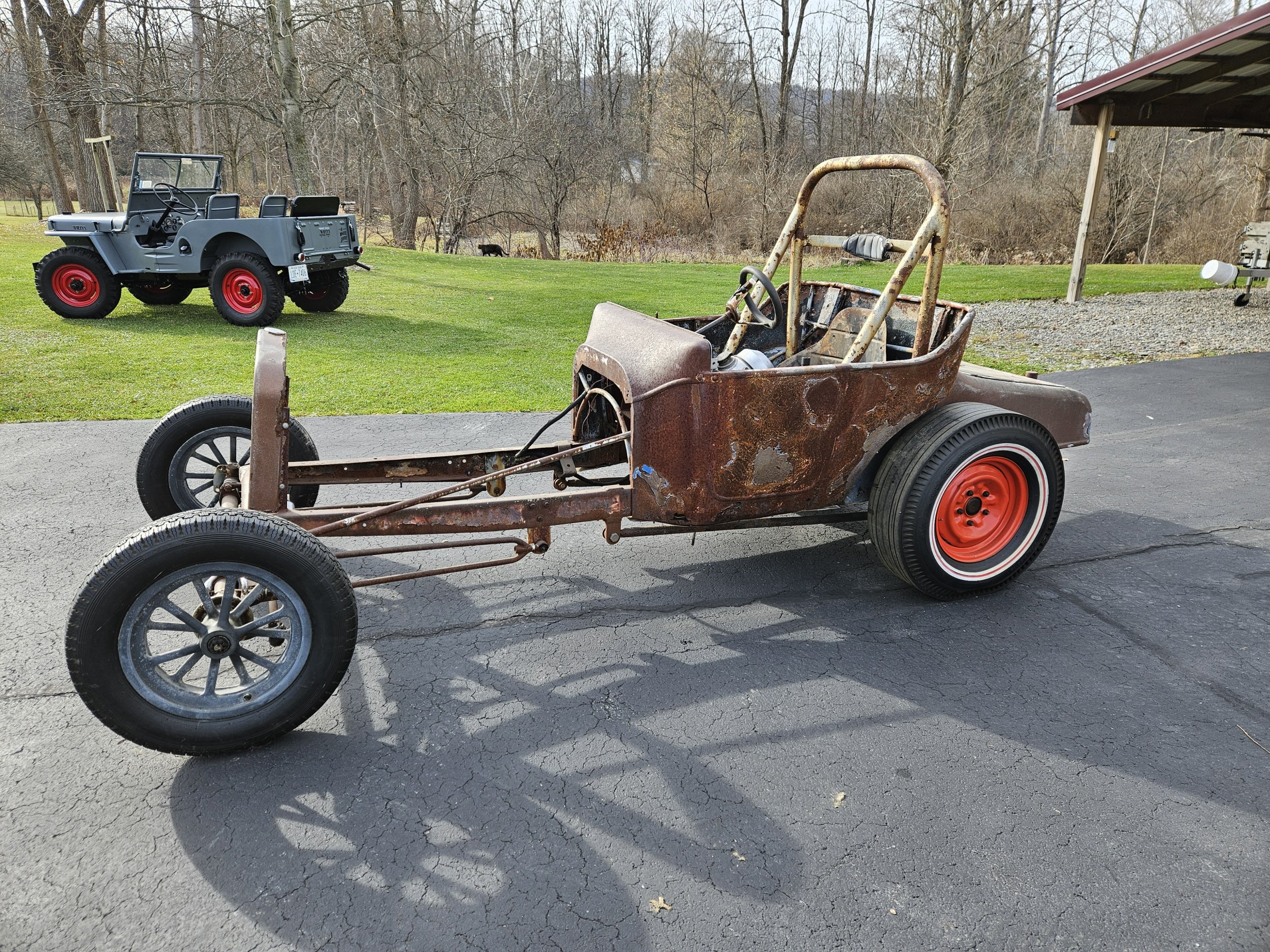

  15. whiteknuckle
    Joined: Feb 6, 2007
    Posts: 173
    whiteknuckle
    from Dryden, NY
    Accomplished a little deconstruction. A little crude, but I'm sure it was effective.

    i have built a few of these. a bit of advice. box the frame. these things twist a bit. put a real roll cage in it. once you get it running you will be surprised how much you will want to drive it. remove that water pipe push bar and take off those wheelie wheel thing a jij. no track is going to let you drag that metal on their strip. that rear is going to be ok with a flathead but according to how the chevy is built it won't hold up. i drive a '32 bantam altered with a flathead and it is slow but fun.

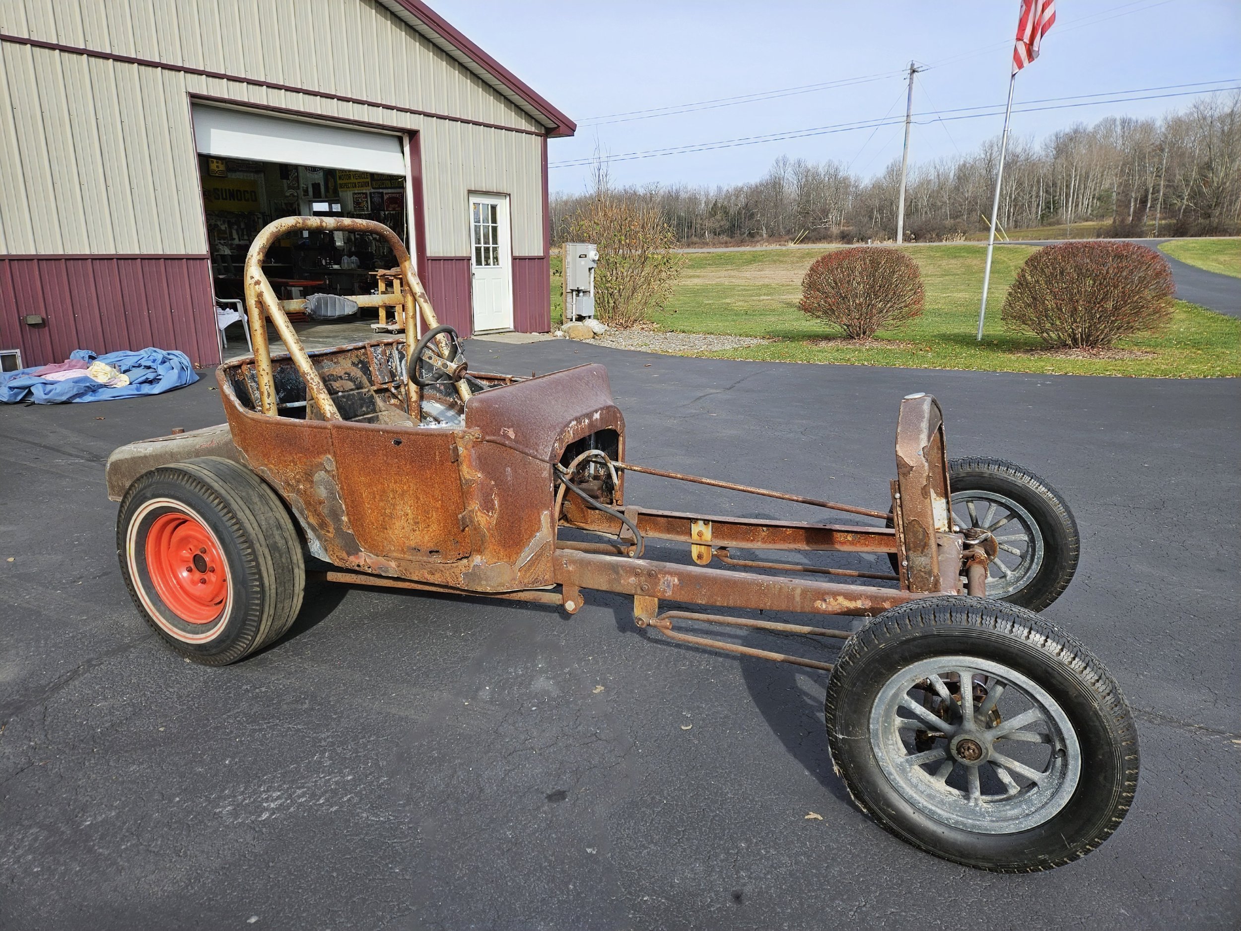

  18. whiteknuckle
    Joined: Feb 6, 2007
    Posts: 173
    whiteknuckle
    from Dryden, NY
    Needed a little help to pull the body off since both my shoulders are shot.
    Bottom 6" of the body is pretty tender and the ch***is will need plenty of cleaning up and stiffening.
    Looks like model A frame rails until about a foot in front of the rear axle and then they're grafted onto something else where the rear housing is welded on. 20241120_112424.jpg 20241120_112443.jpg 20241120_115138.jpg 20241120_115205.jpg 20241120_115214.jpg 20241120_115224.jpg

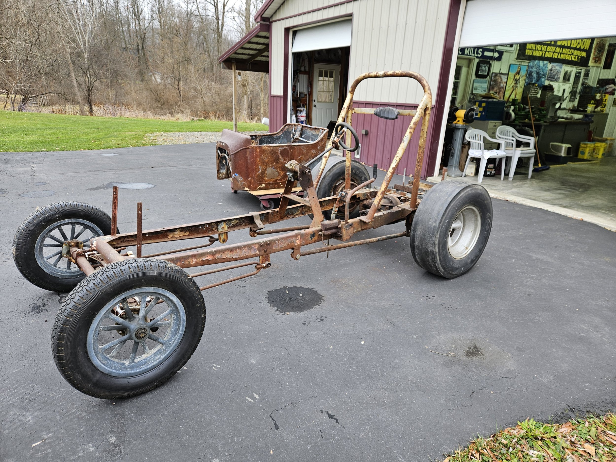

  24. whiteknuckle
    Joined: Feb 6, 2007
    Posts: 173
    whiteknuckle
    from Dryden, NY
    Finished dis***embling everything. As generally rusty as things were I was amazed that every cotter pin came out whole and I was able to spin off every nut. Cut the welds on the door so that it could be removed for rust repairs. Hoping the weather breaks soon so that I can get everything dustless blasted to see what I've got to work with. 20241203_120436.jpg 20241203_120448.jpg 20241203_120532.jpg

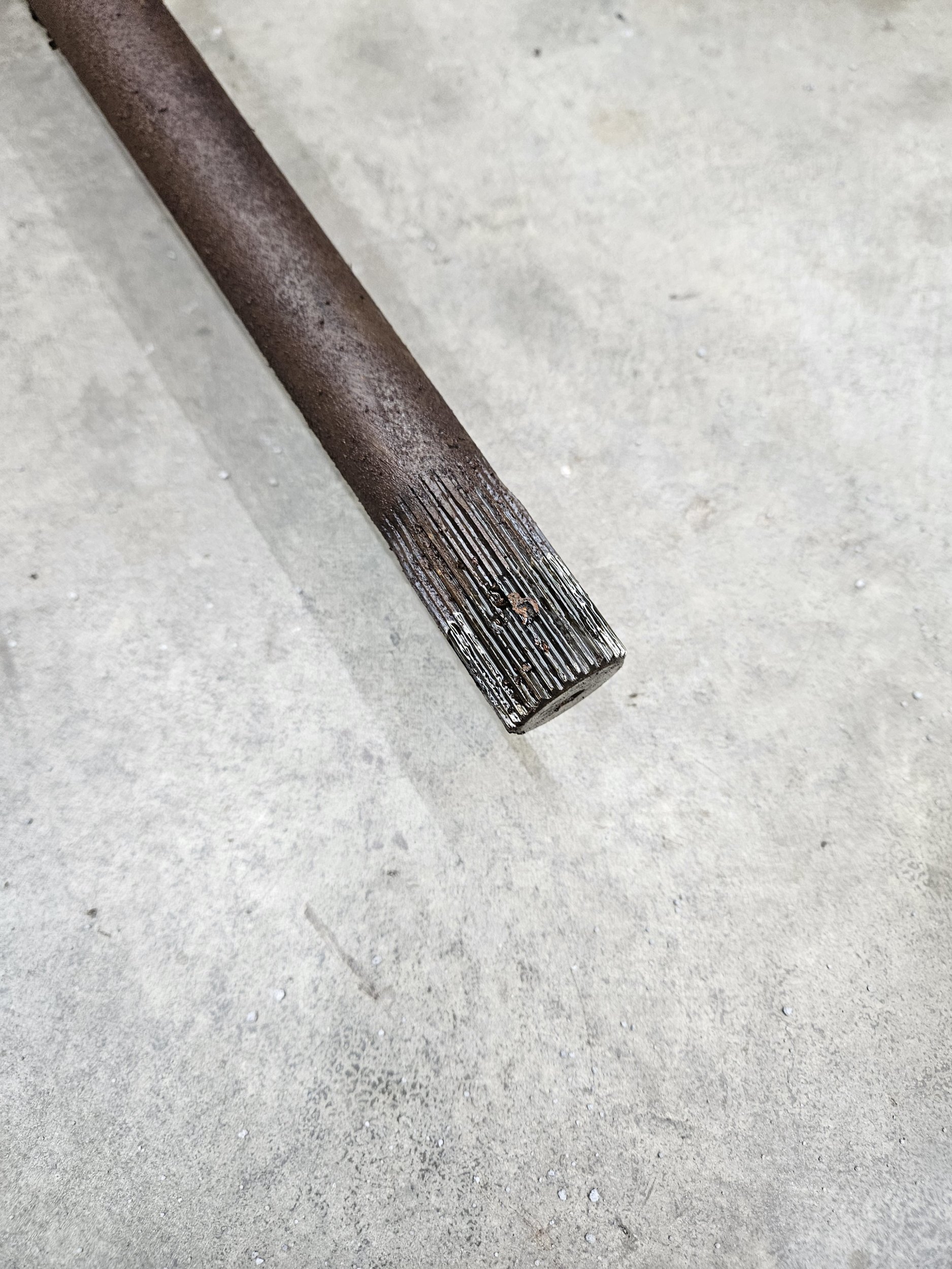

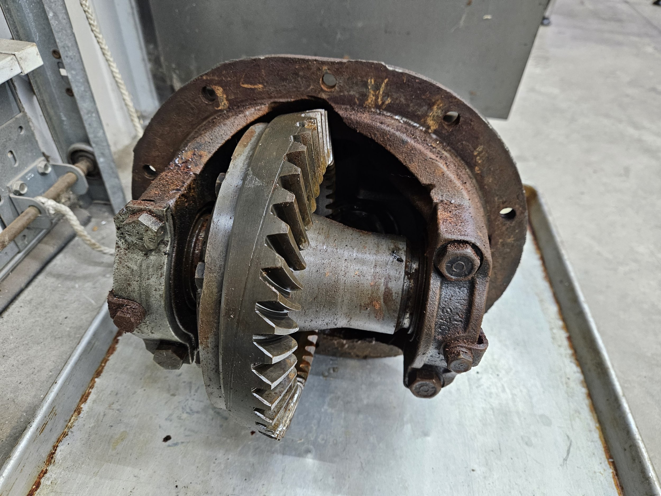

  25. whiteknuckle
    Joined: Feb 6, 2007
    Posts: 173
    whiteknuckle
    from Dryden, NY
    Had a couple comments regarding the strength and suitability of the tri-5 rearend. I was pleasantly surprised to find 30 spline axles, a hefty spool and 5.38 gears. Looks like this will be an 1/8th mile car.

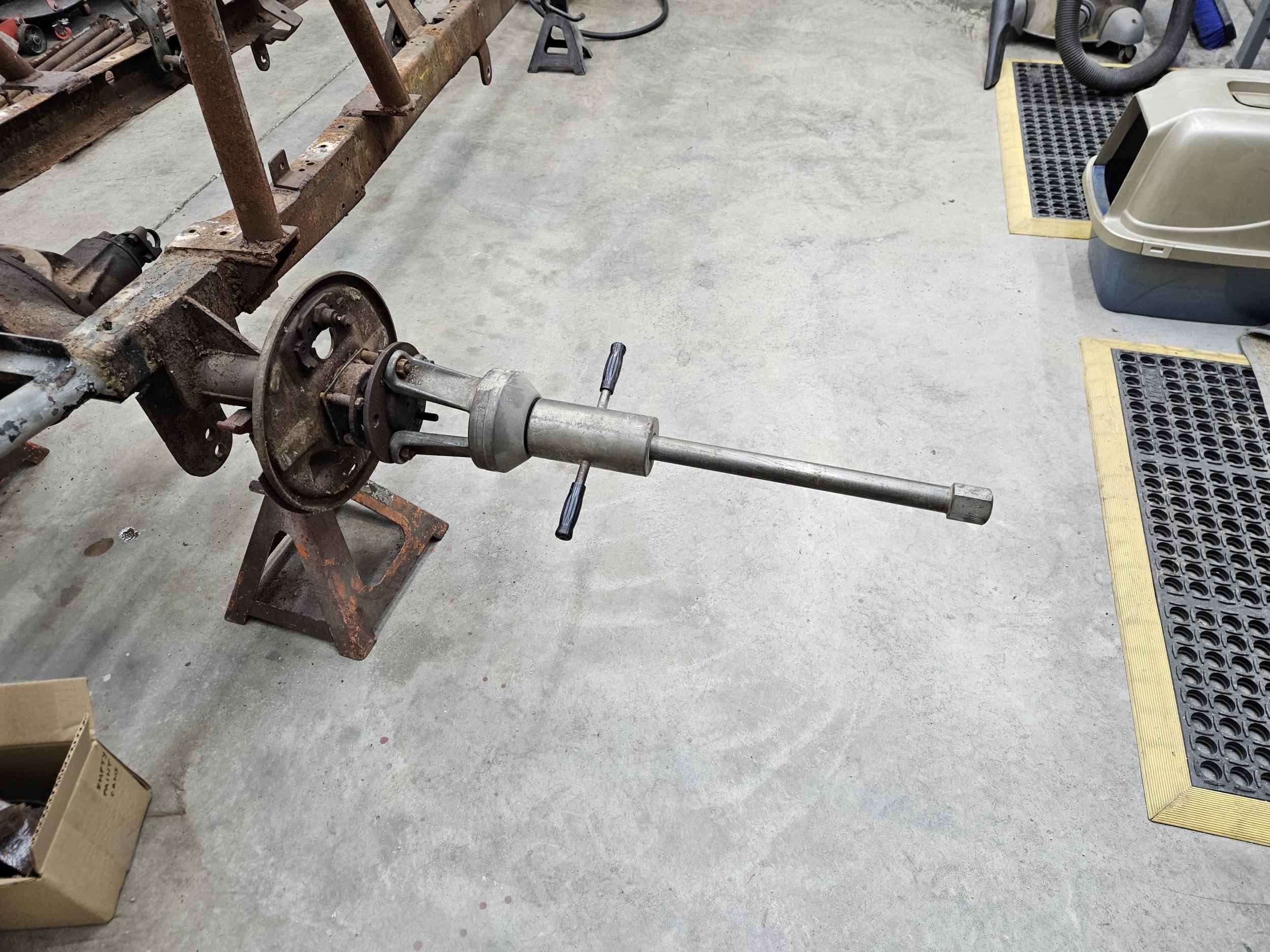

  27. patsurf
    Joined: Jan 18, 2018
    Posts: 3,407
    patsurf
    a REAL puller instead of a chain or backwards drum!!

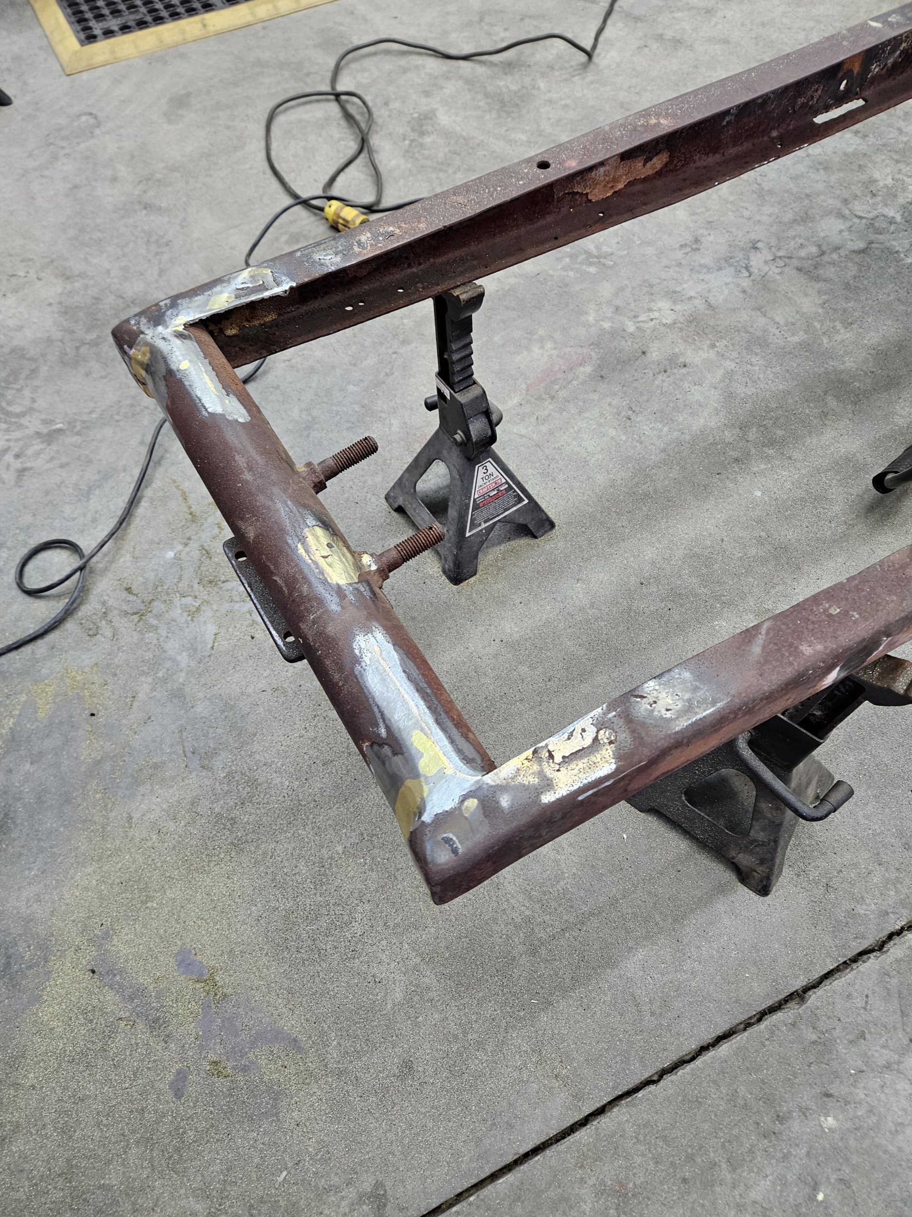

  30. whiteknuckle
    Joined: Feb 6, 2007
    Posts: 173
    whiteknuckle
    from Dryden, NY
    Welded up all the excess holes that this thing has acquired over it's life on the top and side rails of the frame. There are about 30 more on the bottom rails to get welded up next.
    Cut off some of the bracing on the front of the rails that was a little questionable. Also cut off the radiator shell uprights since they were off center. Luckily the br*** was there to clean up and blend the welds that were underneath and wasn't structural.
