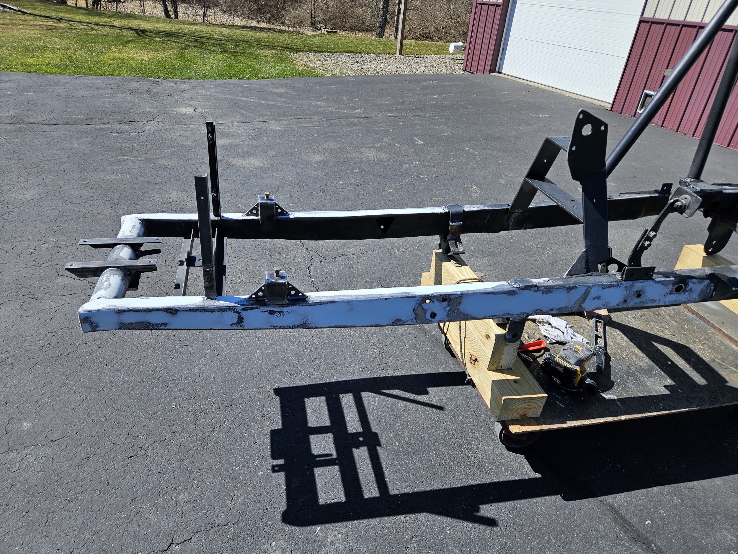

  4. whiteknuckle
    Joined: Feb 6, 2007
    Posts: 173
    whiteknuckle
    from Dryden, NY
    Getting a few things finished up before the ch***is gets fully welded.
    I found a 3 row aluminum radiator for a Volvo application that fits the radiator shell pretty nicely and should allow some flexibility in run time. The bottom has a post for a saddle mount and the shell will retain it from the top. The shell is removed with four bolts to access the cap. It'll require some reducers to make up with the larger engine inlet and outlet.
    Made up some simple mounts to locate the fuel tank centered on the front crossmember.
    20250127_110053.jpg 20250127_110111.jpg 20250127_110453.jpg 20250128_121032.jpg 20250128_121550(0).jpg 20250128_121638.jpg 20250128_121537.jpg

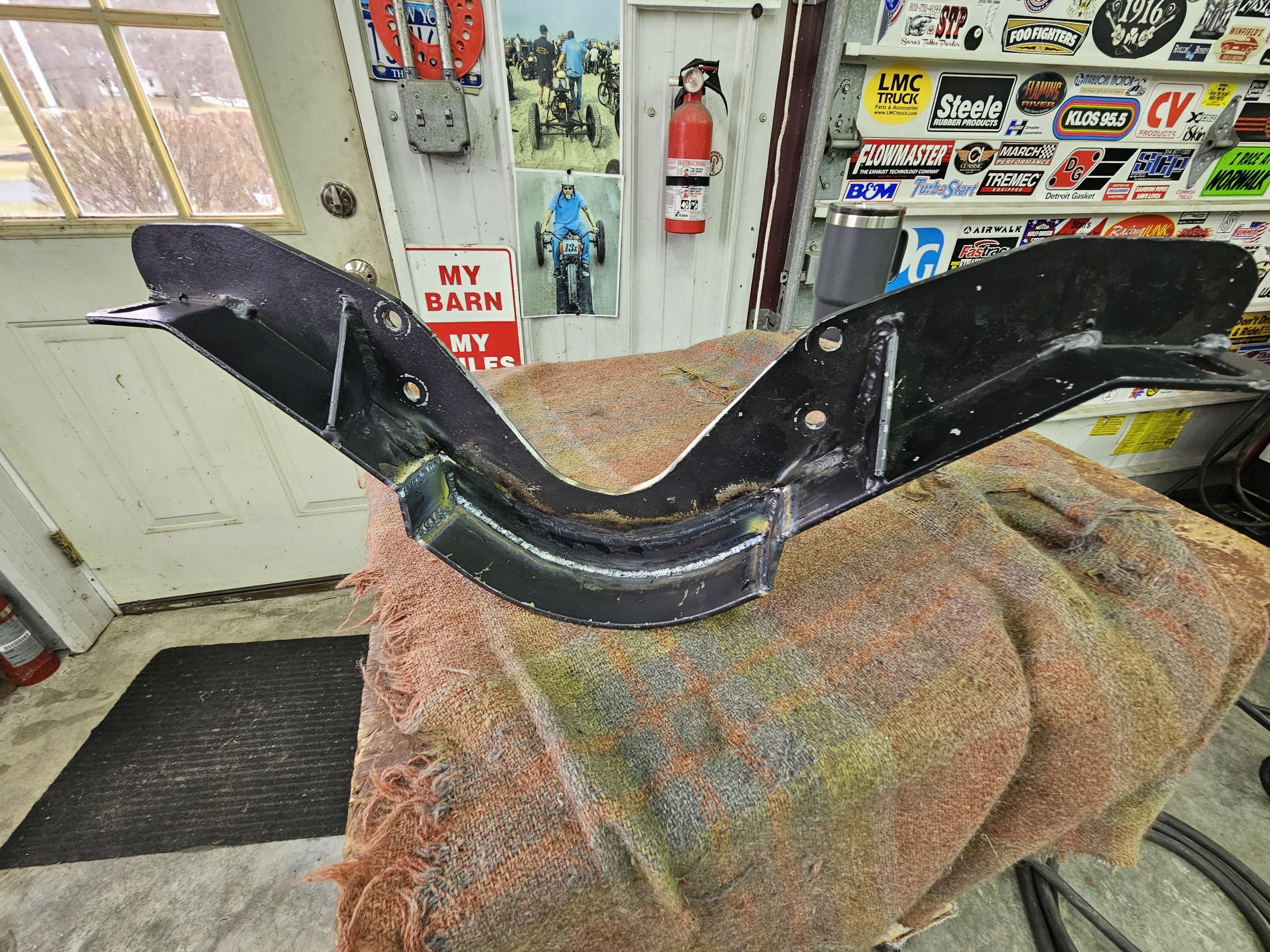

    After blasting, the replacement door needed a little more rust repair than anticipated, but it gave me an opportunity to hammer out a couple more patch panels with curved reveals.
    I transferred the tubing and latch from the original door. The lower hinge that was welded onto the body had been shorted at some point so the pivot was too close to the body and placed the door too far inward to be able to close. Luckily the replacement door came with a full hinge ***embly. The new hinge was relatively easy to locate into the body recess so now I've got a functional door for those of us that aren't quite as nimble as we used to be.

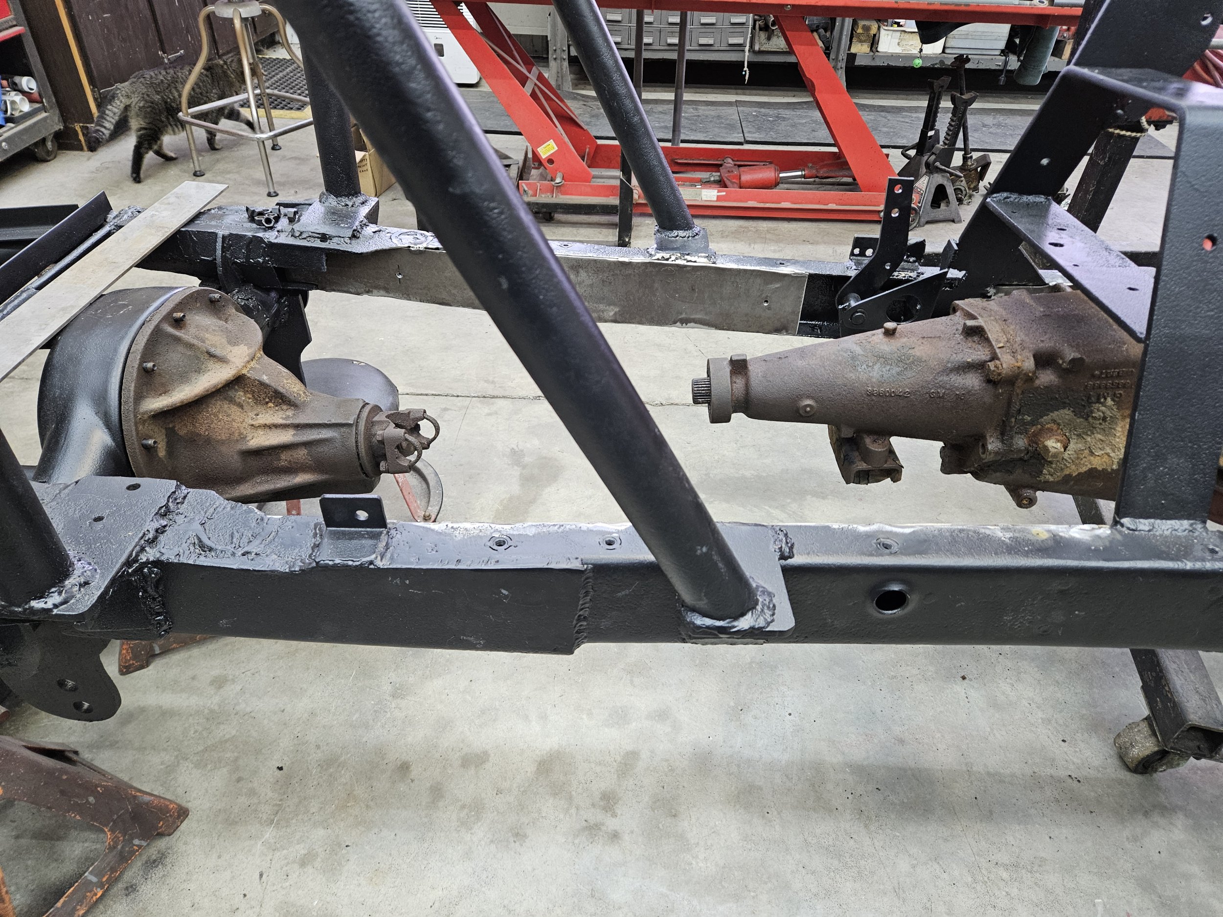

  19. whiteknuckle
    Joined: Feb 6, 2007
    Posts: 173
    whiteknuckle
    from Dryden, NY
    A little of this and a little of that since my last post.

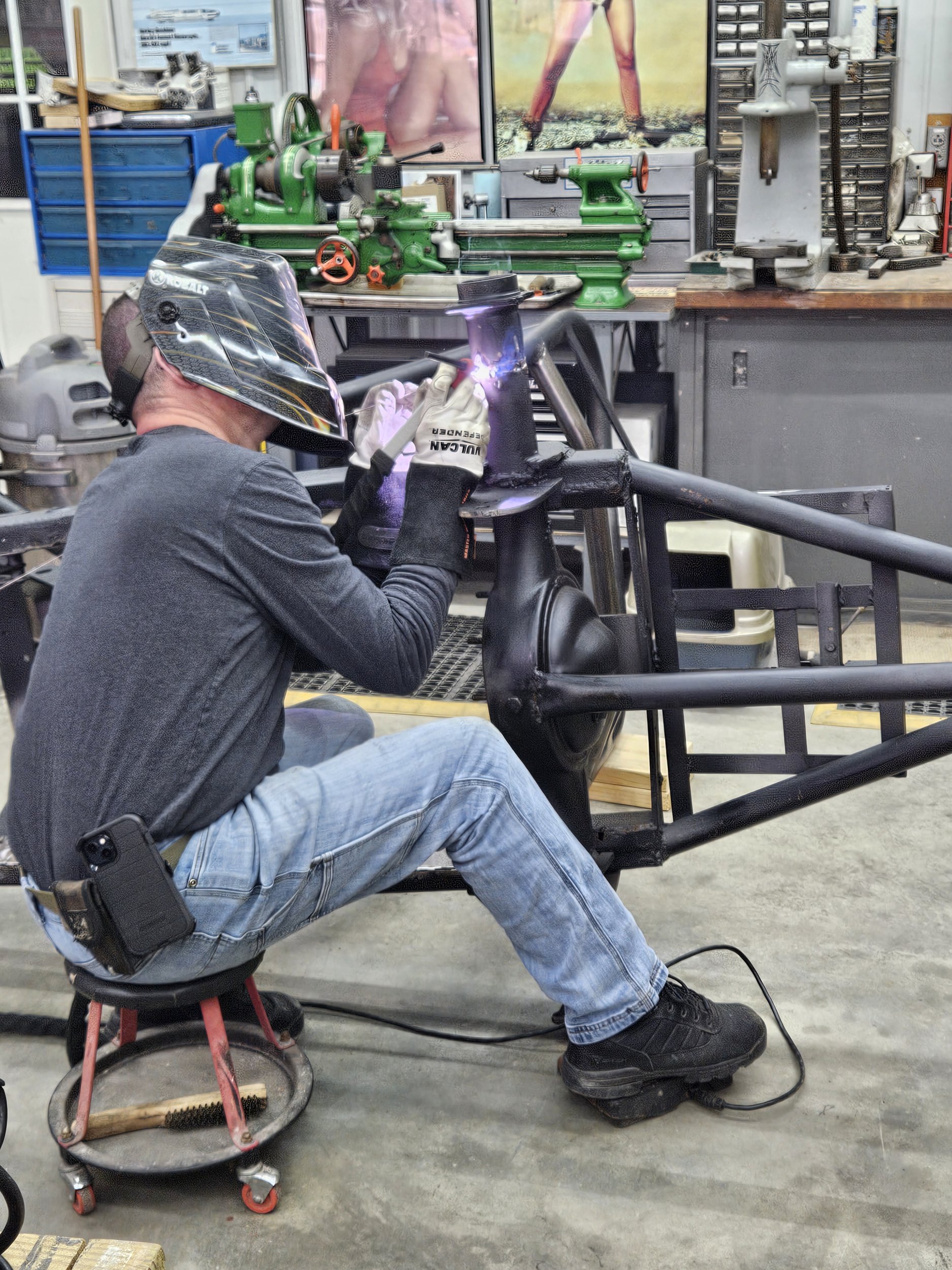

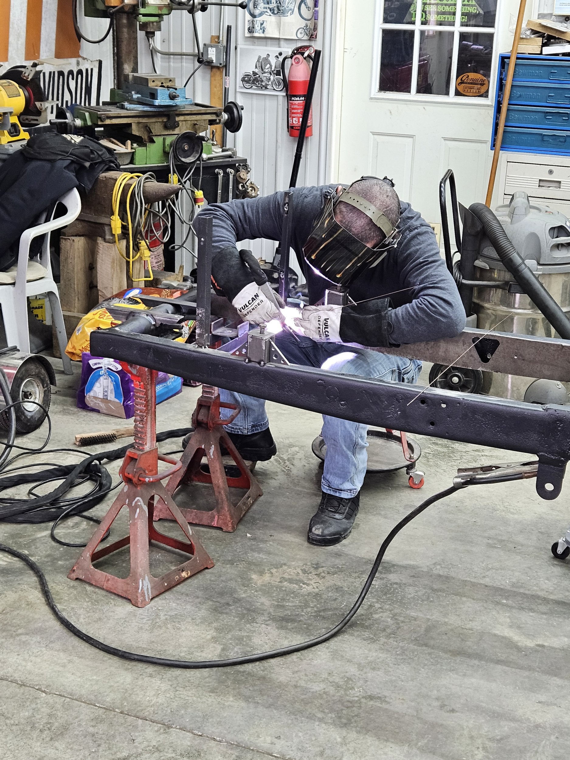

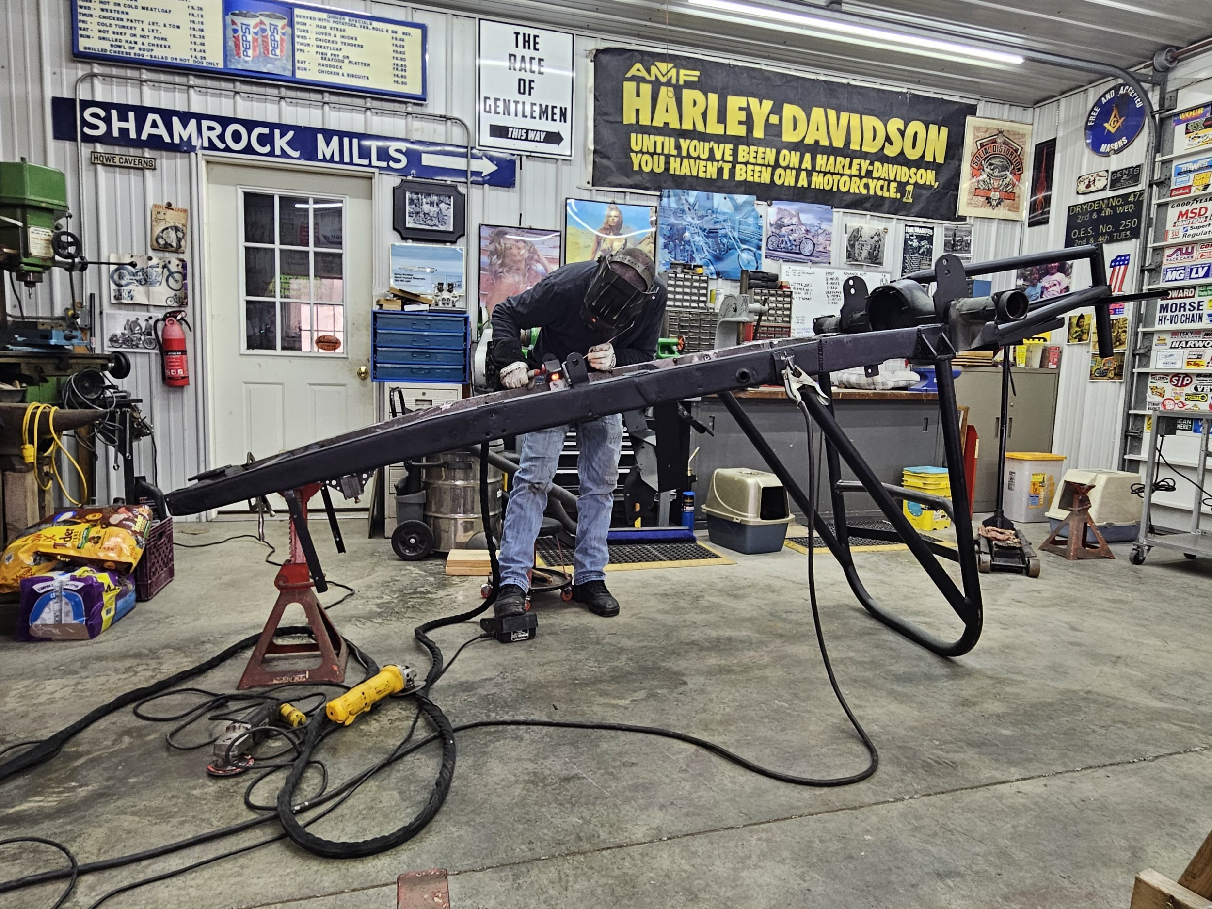

    A friend brought his welder over and we started finish welding the ch***is today. Probably another day and it'll be finished.

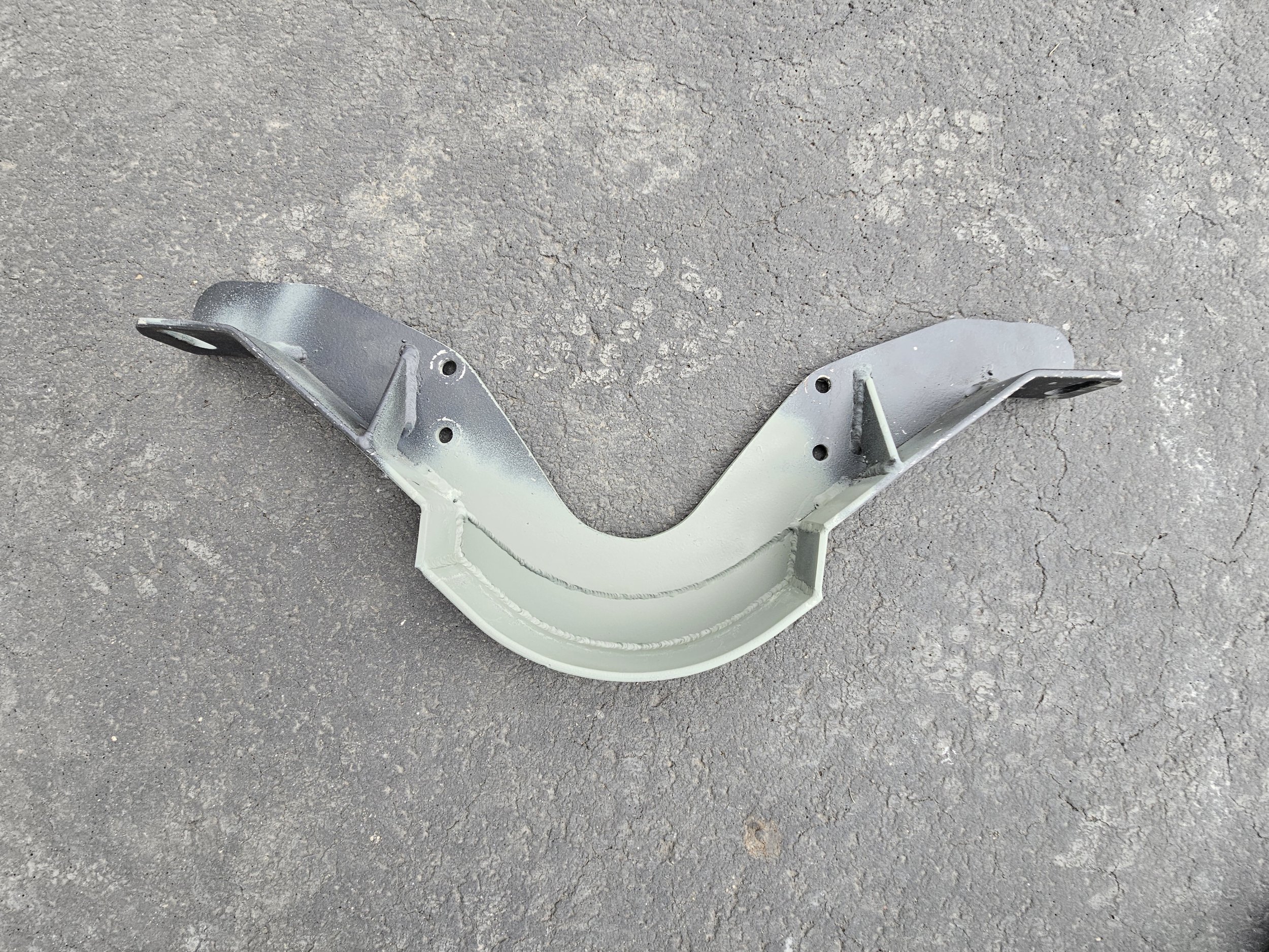

    Had to modify the Hurst front motor mount to accommodate the more modern large crank damper.

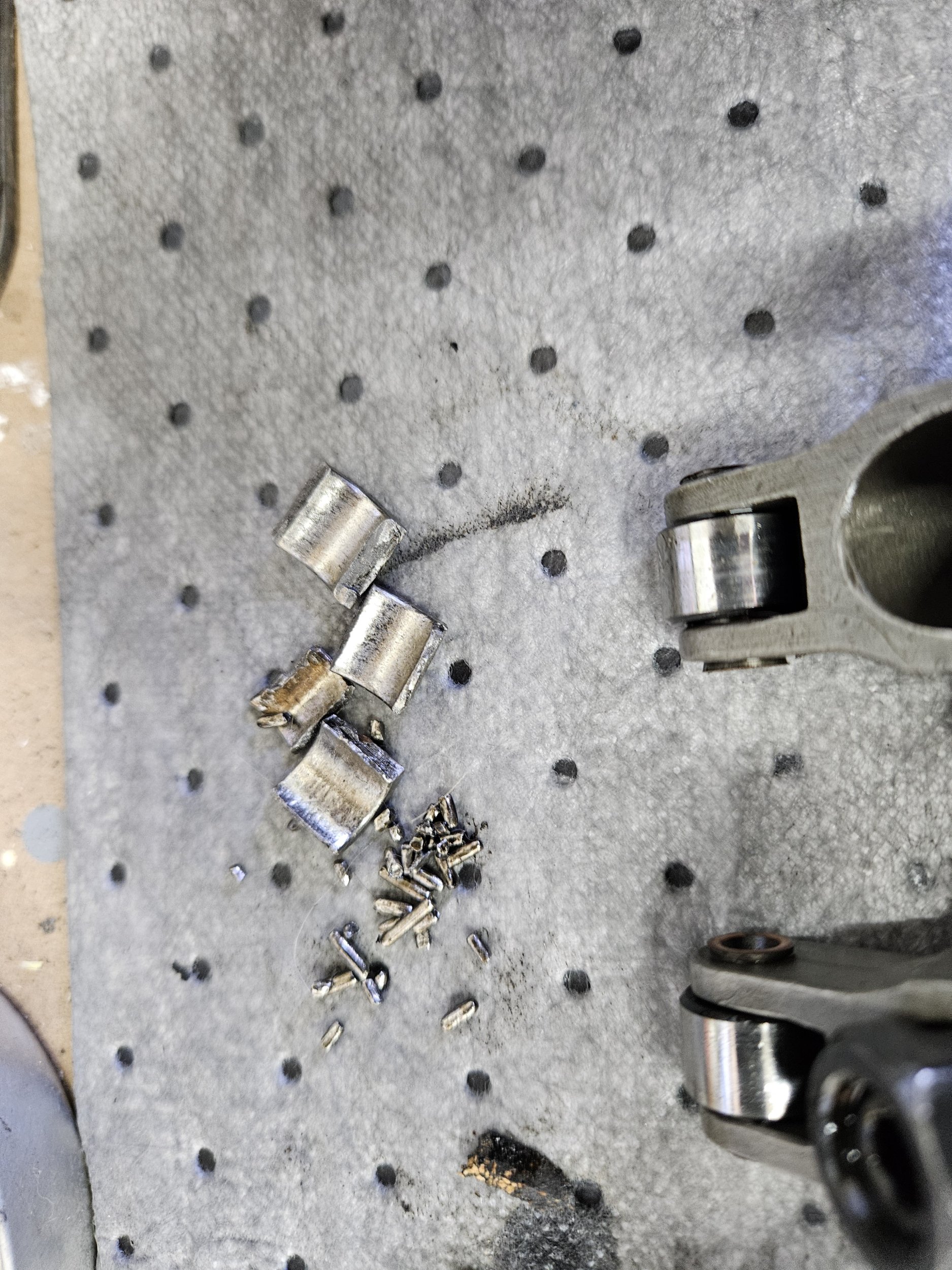

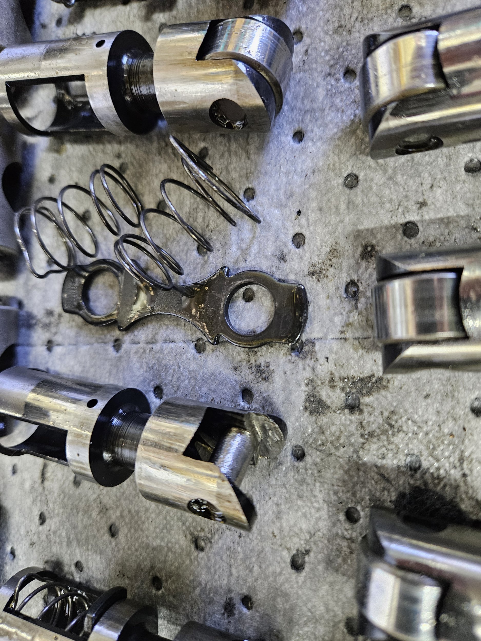

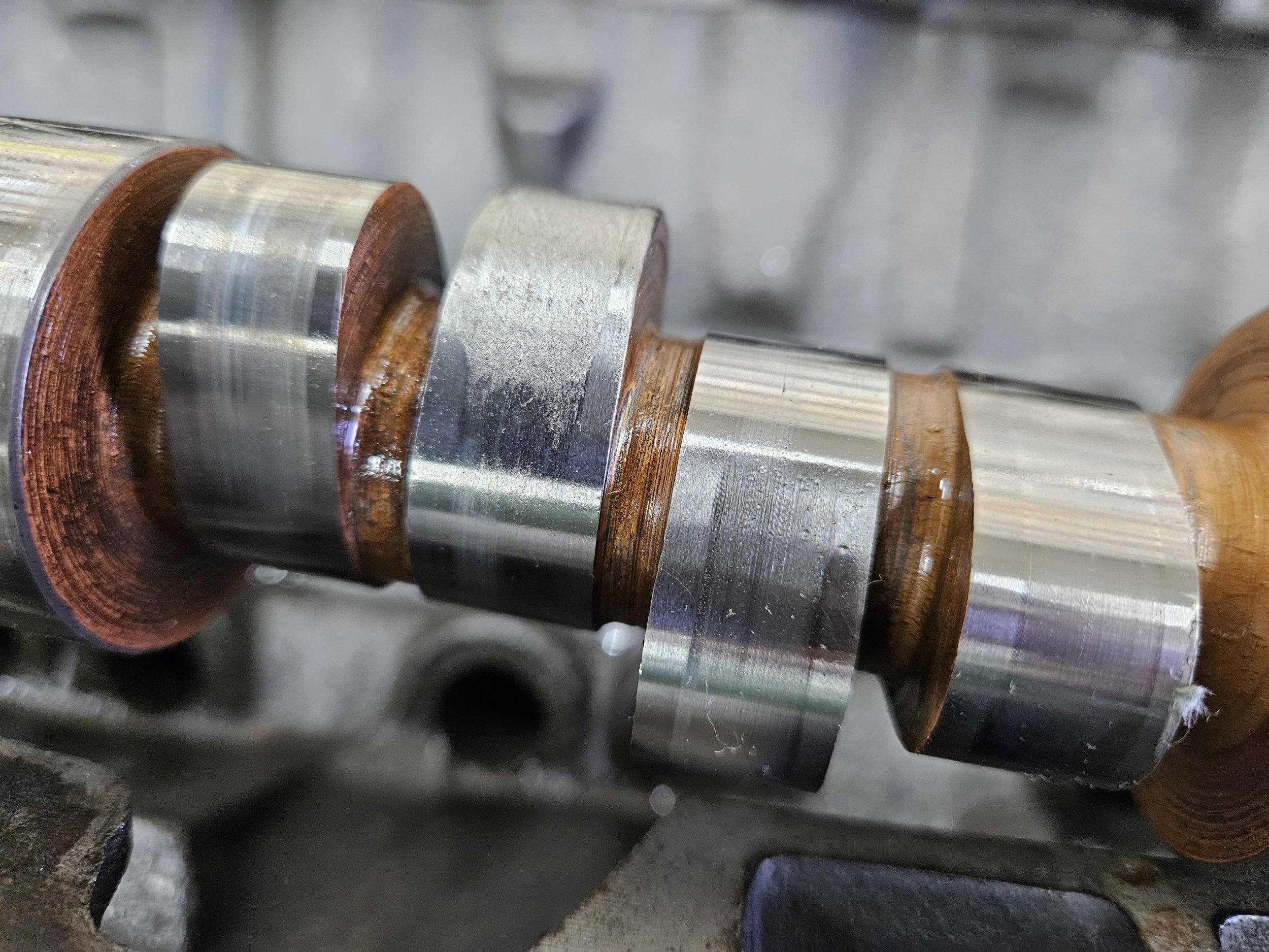

    Pulled an engine out of storage that I previously ran in an off topic Camaro. It had some drag race oiling mods that didn't appreciate long stretches of highway driving with 4.56 gears and I took out a roller lifter and cam lobe. Luckily the bottom end was un****hed so it received new main bearings as long as I was in there. The cam and lifters will be replaced with a marketplace find to keep things low buck. This was a strong motor in a 3000lb Camaro so it'll probably be scary in this thing.

    No one enjoys doing this, do they?

    Schneider cams can fix that camshaft if its otherwise a good cam. there prices are way cheeper then buying a new one.

    My buddy has a cam, lifters and pushrods that I can use, but I'll check that out. Thanks

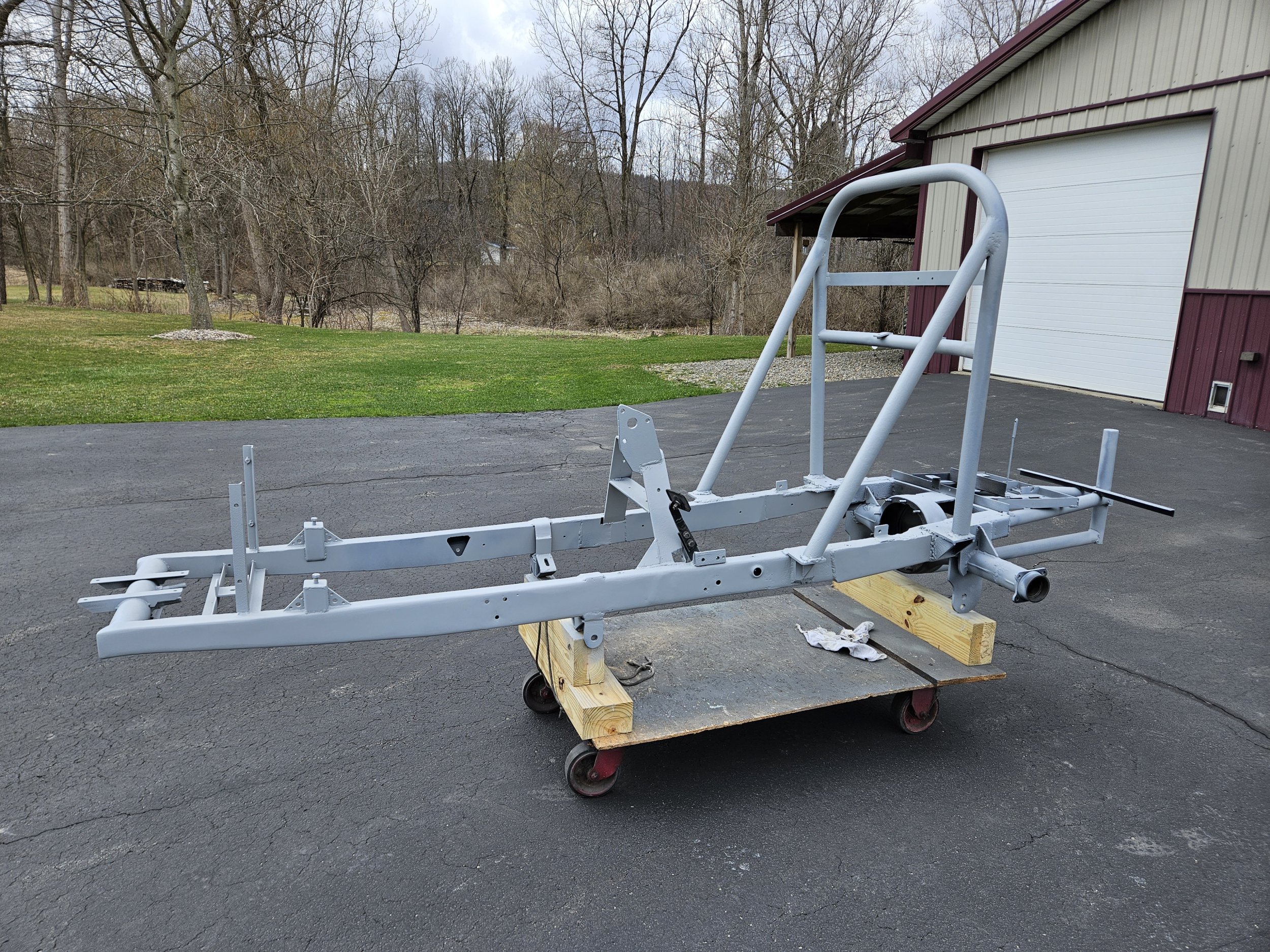

  24. whiteknuckle
    Joined: Feb 6, 2007
    Posts: 173
    whiteknuckle
    from Dryden, NY
    All the ch***is welding is complete and I've started to pretty up at least the visible areas.
    My shop is already enough of a mess so hopefully it warms up quickly so I can do all this dusty work outside.
    AHotRod, Just Gary, mad mikey and 3 others like this.

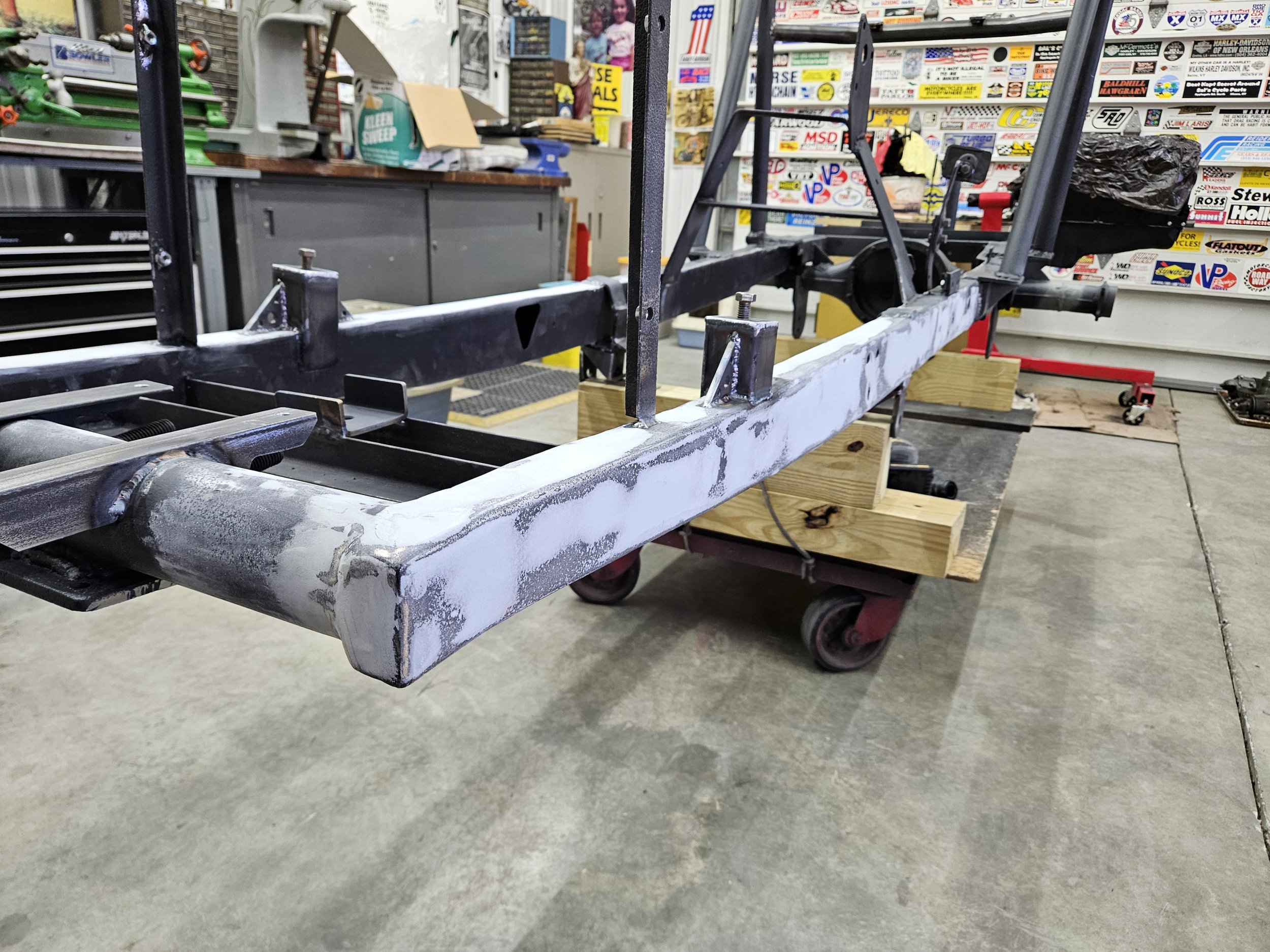

  25. rlsteel
    Joined: Apr 10, 2005
    Posts: 523
    rlsteel
    this was a crowd favorite in 1970 Hughes brothers 23 T 289 4 speed. love your new car RLS
    mad mikey, Church Key and loudbang like this.
  26. whiteknuckle
    Joined: Feb 6, 2007
    Posts: 173
    whiteknuckle
    from Dryden, NY
    Thank goodness for a 70° day where I could work outside. Finished the heavy filling of the ch***is and got everything covered with primer.
    AHotRod, mad mikey, loudbang and 6 others like this.
