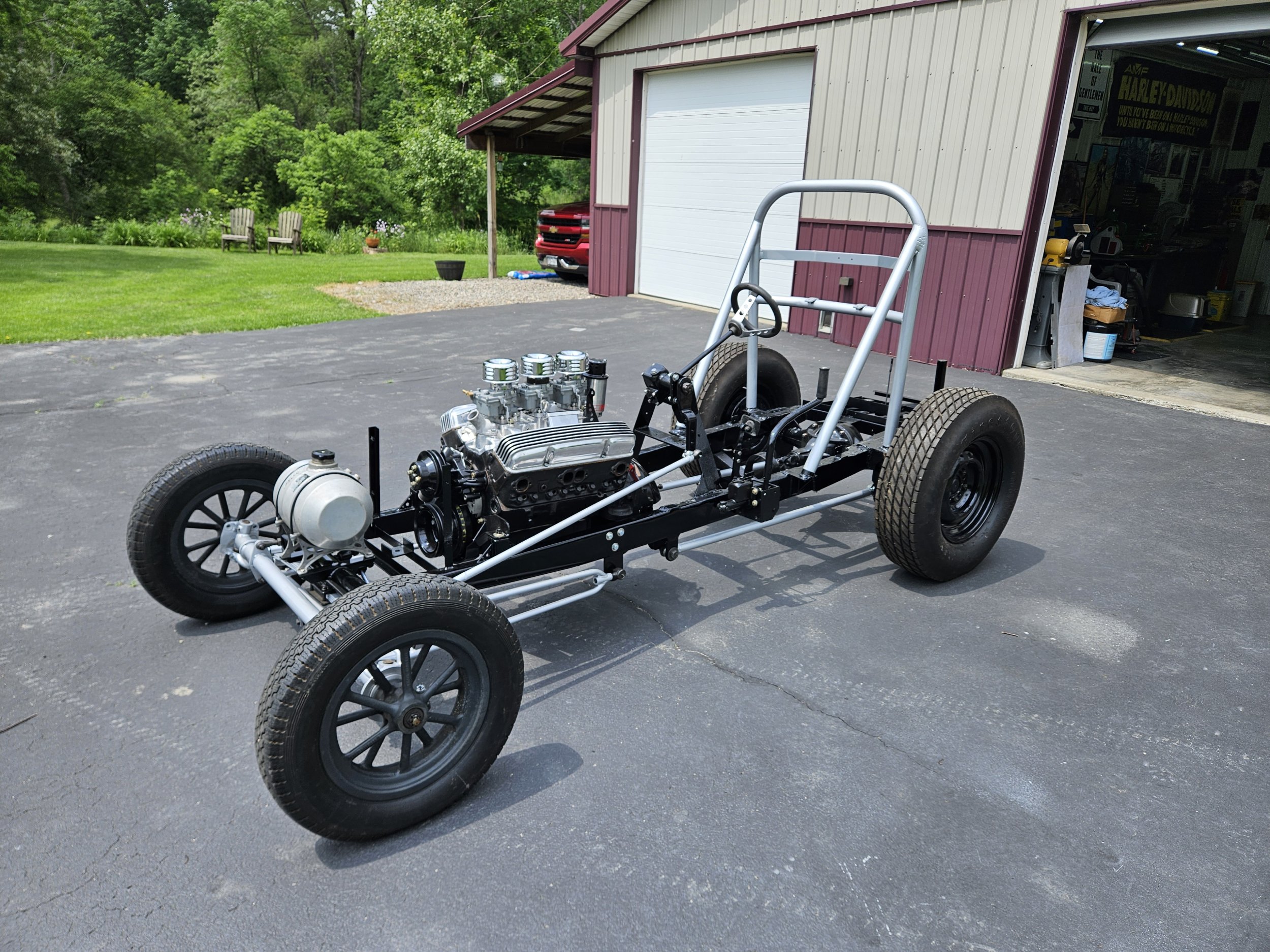

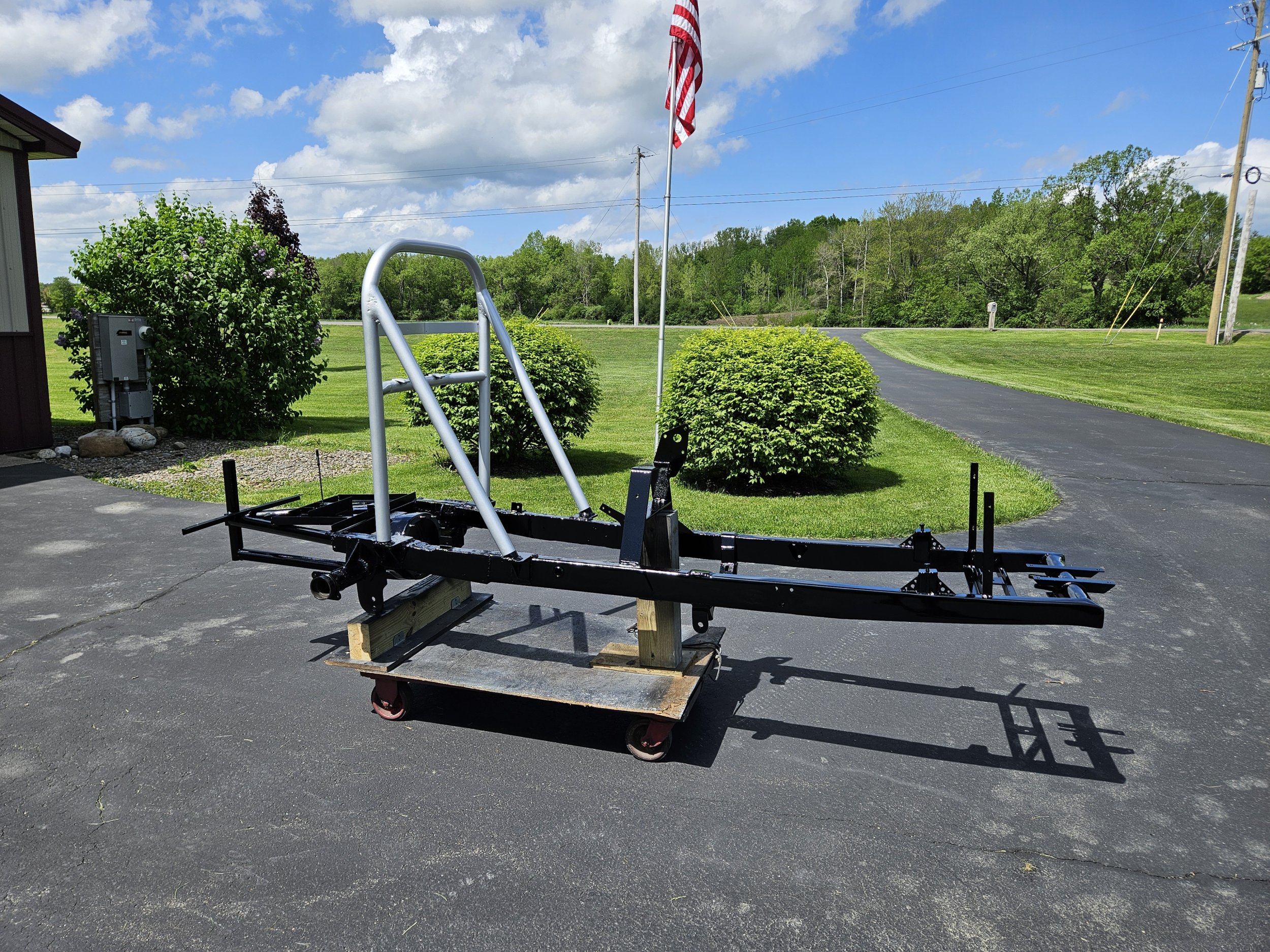

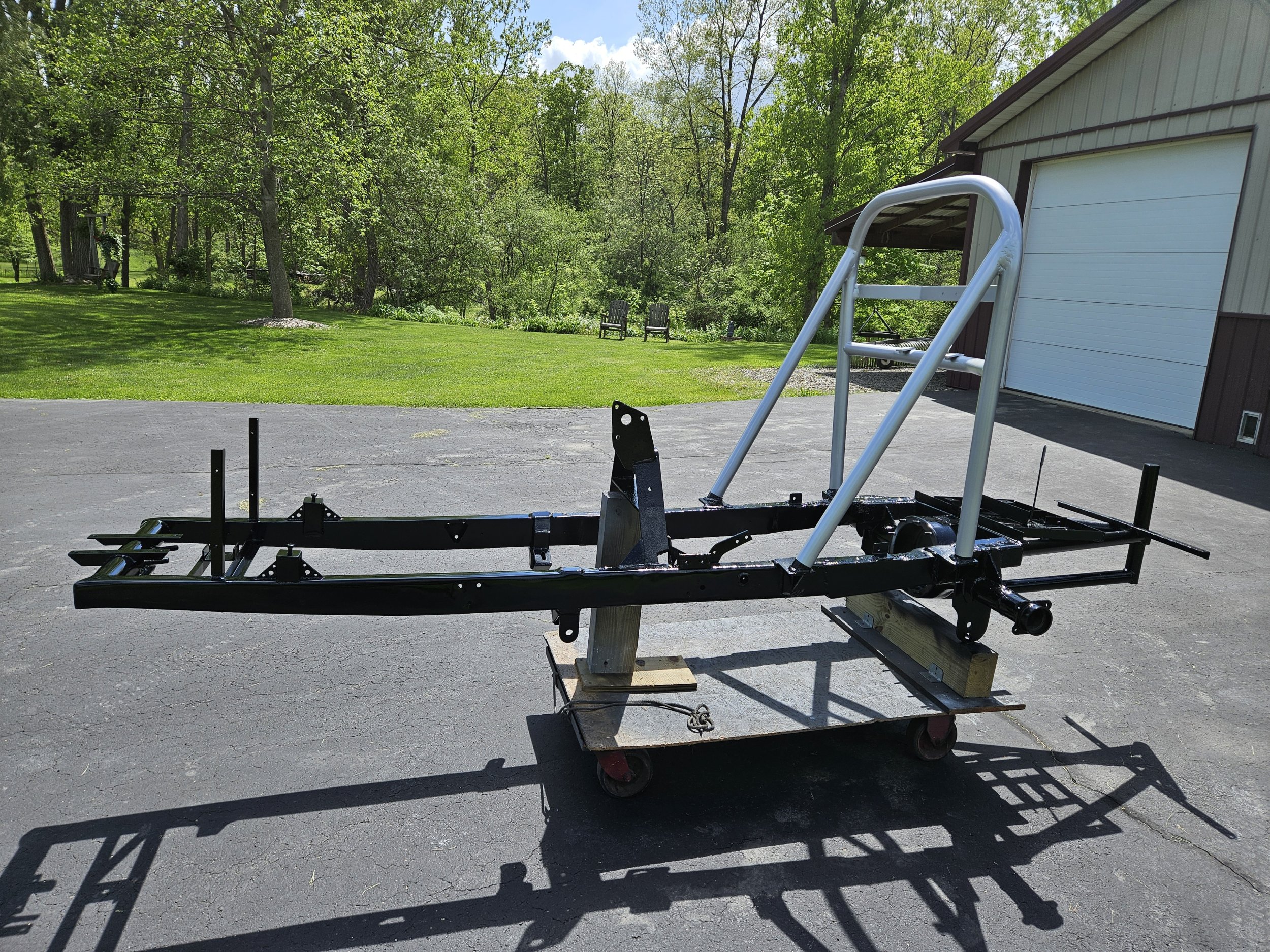

    Lots of work going on but finally made some progress today that was worthy of posting. 20250516_150951.jpg

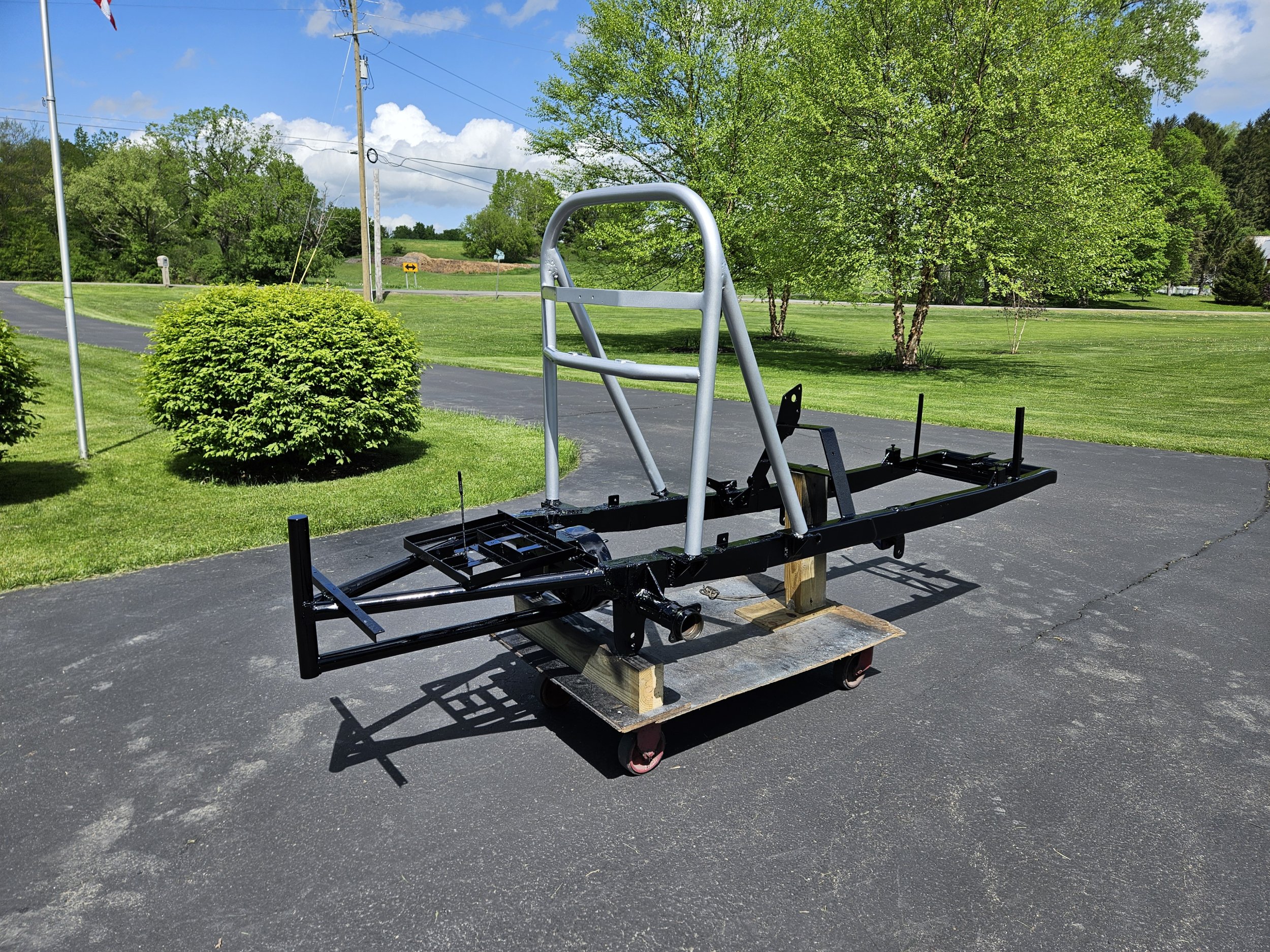

    There was a surprising amount of work to get the ch***is to this point. I'm pretty confident it's significantly stiffer than it ever was when it was raced.

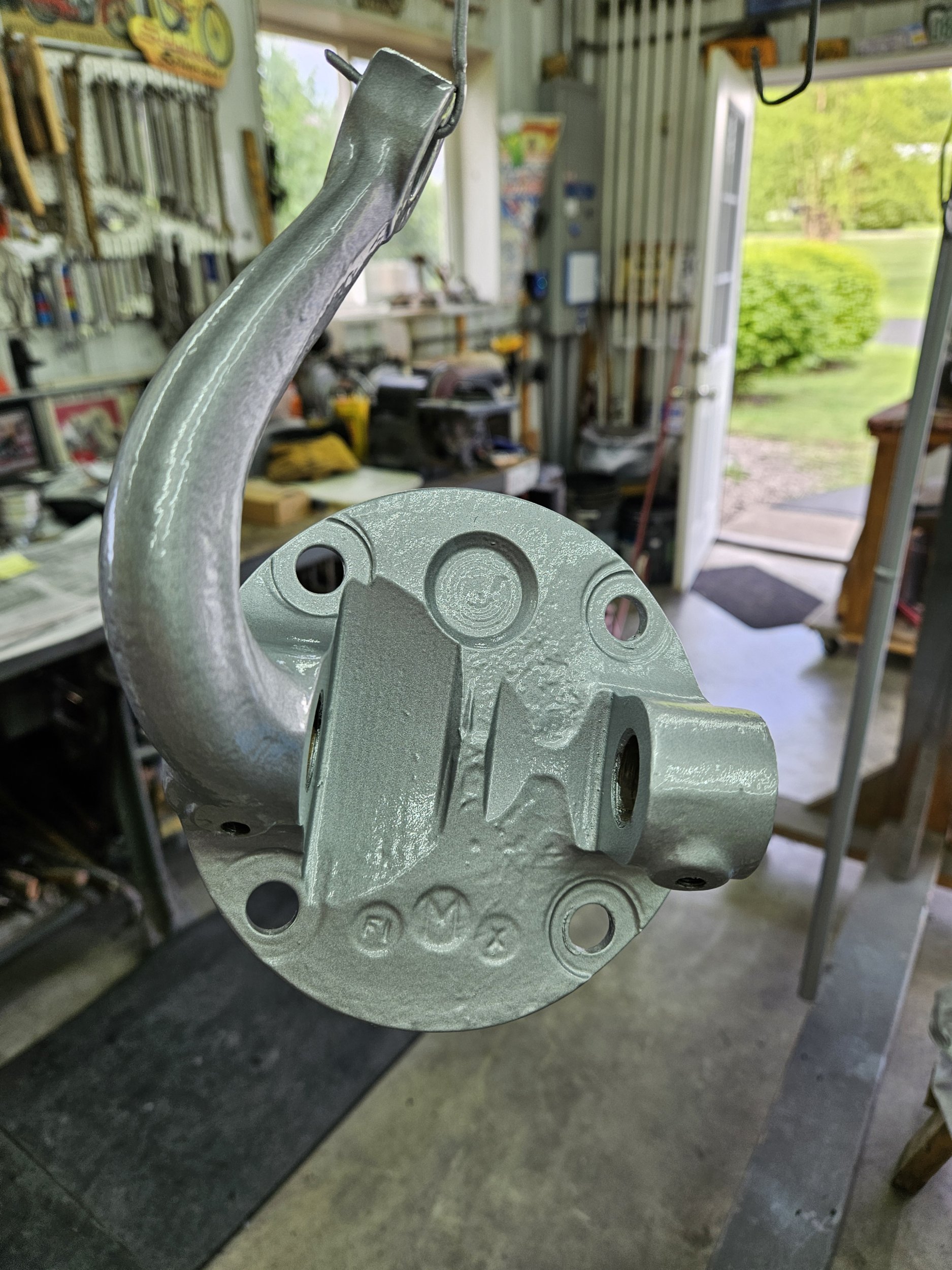

    I'm still filling pits to get the suspension ready to be sprayed but shot the front spindles along with the roll bar to check out the color. It matches the last shovelhead I finished last fall.
    It's nice to be at a point where I can start bolting things on to the ch***is.

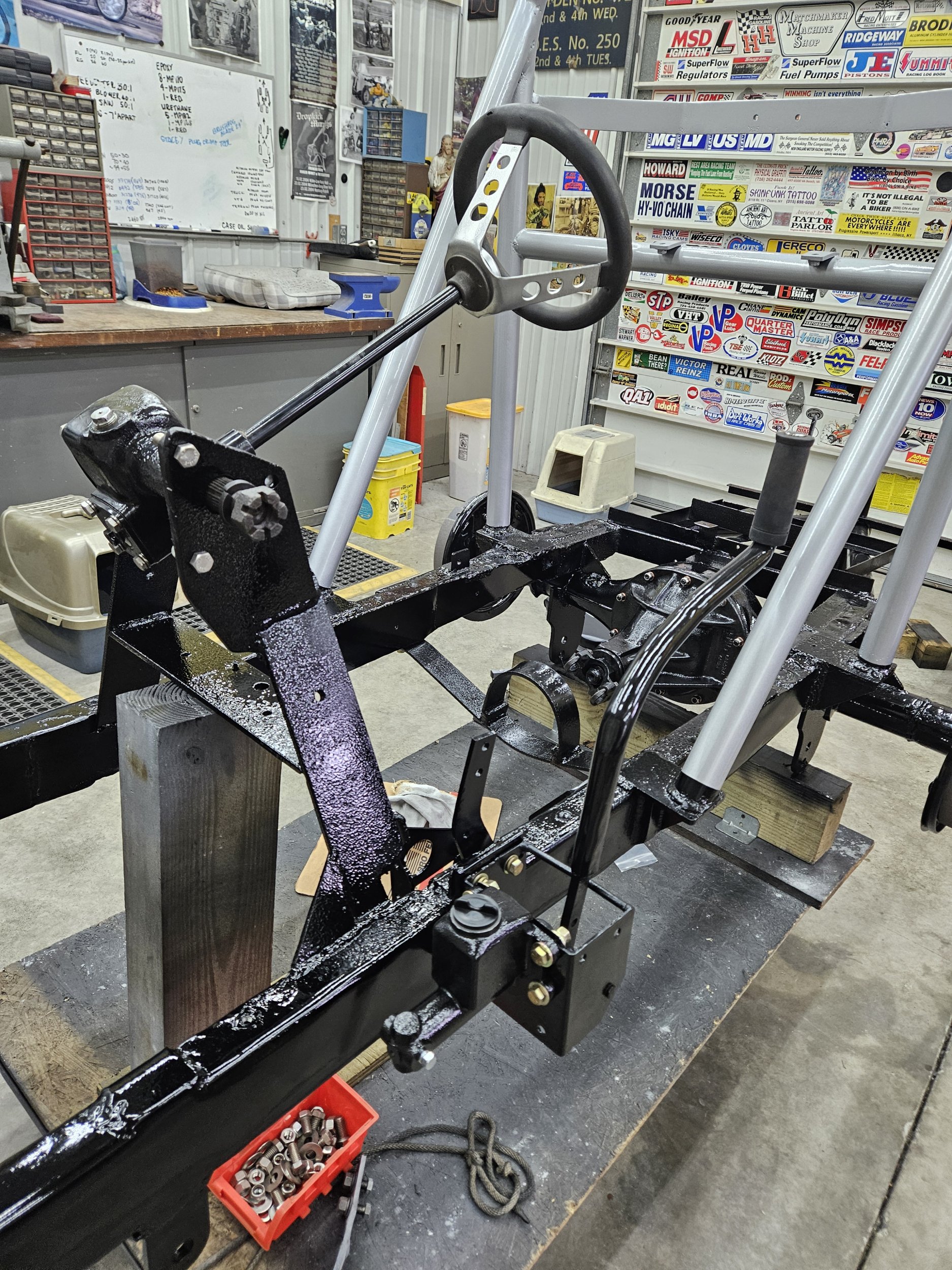

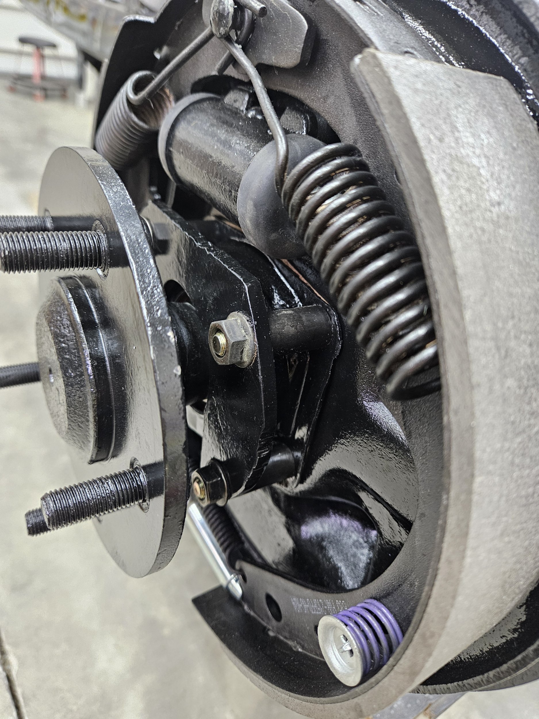

    Really crummy weather this week in the northeast. Spent some time ***embling the rear end and bolting on steering and brake and clutch master cylinders and hardware.
    20250517_161503.jpg 20250517_163028.jpg 20250521_093654.jpg 20250521_093704.jpg 20250521_102741.jpg

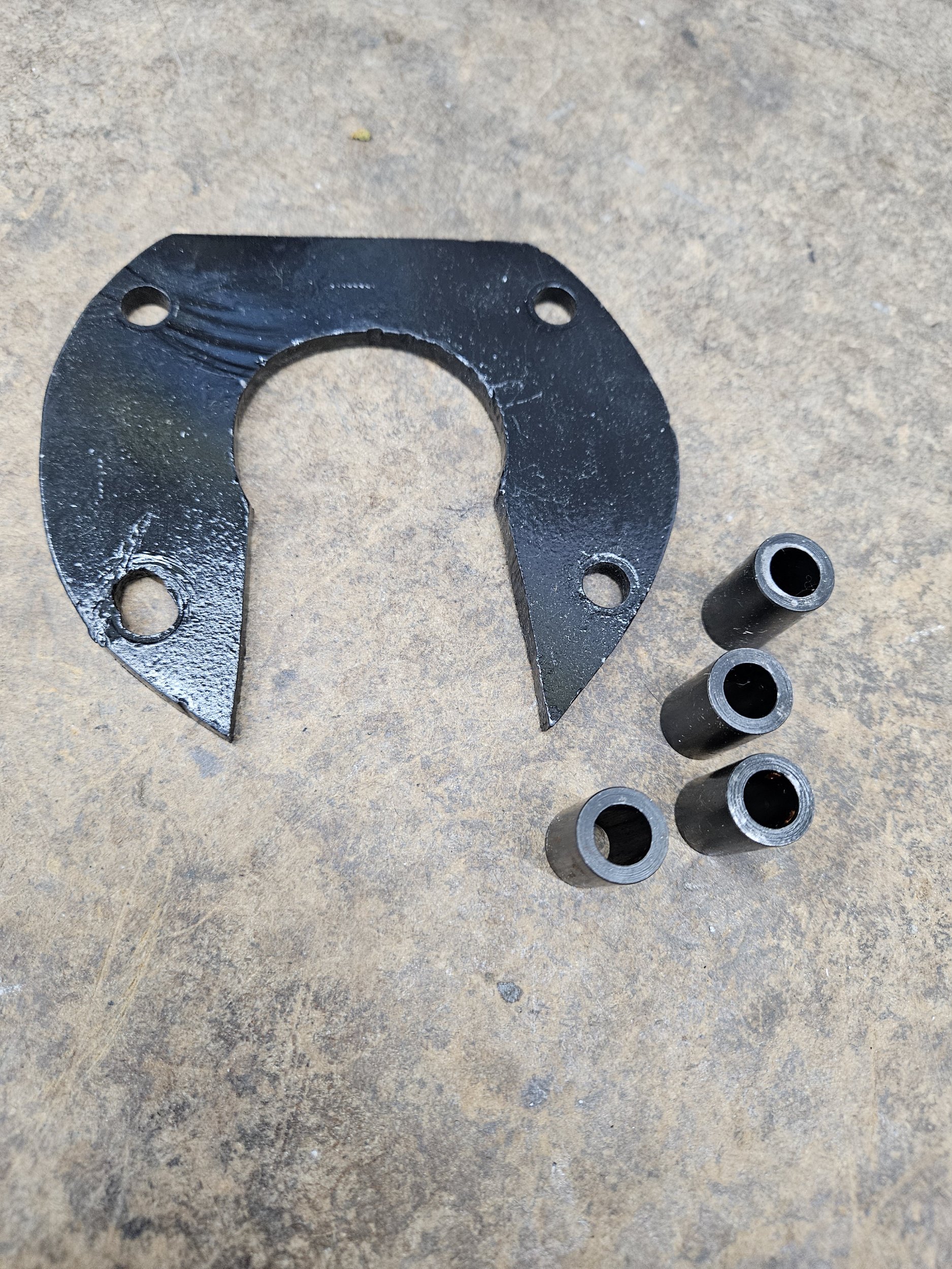

    I appreciate the little details like the homemade axle retainer hardware. I needed to remake the spacers as the originals were literally half rotted away.

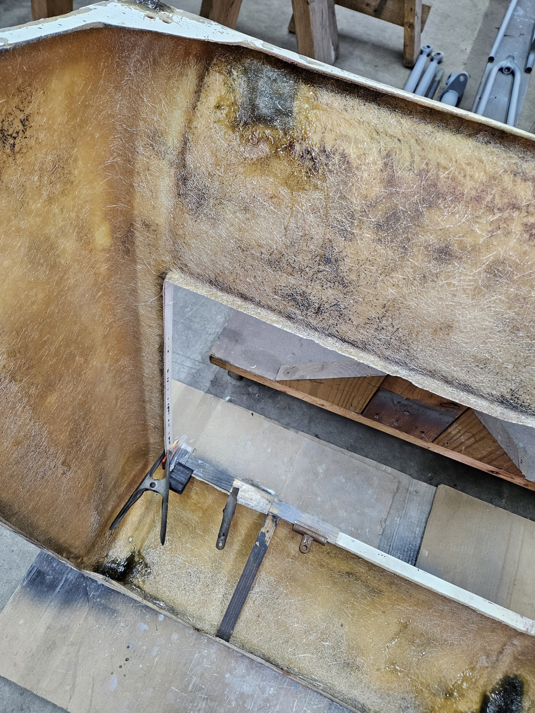

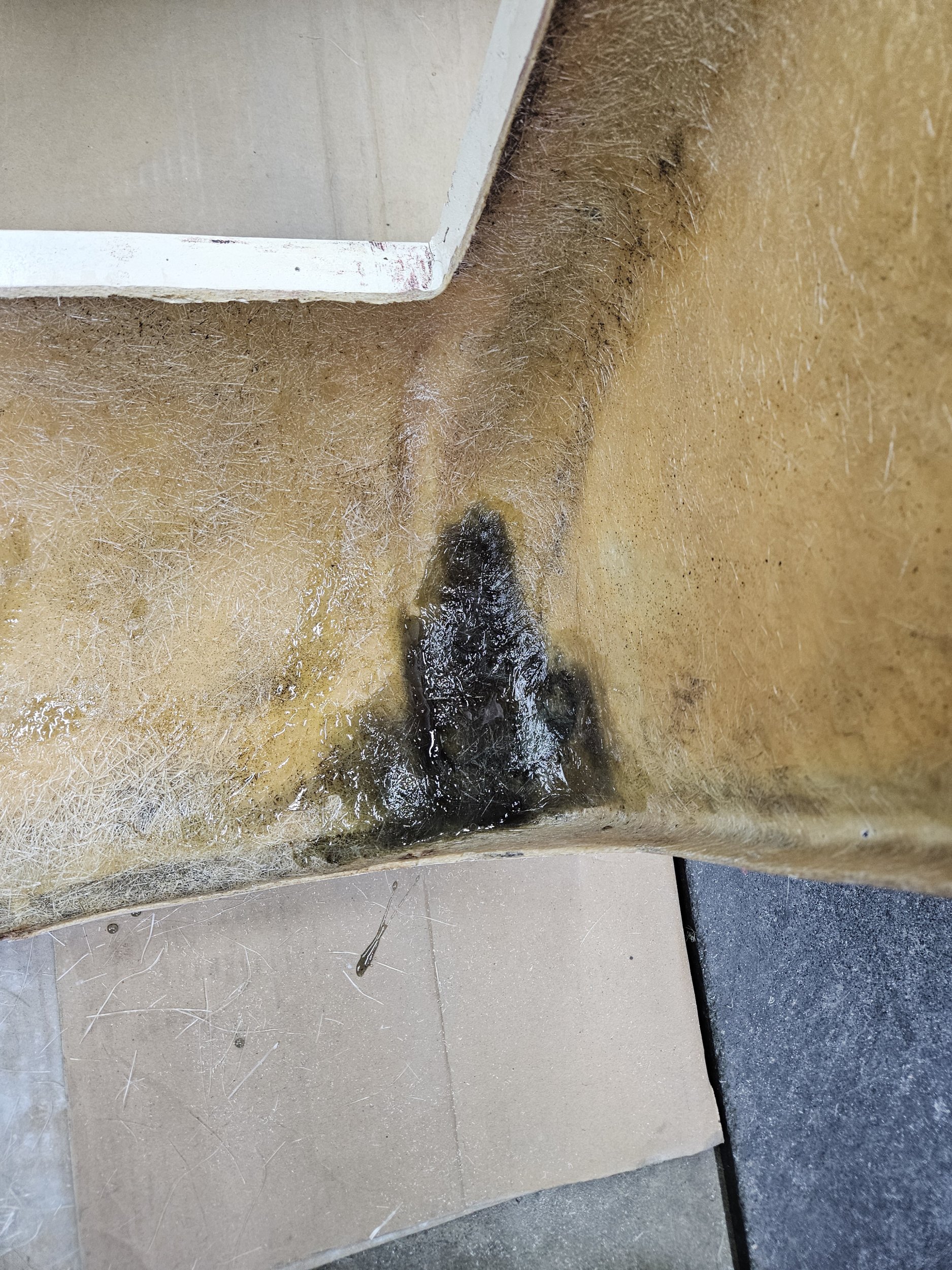

    Took advantage of a cold and rainy morning today to patch some areas that needed a little attention on the turtle deck.

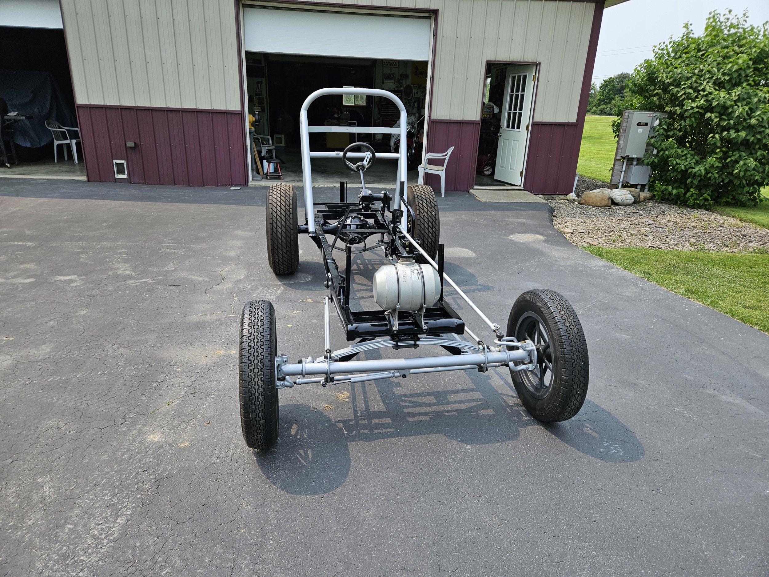

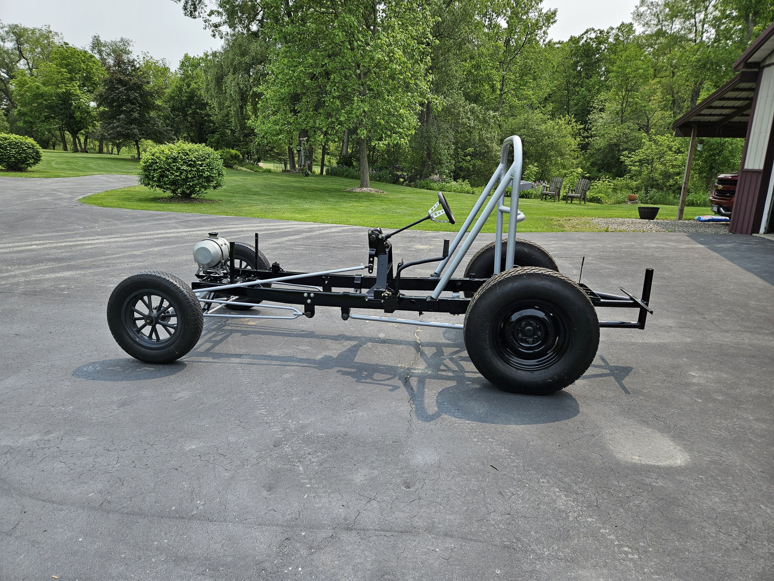

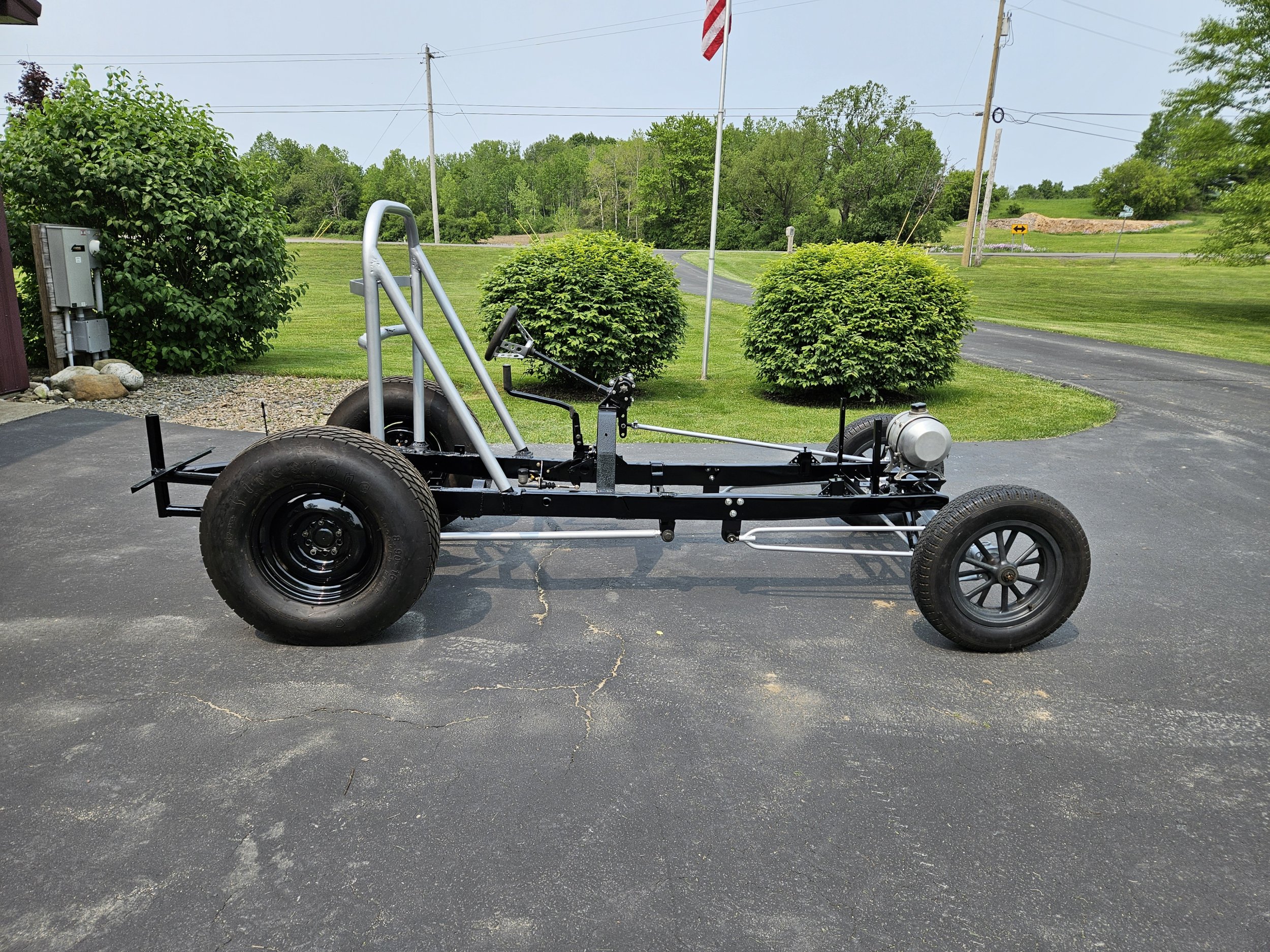

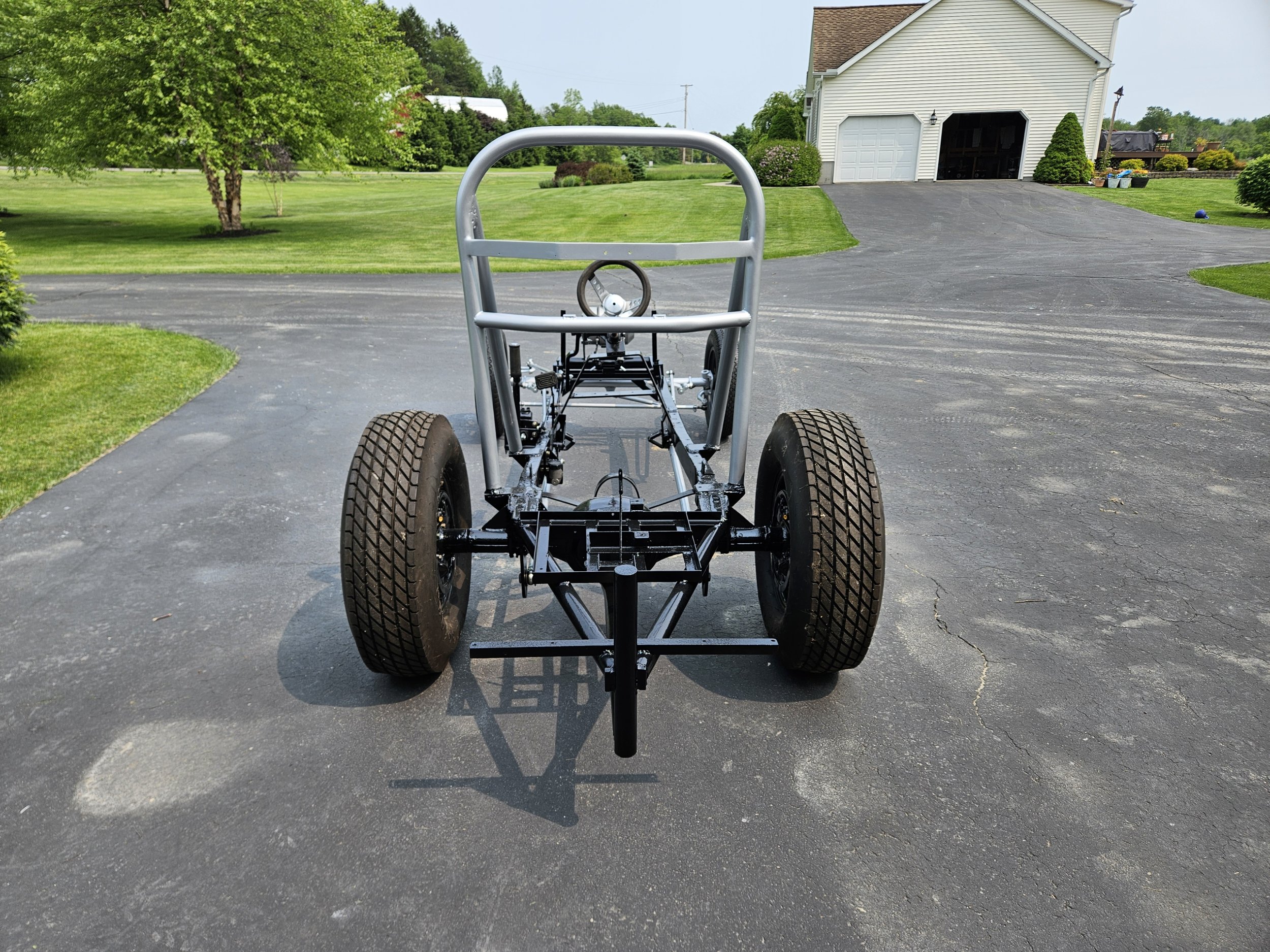

    Achieved a major milestone today and made this thing a roller again.

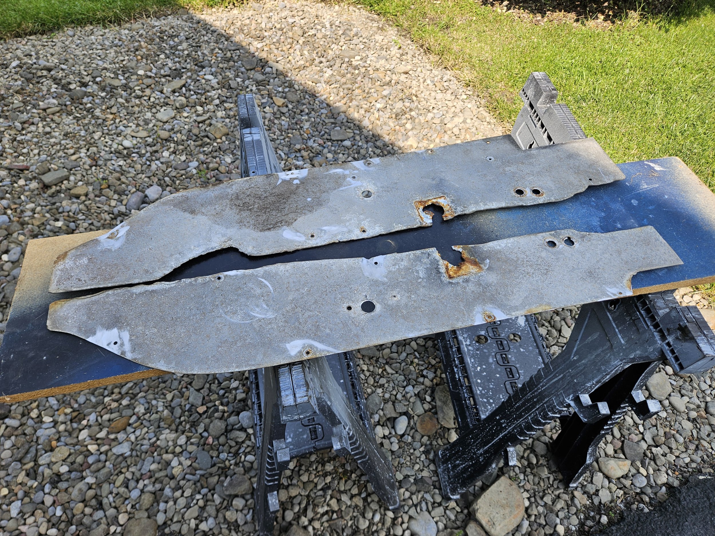

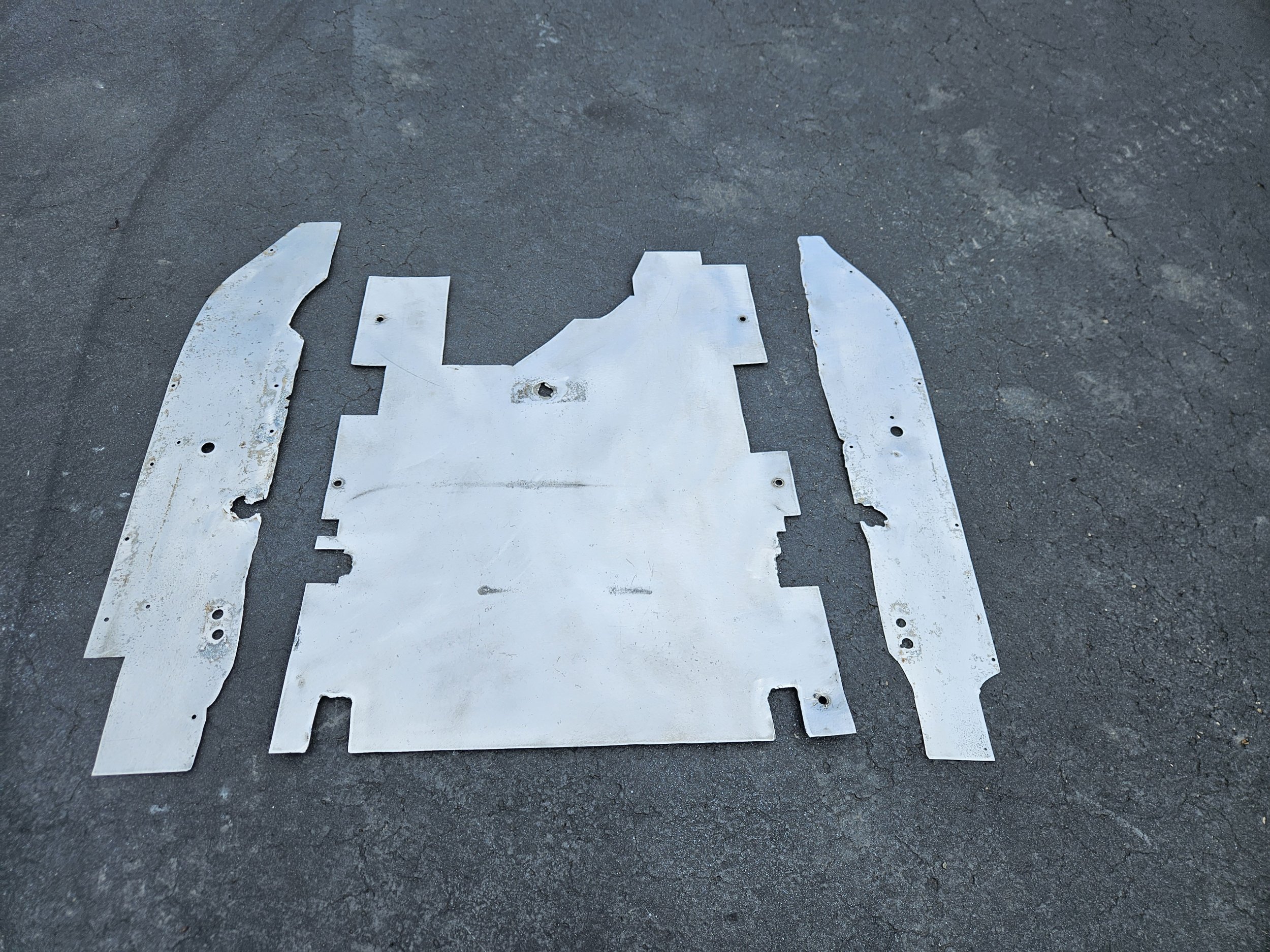

    Planned to buy some new aluminum to remake the floor panels but cleaned up the old ones instead. Figured there was no need to replace functional original pieces.

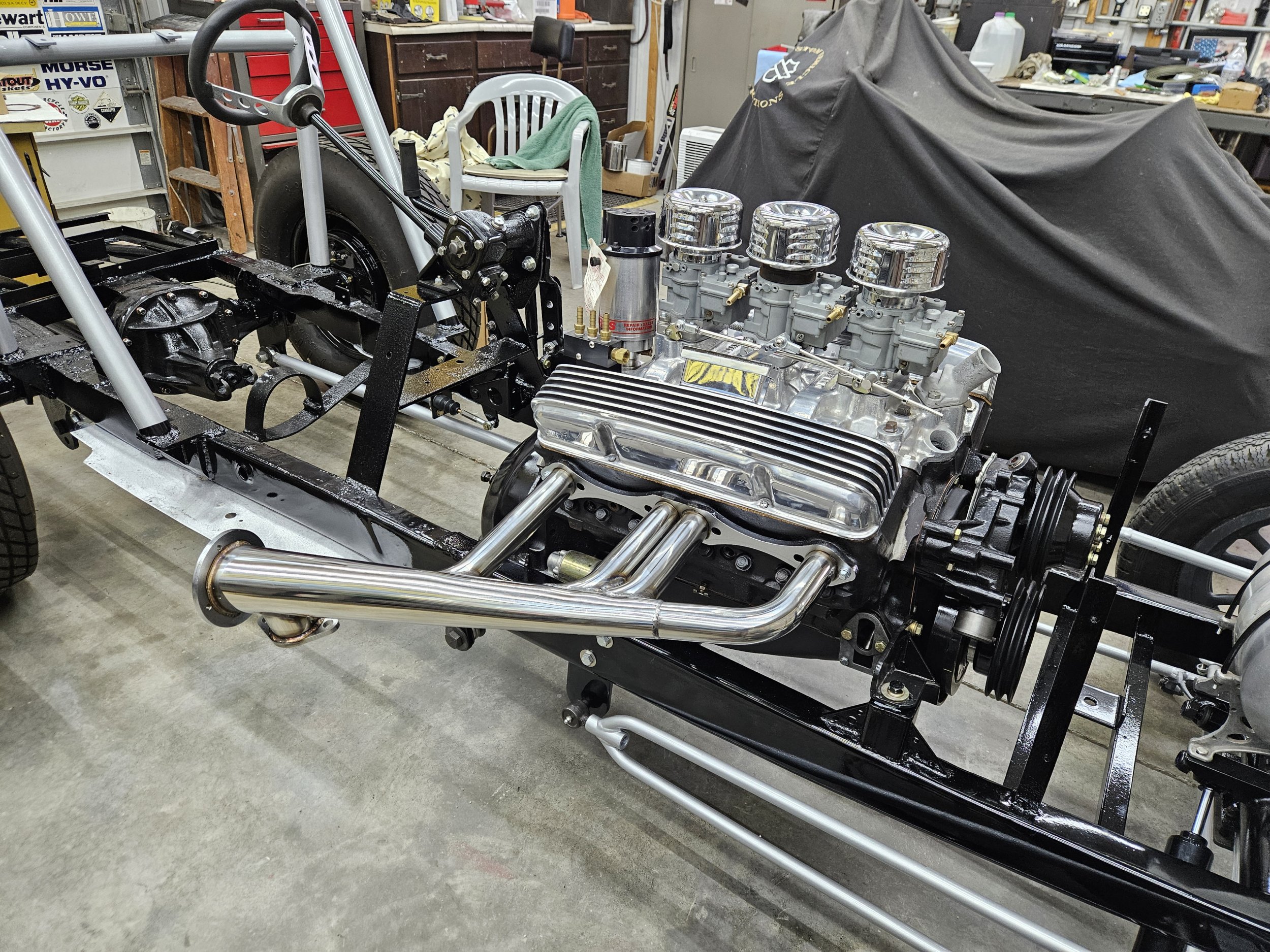

    Got the engine in, still sorting out the hydraulic throw out bearing so the transmission needs to wait on a little machining.

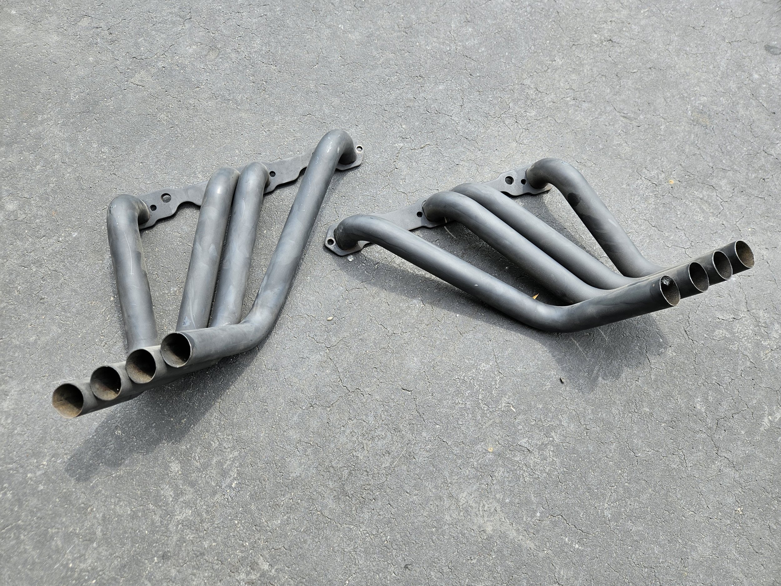

    Gave up the idea of cutting up the zoomie style headers I had to make them work and went with some cheap auction site lakester style headers. Surprisingly good quality and fit for the price.

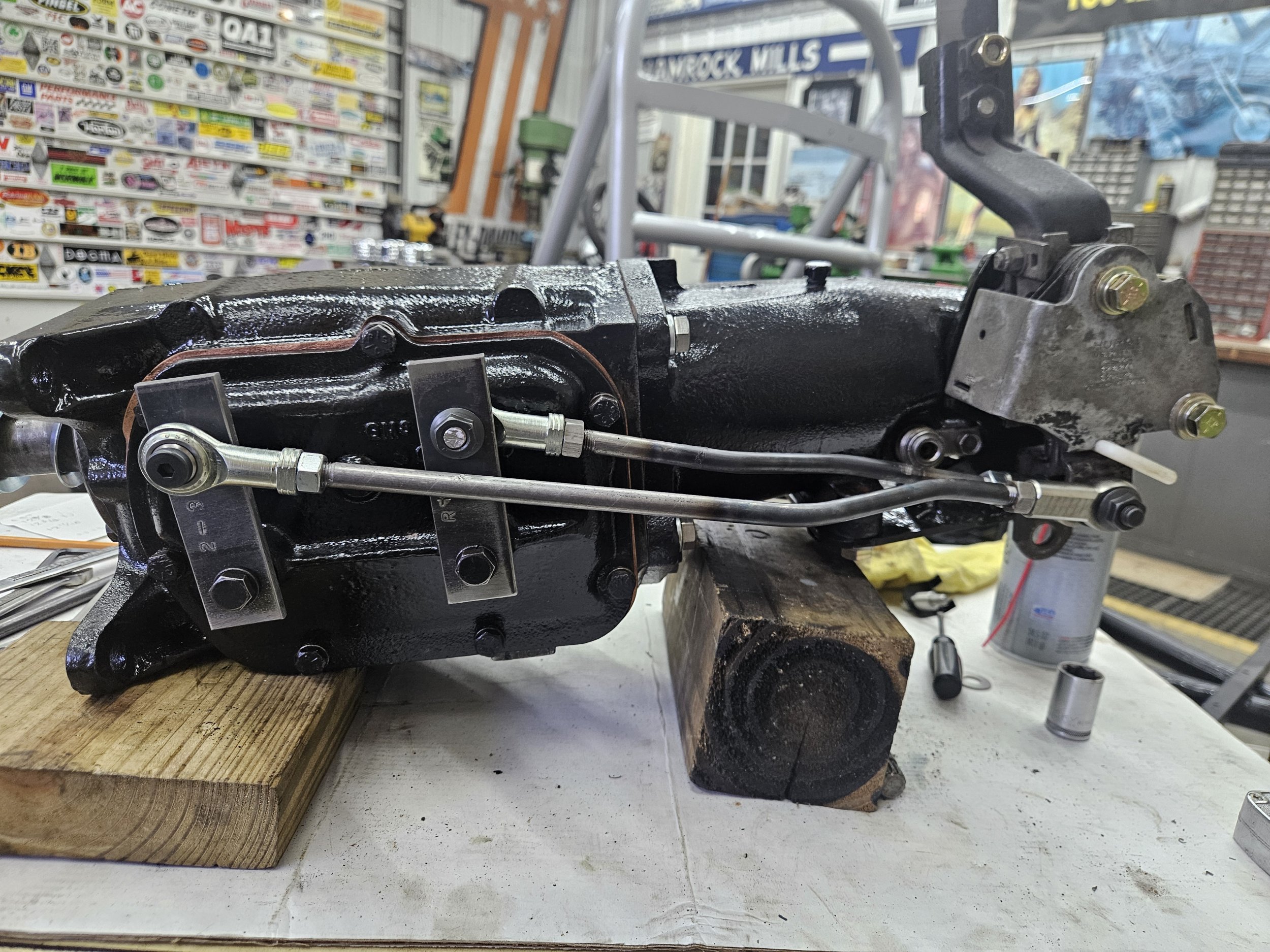

    Turned a $5 4 speed garage sale shifter into a 3 speed shifter with some flat stock, round stock and rods ends off the shelf. Started the wiring and getting ready to mount the seat.
    20250623_171708.jpg 20250627_120205.jpg 20250625_115958.jpg 20250627_123807.jpg 20250627_123818.jpg 20250627_130004.jpg
