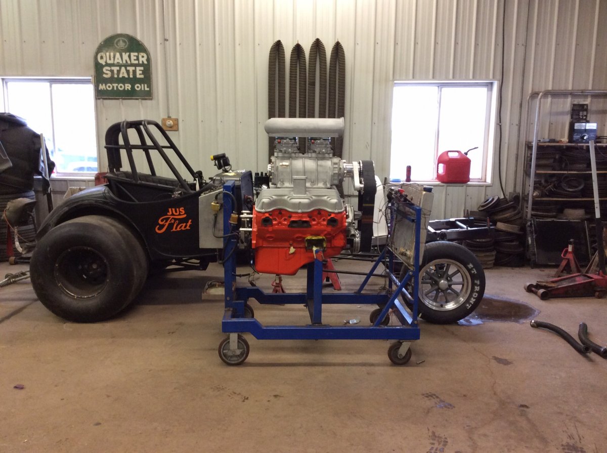

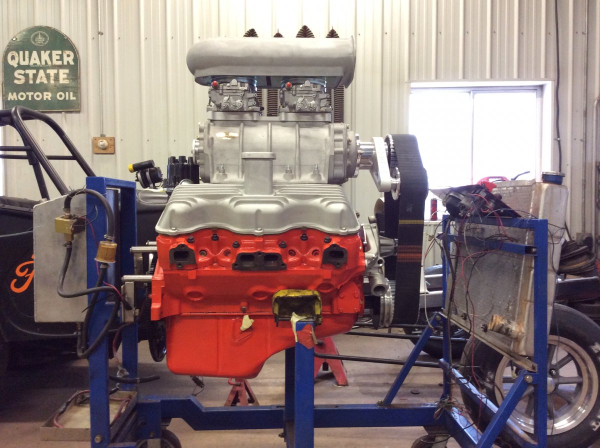

    Here is an altered I bought a few months back. Shortened up to 108 w.b. Just picked up the motor from the machine shop. Stroked 348/380 inch 6-71. Still have ch***is work to do, and fab front mount and such. Hope to have it together this summer.

    Thanks fellas, I hope to fire the engine next weekend. Still rounding up some small things. This motor will go on the dyno for some tuning and such shortly. Just want to make sure I don't burn this b!tch down on the first run. Then to get back on the ch***is. I am really enjoying this build. These altereds sure have a nasty look about them don't they.

    I have no idea what number the car will run. With a 750 horse 565 bbc it had gone 8.60/168 and the car is under 1800 pounds. The blown 380 is a mild street build, should run 500-650 horse depending on boost levels. I was told 10 flat is the cutoff, after that the safety stuff really starts to add up, and the ch***is would need to be certified. All this stuff is new to me and am learning as we go. I sometimes look at the car and think "damn, I gotta drive that thing HOW fast!!". My wife has told me she is getting a bit nervous about the whole thing. Too late to back out now.

    Ch***is was not certified before. This 348 has a sbc size crank snout. I am running a crank hub,no balancer. I asked Don Hampton about the crank snout size and he told me if I use a crank hub, double keyed, I should be ok. A lot less weight on the end of the crank, and closer to the engine for less leverage. I had Don build the intake, and got the drive from him as well. Only planning on 6-8 psi for boost. Less than 6000 rpm, shooting for 5500. Not setting any records with this one, just having fun. Flex plate is SFI approved, glide will have shields, car has a floor. Has a chute. Did not know it had to have a blower restraint. It is running twin carbs on gas. Has battery shutoff. No belt cage. Will have to check throttle pedal, I believe it has a clip. Your advice is VERY much appreciated.
