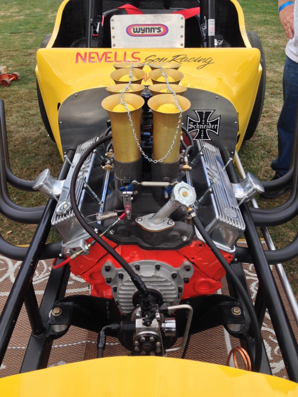

    almost have my Eagle Field altered done(missed may).....anybody ever use a large motorcycle radiator for cooling a sbc.....or am I just being cheap?...dimensions need to be 10"x17"-20".
    Its gonna be laid down between the frame rails in front of the motor...........any suggestions??.......................................................................unky d

    We do not use a radiator on our altered, we run alcohol and it never overheats, just fill the engine with water , drain out enough to give some expansion room , run a 20psi cap on the water neck,even hot lapping it will not fill the puke tank

    here is a pic of the front of the engine, we use a WW2 canteen as a puke can
