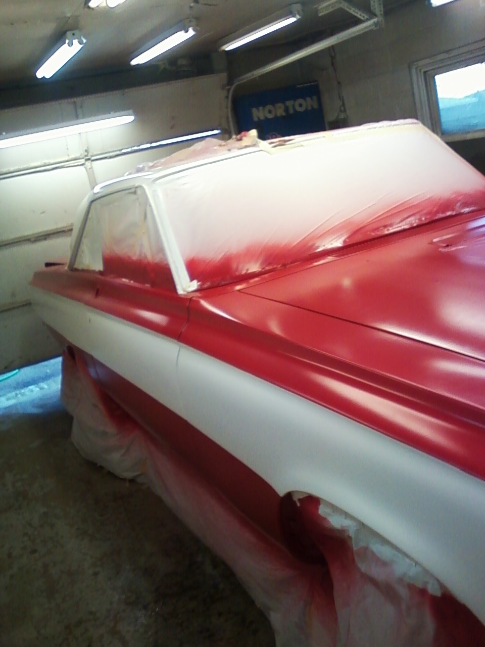

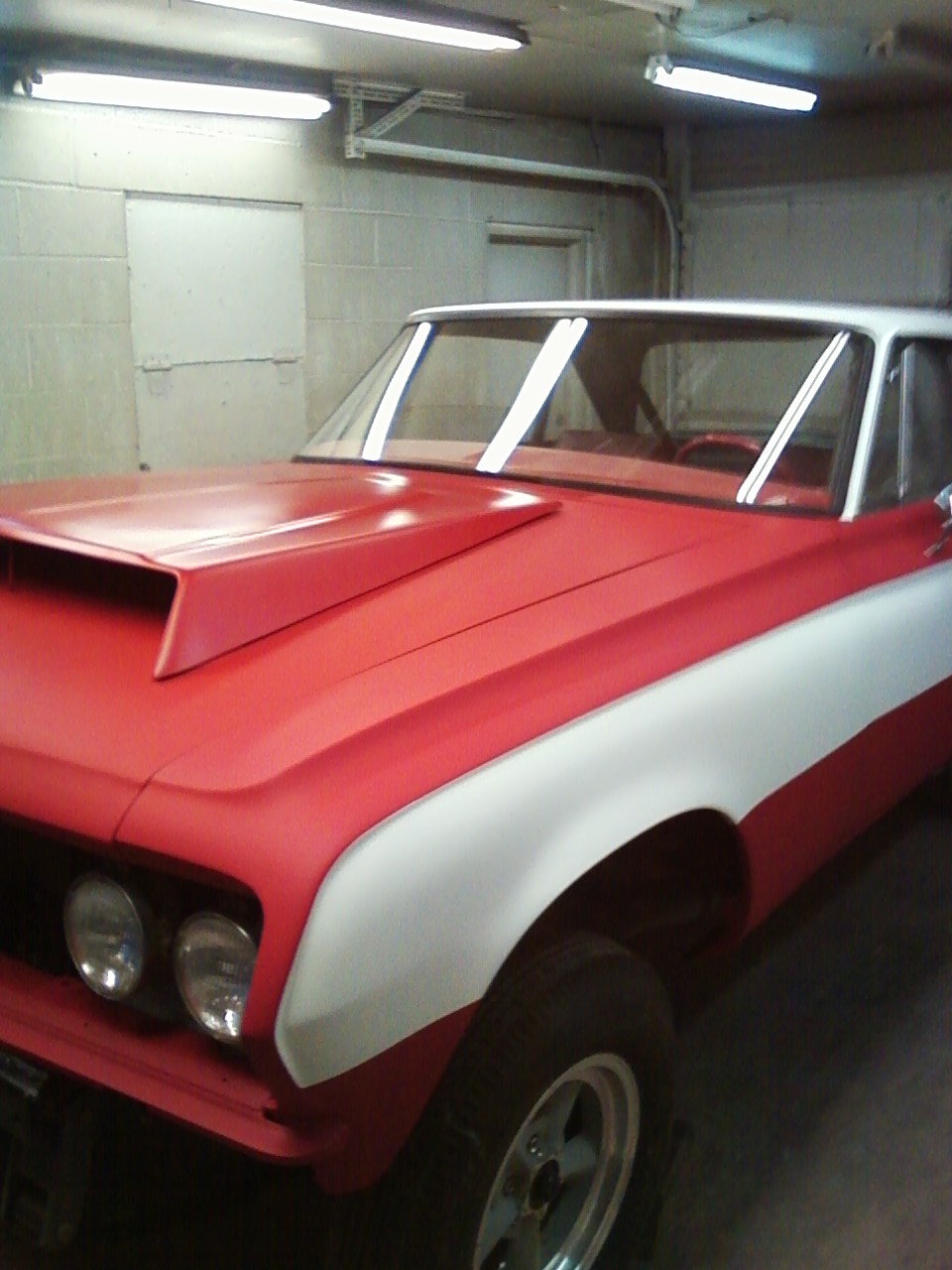

    she is coming along, will be done befor end of month
  29. oldschool king 27
    Joined: Dec 11, 2008
    Posts: 329
    oldschool king 27
    red and white
