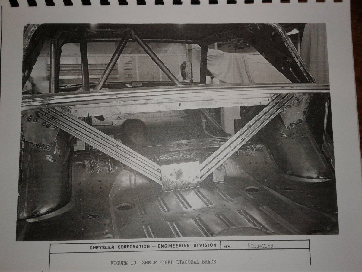

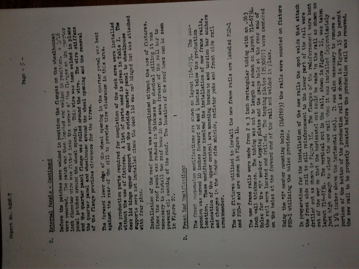

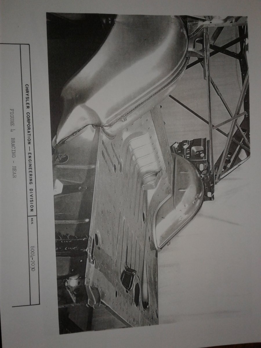

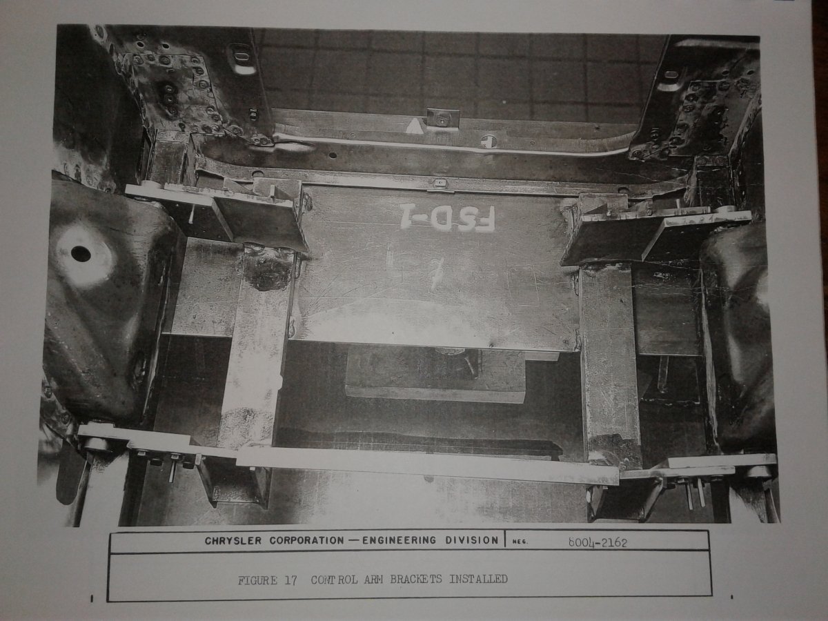

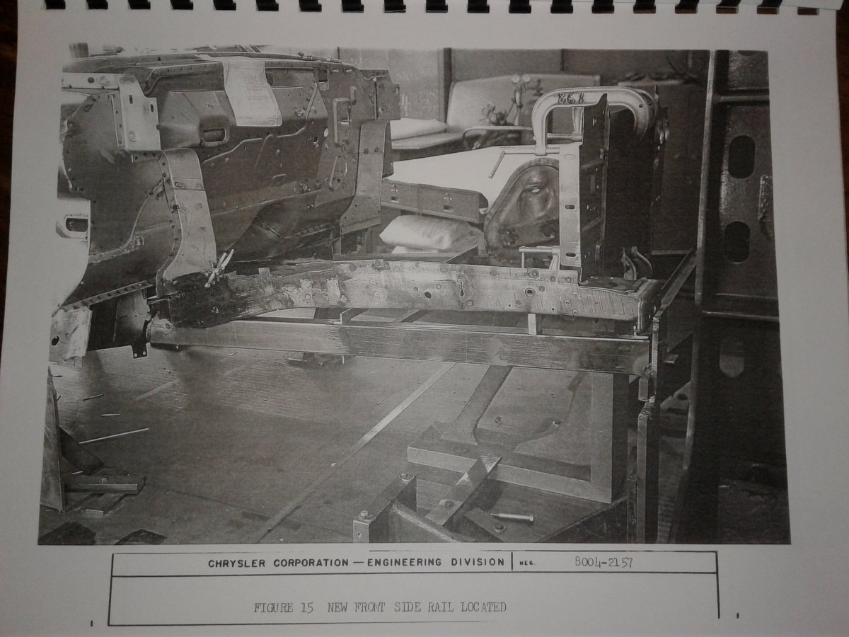

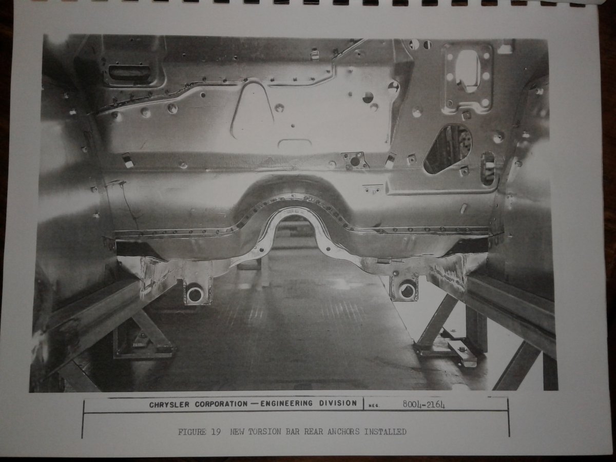

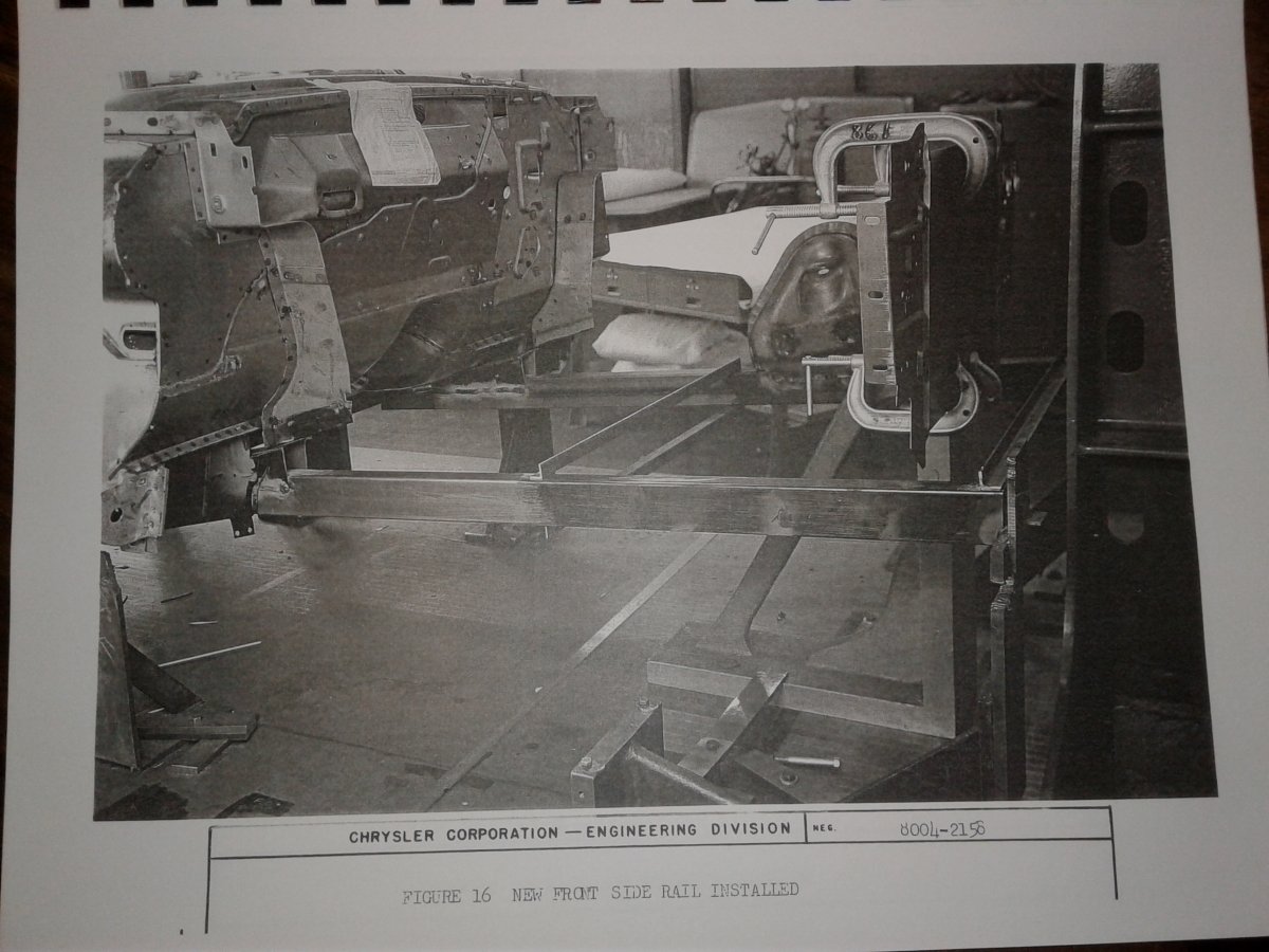

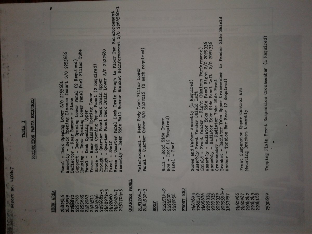

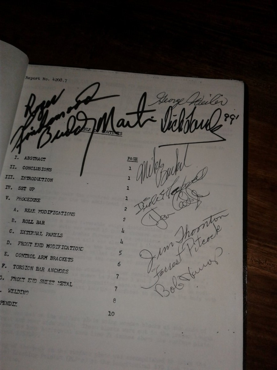

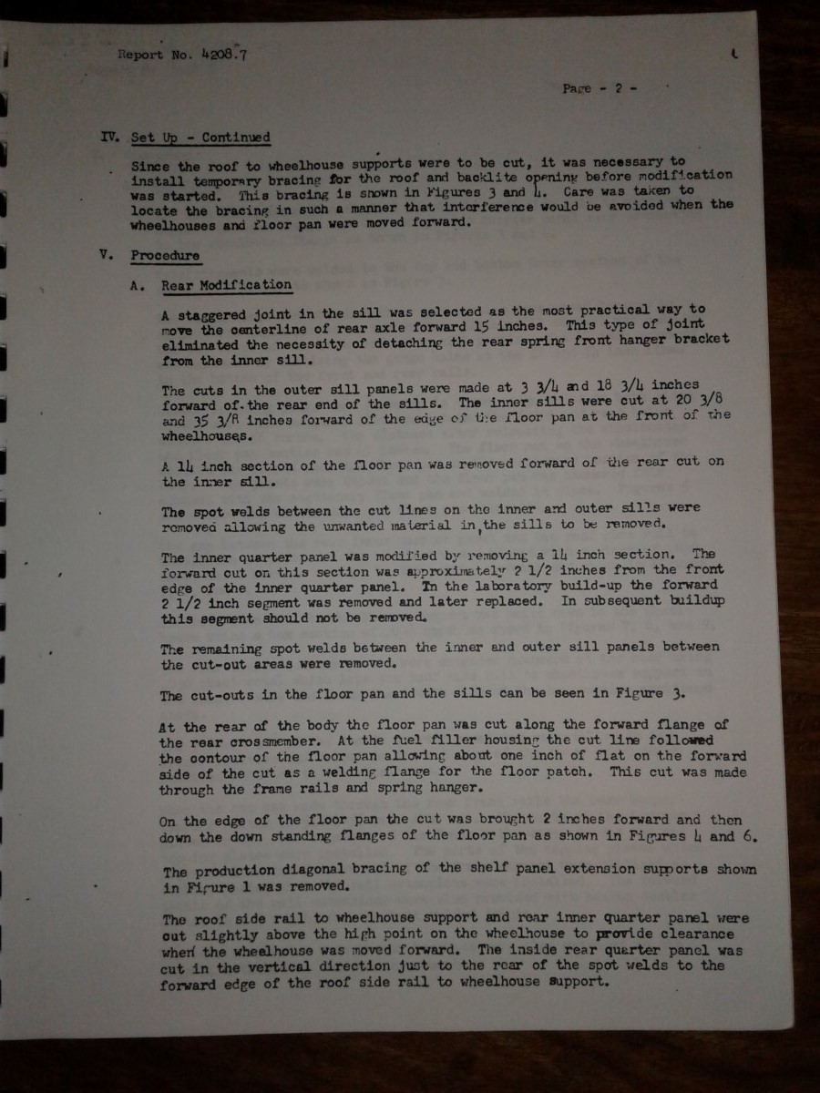

  20. This is the holy grail of mopar awb reading. Its the factory technical report on the feasibility of making the modifications to a b- body. Every cut; weld and modification is recorded here. There is even a parts list. Some factory pics were shown earlier in this thread at the conversion company chrysler hired called amblewagon. These pics precede those. these pics were taken at chrysler. This collection of pics records the first ever awb car being created. This mule car was then presented to amblewagon to make more after it was determined to proceed with the project. There are many ways amblewagon changed the way the cars were made. They for sure did not follow the procedure outlined here. Notice the cofidential on the cover. On one of the copies i have multiple autographs of my heros. see how many you can make out. sadly several have p***ed away. I have had personel conversations with every factory driver exept dave strickler. Great memories. 20170101_211132.jpg 20170101_211144.jpg 20170101_211222.jpg 20170101_211231.jpg 20170101_211240.jpg 20170101_211249.jpg 20170101_211300.jpg 20170101_211321.jpg 20170101_211332.jpg 20170101_211345.jpg 20170101_211353.jpg 20170101_211402.jpg 20170101_211410.jpg 20170101_211429.jpg 20170101_211452.jpg 20170101_211506.jpg 20170101_211521.jpg 20170101_211539.jpg 20170101_211550.jpg 20170101_211600.jpg 20170101_211611.jpg

  22. i don't know why the phone flipped some of the pics. i don't know how to flip them back. loud bang we all appreciate your hard work posting all of these pics. one posting with a wrong caption is no big deal in my book for all of the work you have done.

    That's awesome. I never realized so much went into the conversion. Now I just have to find a Coronet ;)
  24. you would be surprise by the efforts the factories put into their racing development. mopar had multiple mule cars running around. the engineers worked on everything from hood scoop height to injector stack length to tires. the engineers reported back to a variety of higher ups. the names of everyone that received that particular report are listed on the bottom. the reports make for great reading as they show the progression of the program and their progress. successes and failures are recorded with the dates the tests were done. arranging a stack of reports by their date allows the reader to follow along as the cars developed. during the winter of 64-65 several cars were loaded up for testing in california at rented tracks. the awb and super stock cars didn't happen by accident it was a all out factory effort.

  25. i should mention that forrest pit**** gave me his personal copy of the report. its due to forrest that you were able to view this rare piece of factory awb history. for those that don't know who forrest pit**** is he was a factory plymouth engineer. he has many credits to his name. he was heavily involved with the development of the stack fuel injection unit. he was also involved with the golden rod record setting land speed car. he was a member of the golden commandos club. he also a test driver piloting both super stock and awb cars. he was a regular competing at the track. a great contributor to everything mopar during those years.
