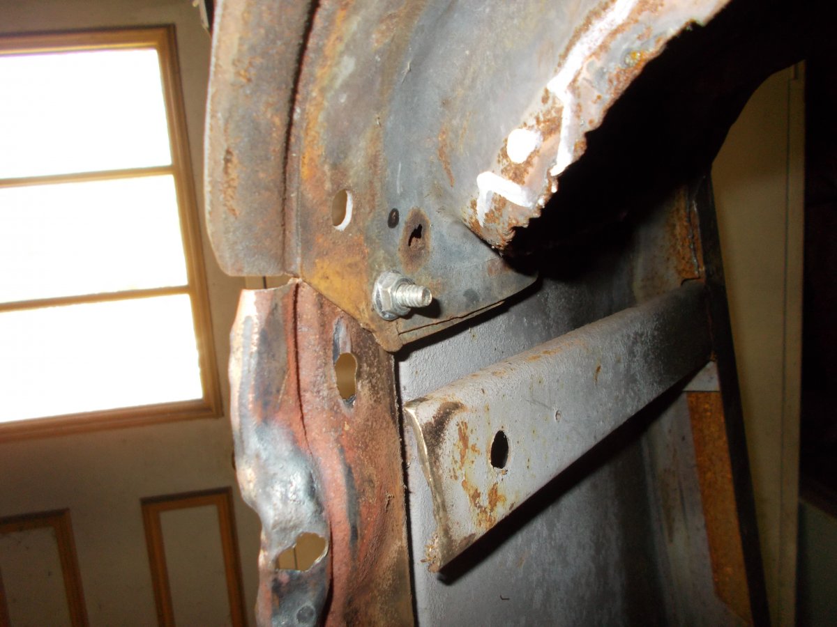

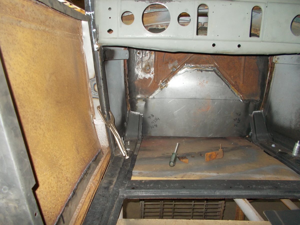

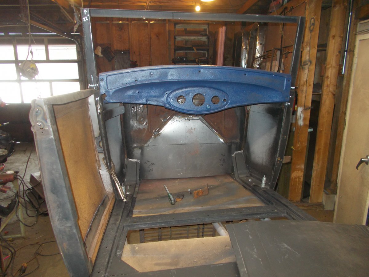

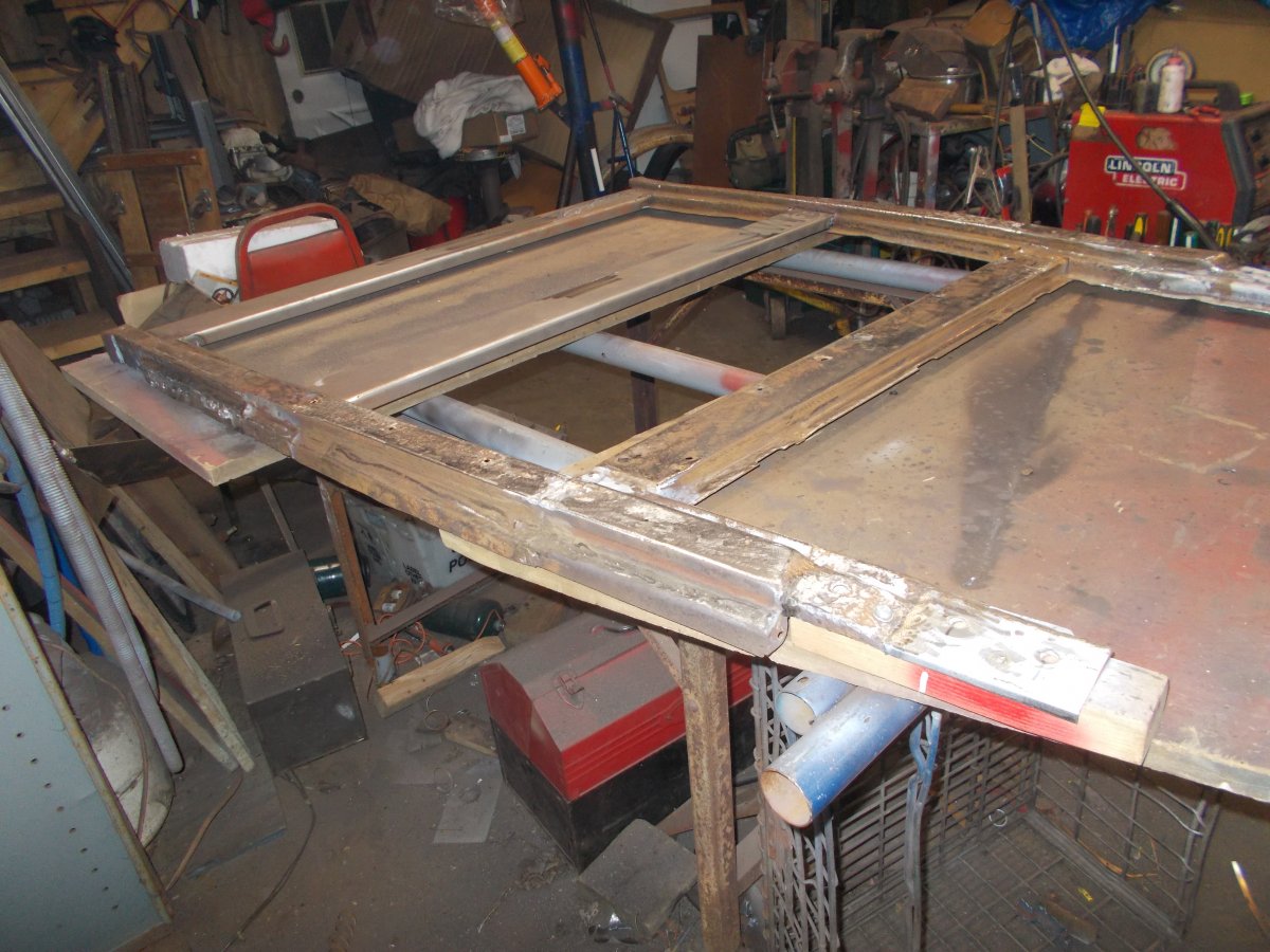

    I slid a pair of cut off sub floor sections into the extensions, lined up the holes with the wooden blocks and screwed them down...
    I bent an angle onto a couple pieces of scrap...
    slid them in from the front till the met the subfloor extensions, welded them in...
    these plates will be where I weld in some re-enforcement to bolt down the cowl front...
    don't drill the holes till it is time, a '32 frame will be a little wider at that point...
    A =27.5".

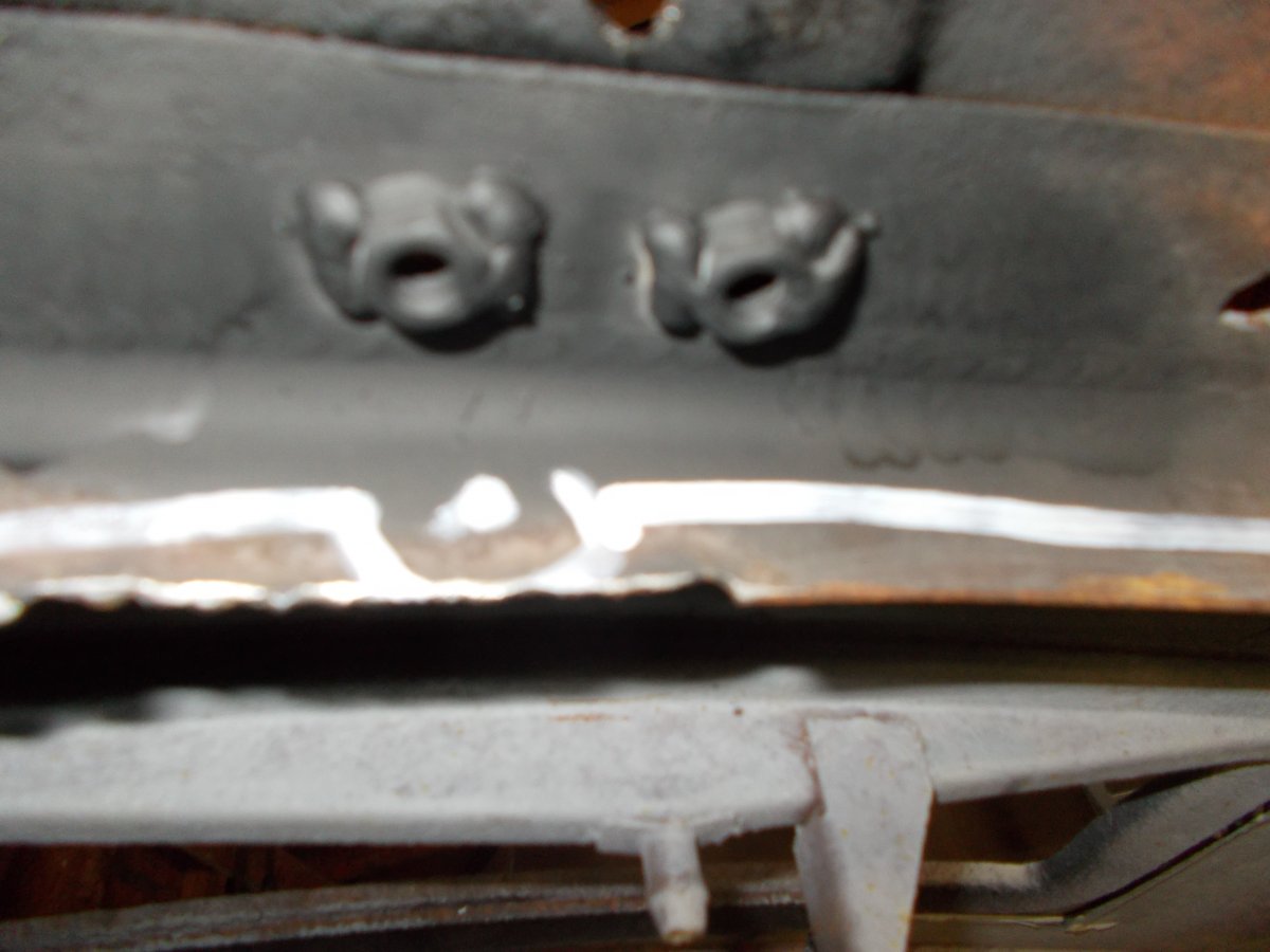

    while I had laid the cowl back I bolted on the rear hood retainer and welded on a couple nuts to mount it later...
    also drilled a 1/4" hole on each side through the cowl side into the tank top's inner flange to secure it without the firewall...
    shortened the toe boards so they will better match the closer firewall... DSCN3674.JPG DSCN3675.JPG DSCN3677.JPG DSCN3678.JPG DSCN3676.JPG DSCN3679.JPG
    The 2 cowl / tank bolts cleared the reversed firewall that had the 1" offset removed...

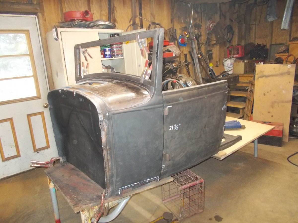

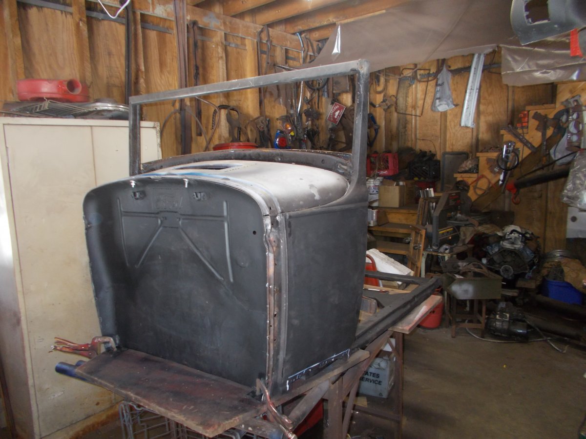

    The pile is transforming towards a coupester body...
    bolted the cowl through the 3/4" plywood to anchor it... and still move it around a little...
    more to come..

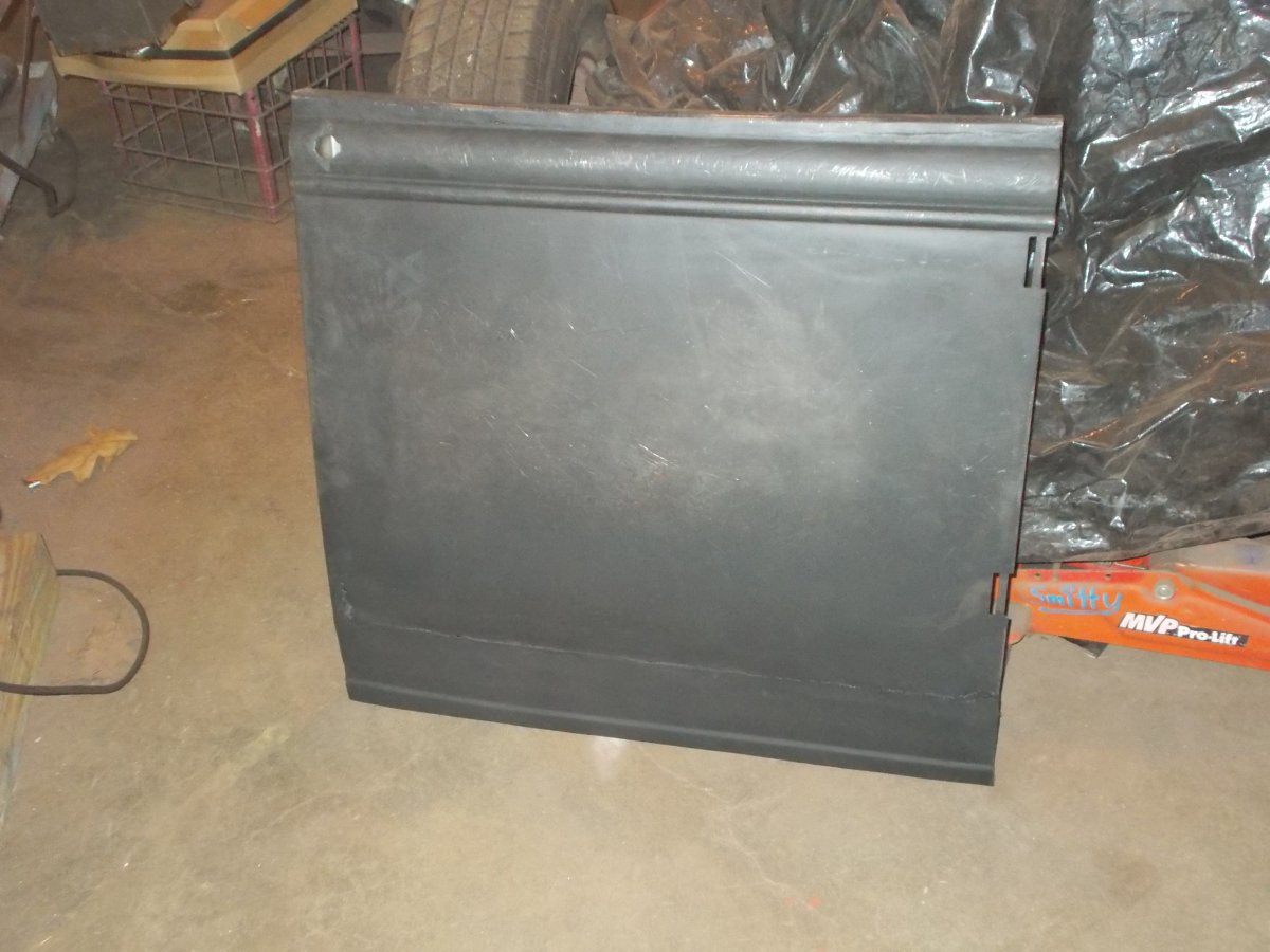

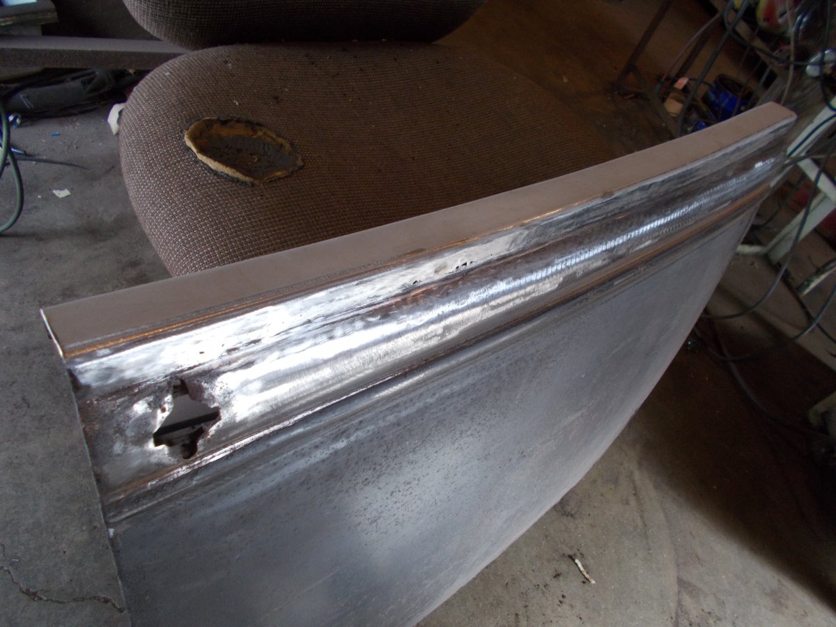

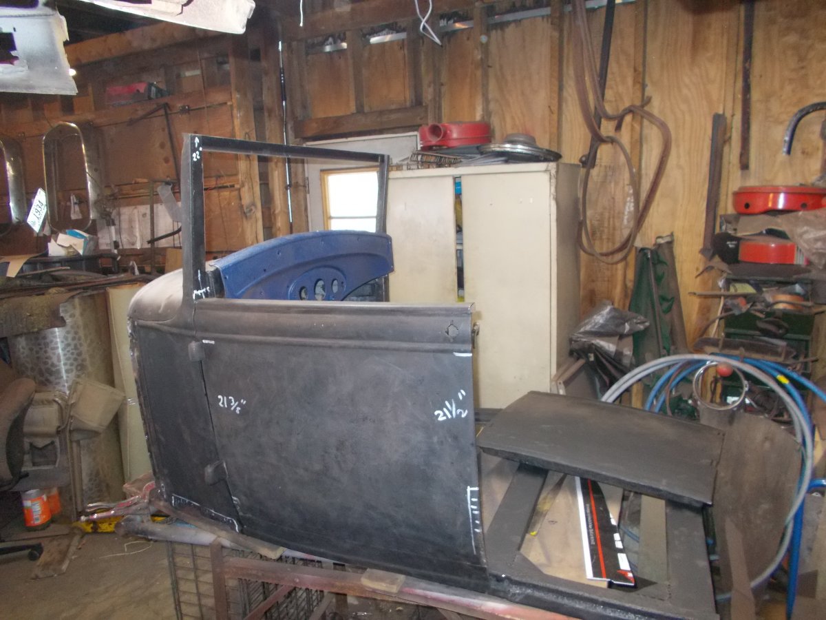

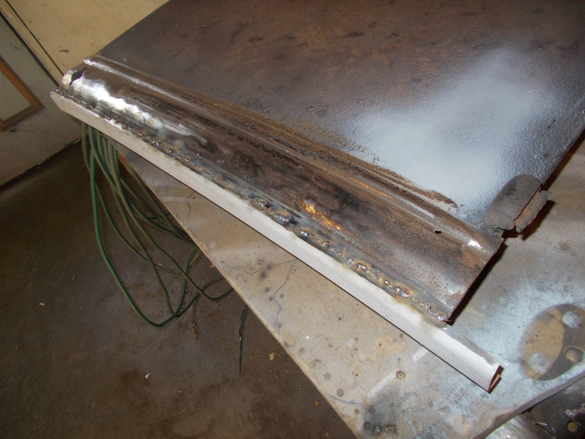

    '30 coupe door, narrowed, shallowed and shortened...
    '38 car dash...
    DSCN2103.JPG DSCN2064.JPG DSCN2063.JPG DSCN2105.JPG DSCN2298.JPG DSCN2298.JPG
    '30-'31 coupester door and '30 cowl with '32 cowl top, reversed firewall, narrowed A pillars, tilted back and narrowed w/s posts... "c-clamped" together... DSCN3747.JPG DSCN3750.JPG DSCN3748.JPG DSCN3752.JPG DSCN3751.JPG

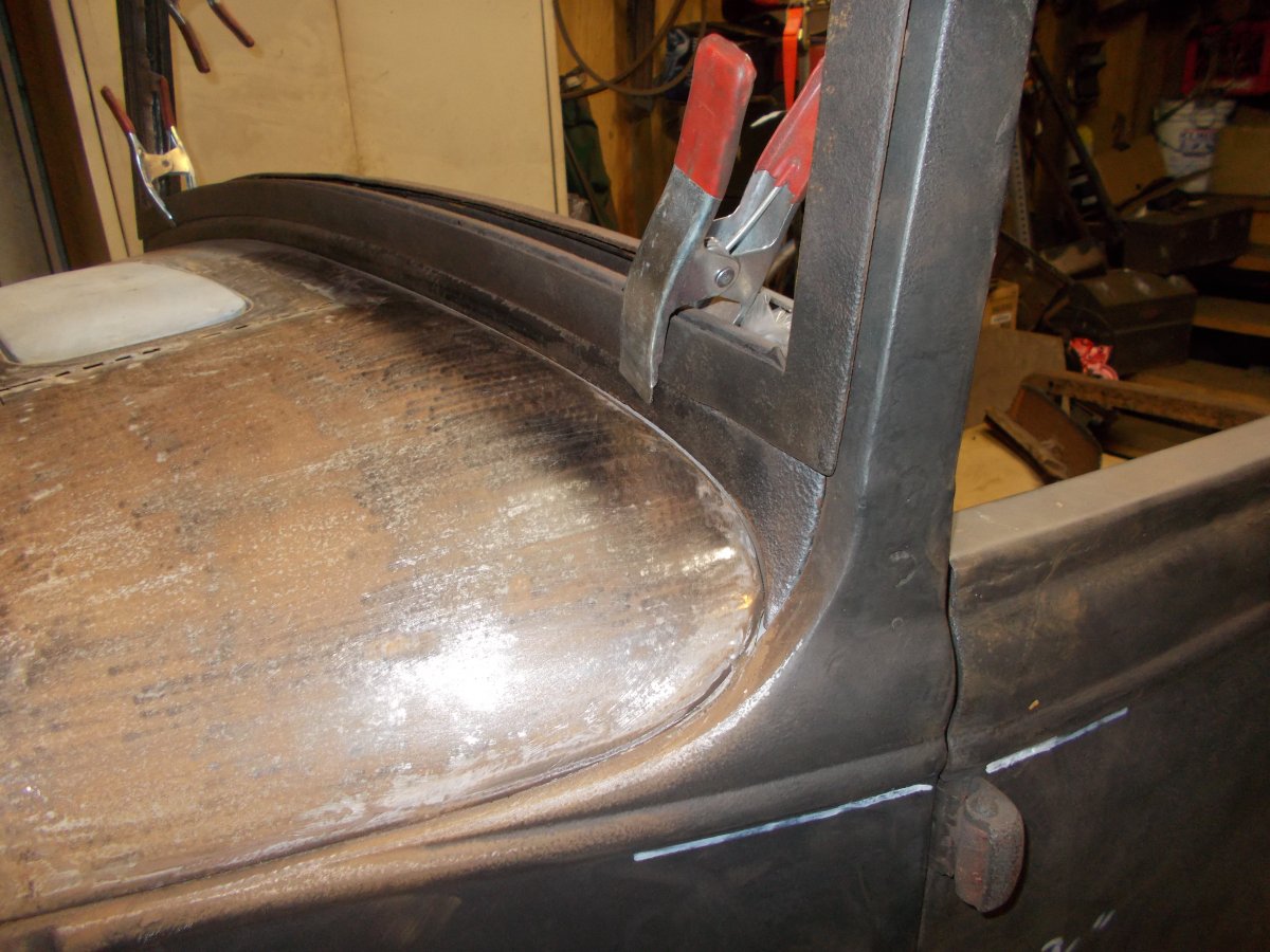

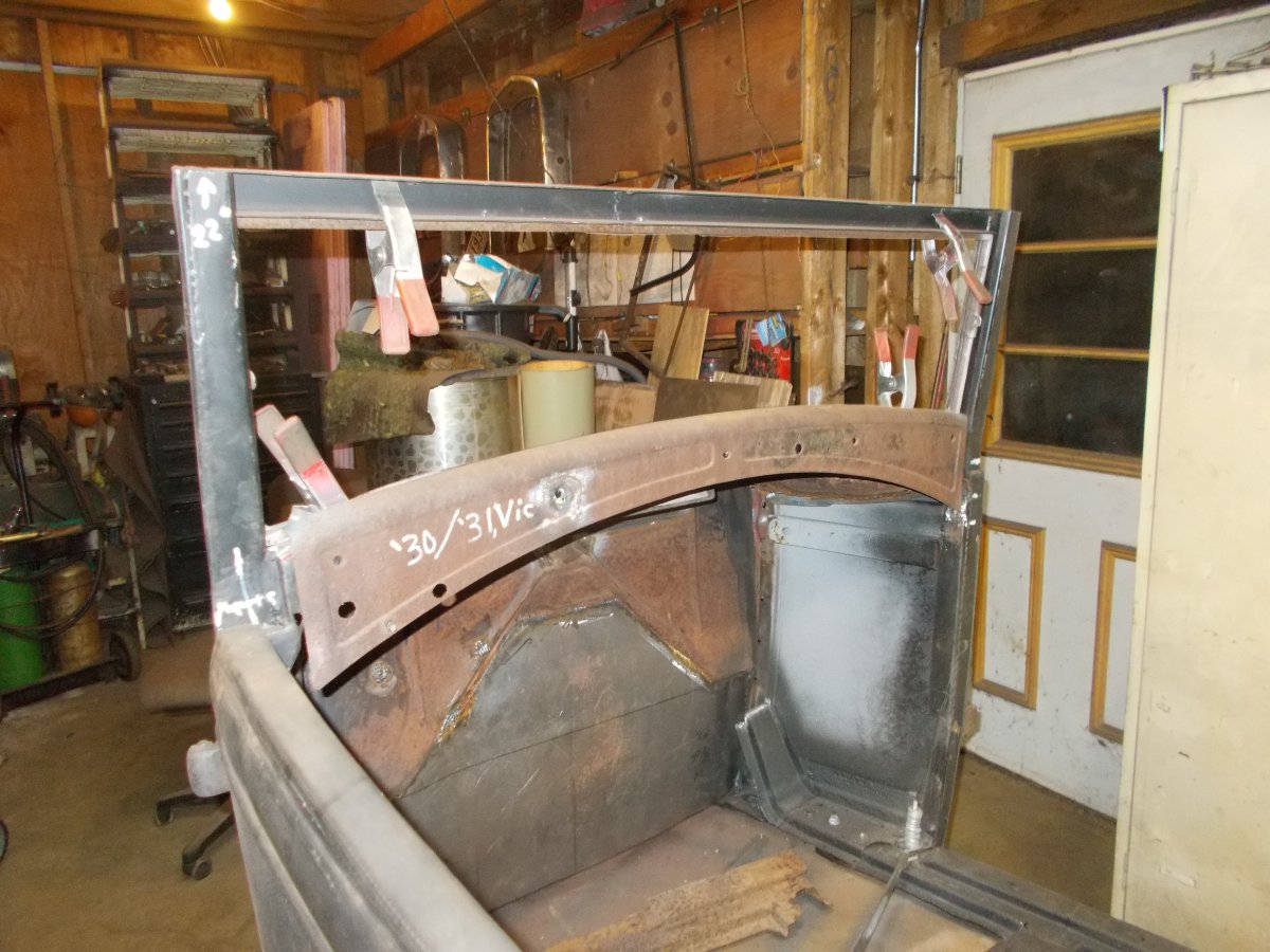

    When Henry tilted the w/s posts back in '31 he altered the filler panel in order to keep the bottom of the windshield frame flush fitting against the filler panel with out having to design a new w/s frame,
    s/w is the taller of the 2 in pix #1 and #2...
    which he made taller with the required altered ridge , letting the w/s seal along the bottom even with the tilt.... try it and see, this is not my first coupester… DSCN3763.JPG DSCN3764.JPG DSCN3772.JPG DSCN3776.JPG

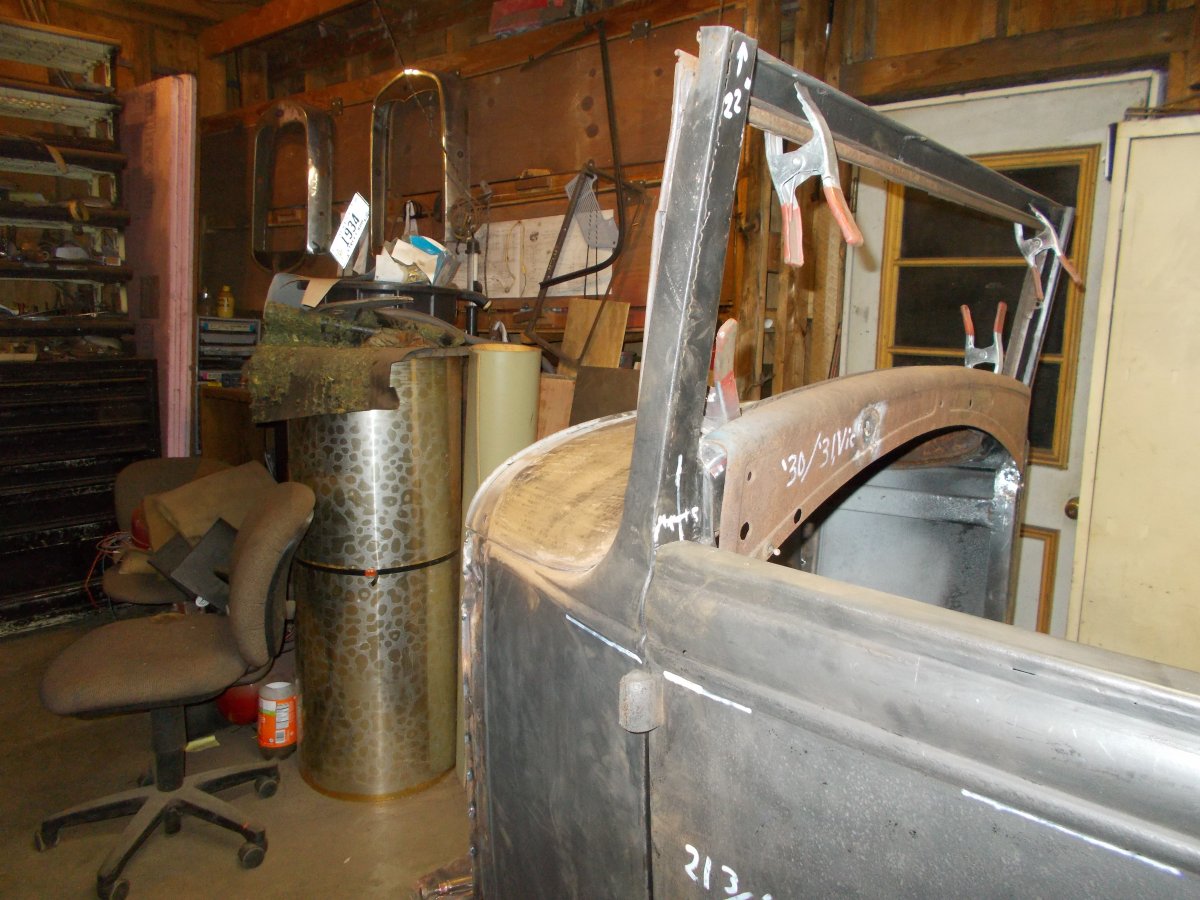

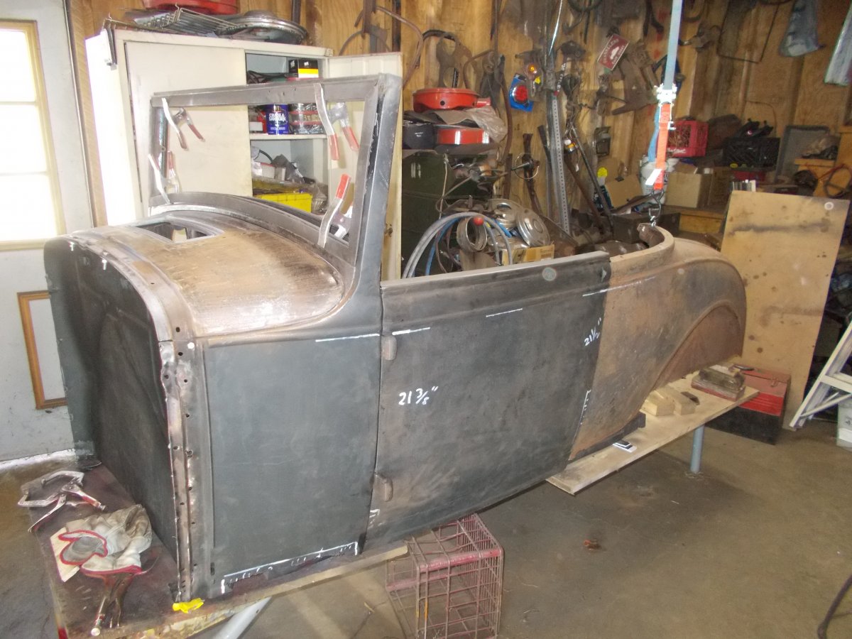

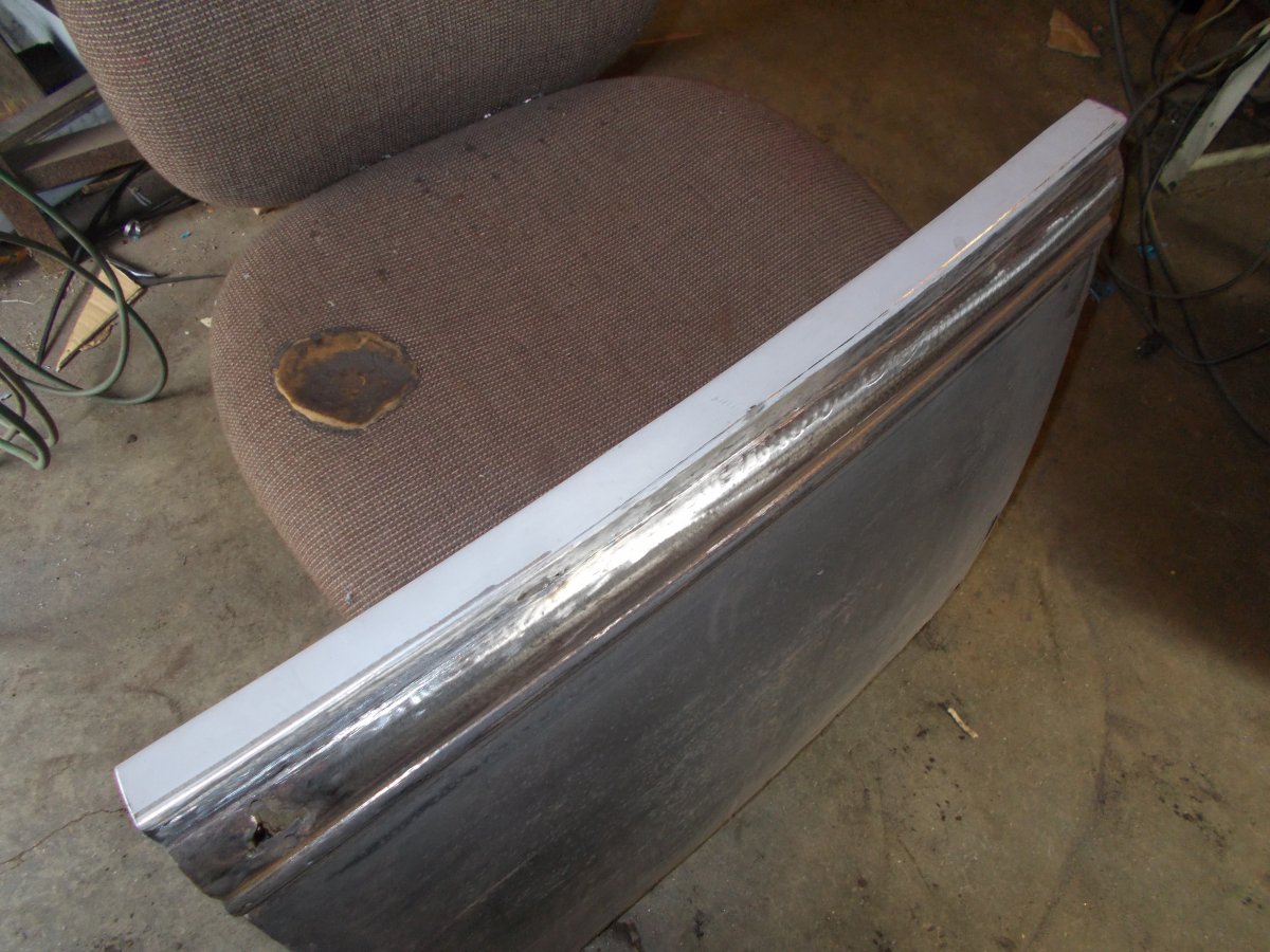

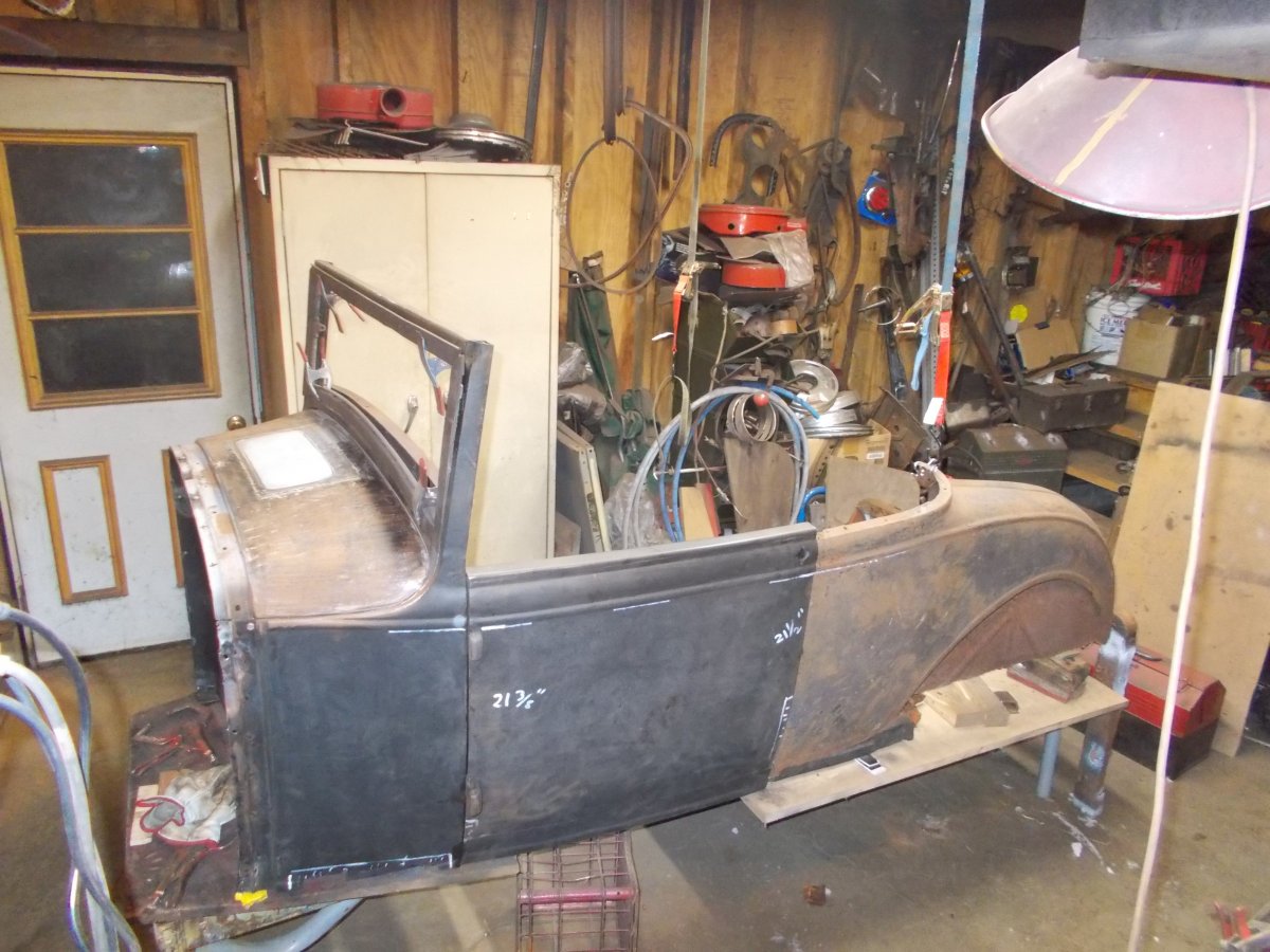

  22. sloppy jalopies
    Joined: Jun 29, 2015
    Posts: 5,256
    sloppy jalopies
    Waiting for the 12" plus storm ...

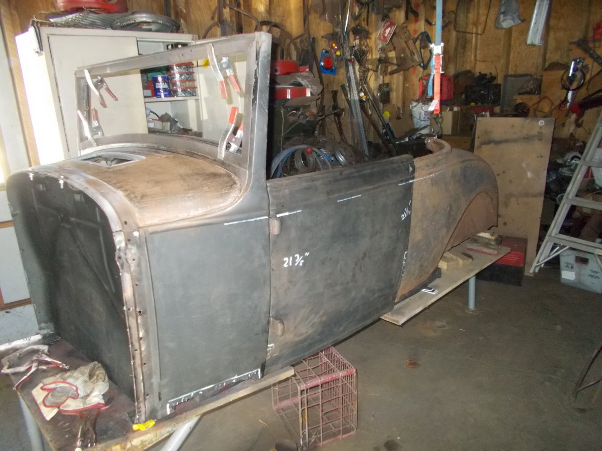

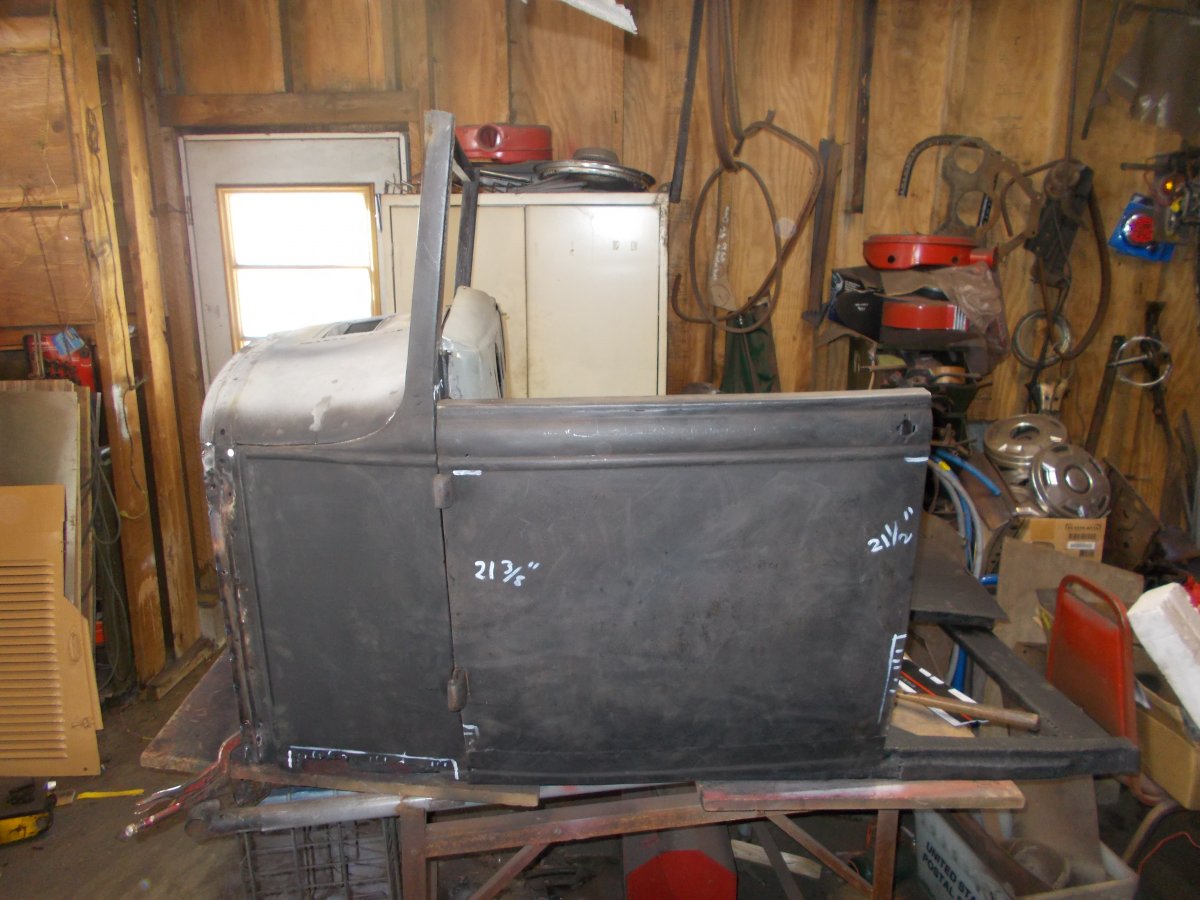

    blocked and tackled the B pillar and rear quarter...
    couple 10-32s through the skin and B pillar...
    going to weld a few inches of the leftover door "caps" onto the quarter so the door and quarter flow at the elbow rest and the jam...
    looks like it is gonna be ok... DSCN3788.JPG DSCN3783 - Copy.JPG DSCN3784.JPG DSCN3787.JPG

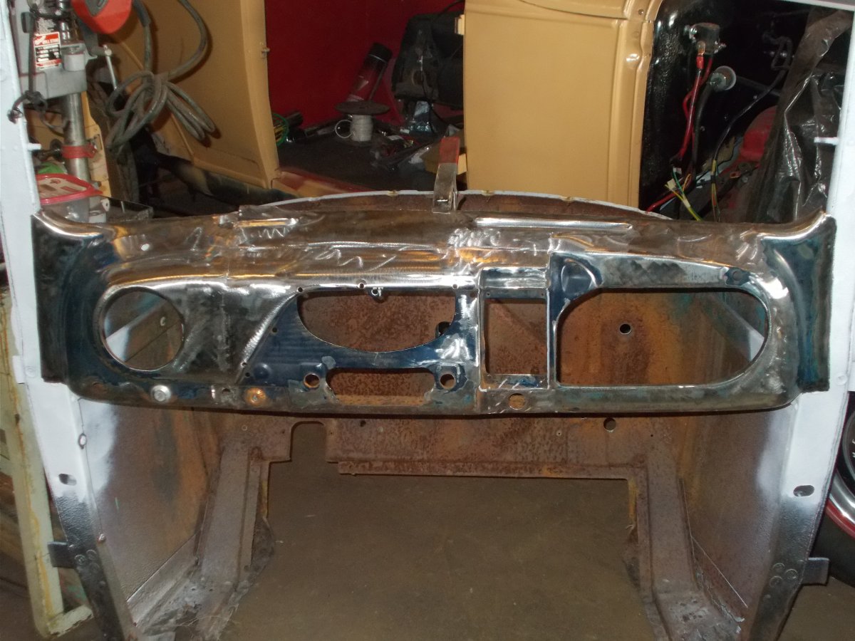

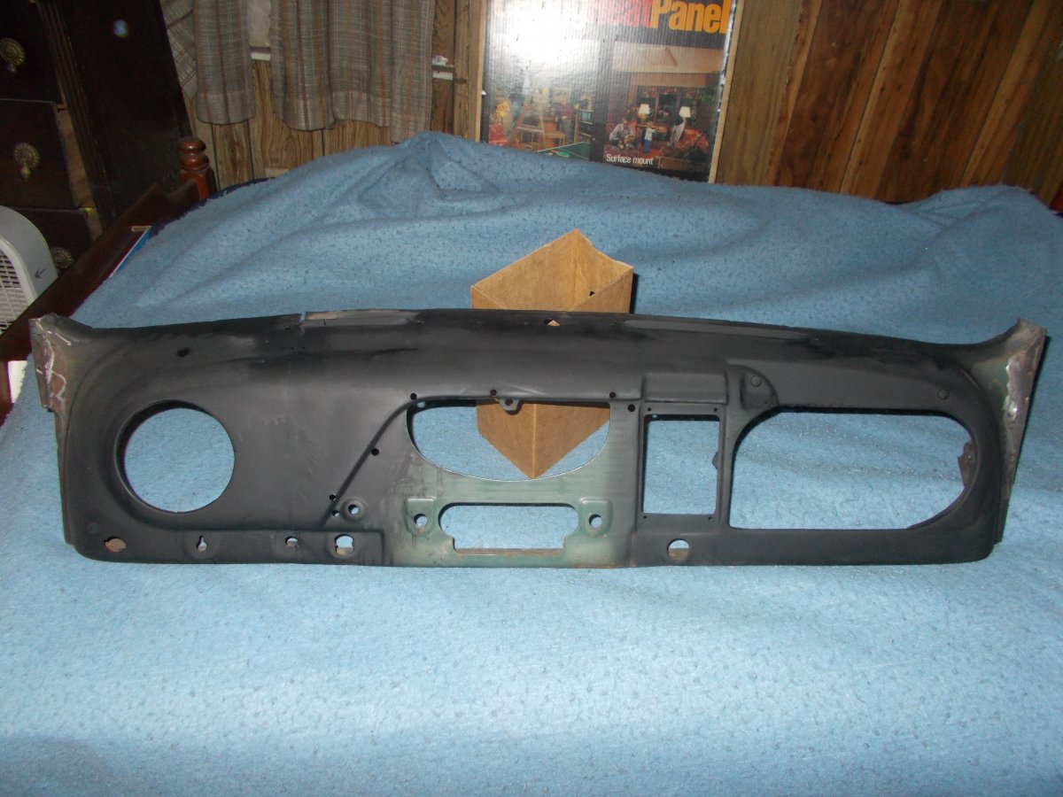

    I also have a stock '51-'52 truck dash..
    top 2 pix of a stocker to be rodded...
    one pic is of another dash I narrowed, [cut out gauge cluster] butted it back together…
    other pic is the '51 dash in a closed car cowl..
    it smoothly flows from the A pillar out to the dash's configuration...
    if lowered 1" it might do the trick... have to cut it up just to see how it fits... just went down to the shop an grabbed the '51 dash so I can mark it for cutting...

    Dropped the coupester's dash bar till the dash looked …. "better"...
    narrowed the '51 dash about 3.75" …
    still got to fill part of the former speedometer hole and play with the outer flanges...
    need to make new mounting brackets, but a '37, '38 or '39 car or truck speedometer will fit in the 51's gauge cluster hole...
    '51 gauge cluster and speedo have different mounting bolt patterns... so I would have to change the mounting bolt pattern anyway...
    by lowering everything and the dash being taller it sets the column lower... may need to weld in a chunk of exhaust pipe at the column's angle...
    should buy back a couple inches of belly room...
    DSCN3801.JPG .
