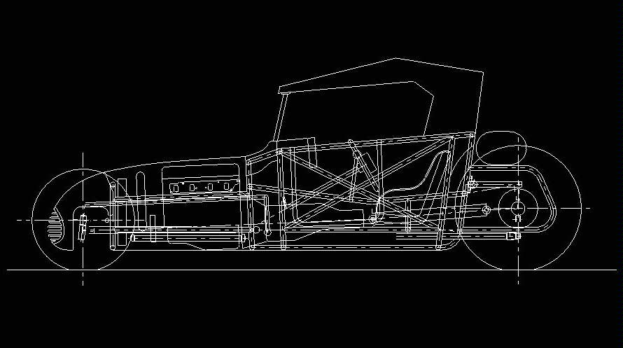

  9. My "T" project is similar. It will be midget stuff from the "T" cowl/firewall forward (Iron Duke w/5-speed, midget nose/grille) and slightly widened and lengthened "T"-style body in aluminum over a birdcage-style tubular frame with full bellypan.
    I'll suspended it with sprint car torsion bars at all four corners and stopping will come from JFZ disc brakes all around.
    What you see is very preliminary....some small changes have been made. Ignore the top. :)
