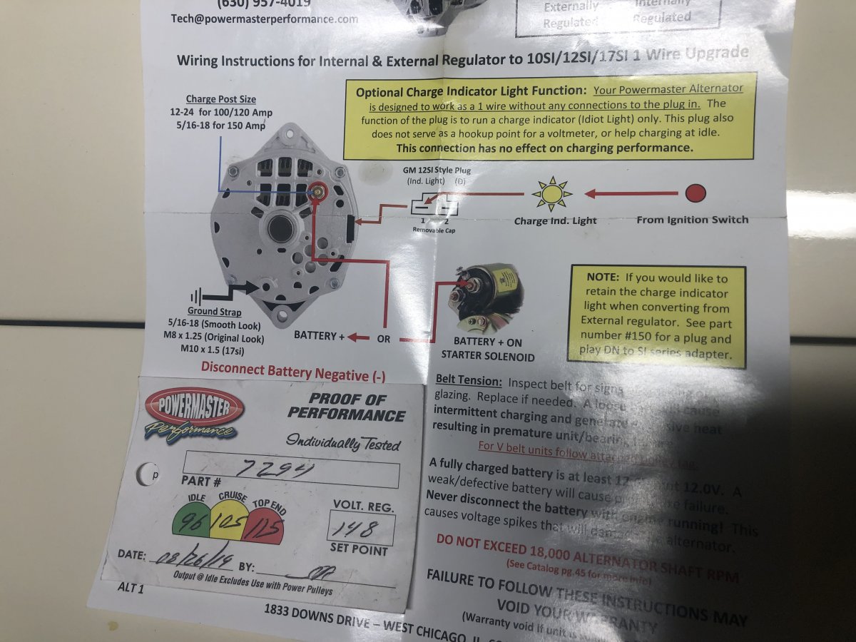

    The new PowerMaster I just bought come with a spec sheet and it had the ability to be able to connect an I-did-lite from the original car.
    It is a 100amp. My son has a clamp on DC Meter and with everything on in the car, AC fan on high. Headlights on high beam, radio it read 34 amps and 14.4 volts. Perfect to me. This reading was on the wire attached to the alternator and leading into the car. By putting the clamp on just the main positive cable the meter read 1.8 amp. To me this said with everything on the battery was still being charged.
    Yes the horn would have been more along with the brake/turn light but they would not have been a constant. Each stage of the fan speed dropped the amps.
    I’m saying this because the voltage never changed from the internal setting with nothing or everything thing on... I personally think 15vdc is too high but with your car at idle and about 1500 rpm see what a good volt meter shows connected directly to the battery.
    The spec sheet in the photo shows a voltage setting of 14.8 but on my volt meter connected to the battery it was 14.2-14.4. 57F7E780-9F94-4592-BCDC-7E37066FCAB8.jpeg
