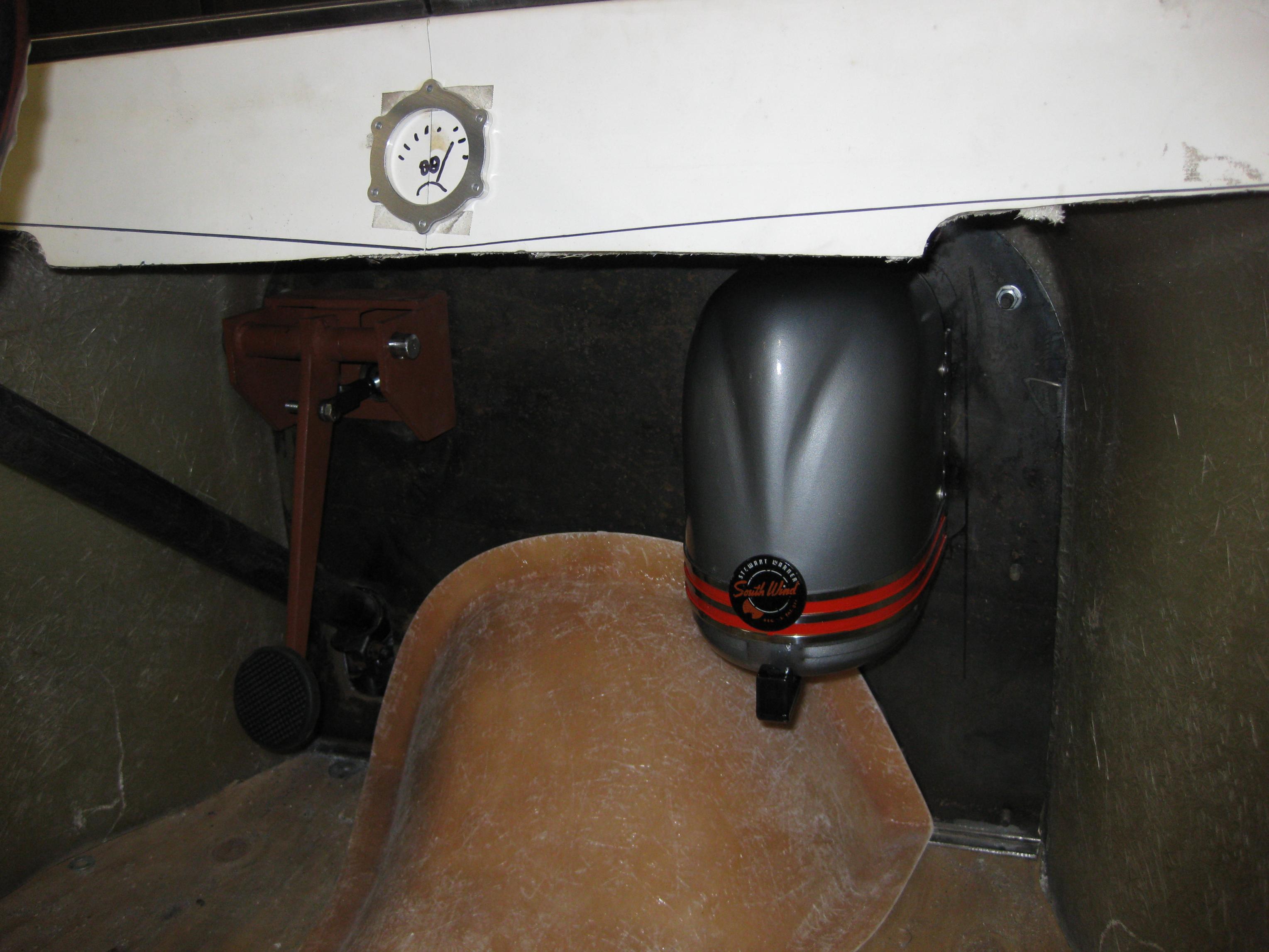

    Have you looked at the old Stewart Warner Southwind heaters, they use a fuel line "t'd" off of the carb, pretty cool little unit, mines gutted and acts as my battery box.
