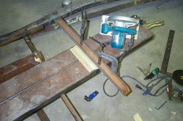

  6. I use a 7.25" carpentry circular saw with 7" metal cutting abrasive discs. They generate a lot of heat and that is hard on the saws. I use cheap pawn shop and Craigslist sourced saws for this. With a little practice and some clamped in place guides you can make some very accurate straight cuts.
