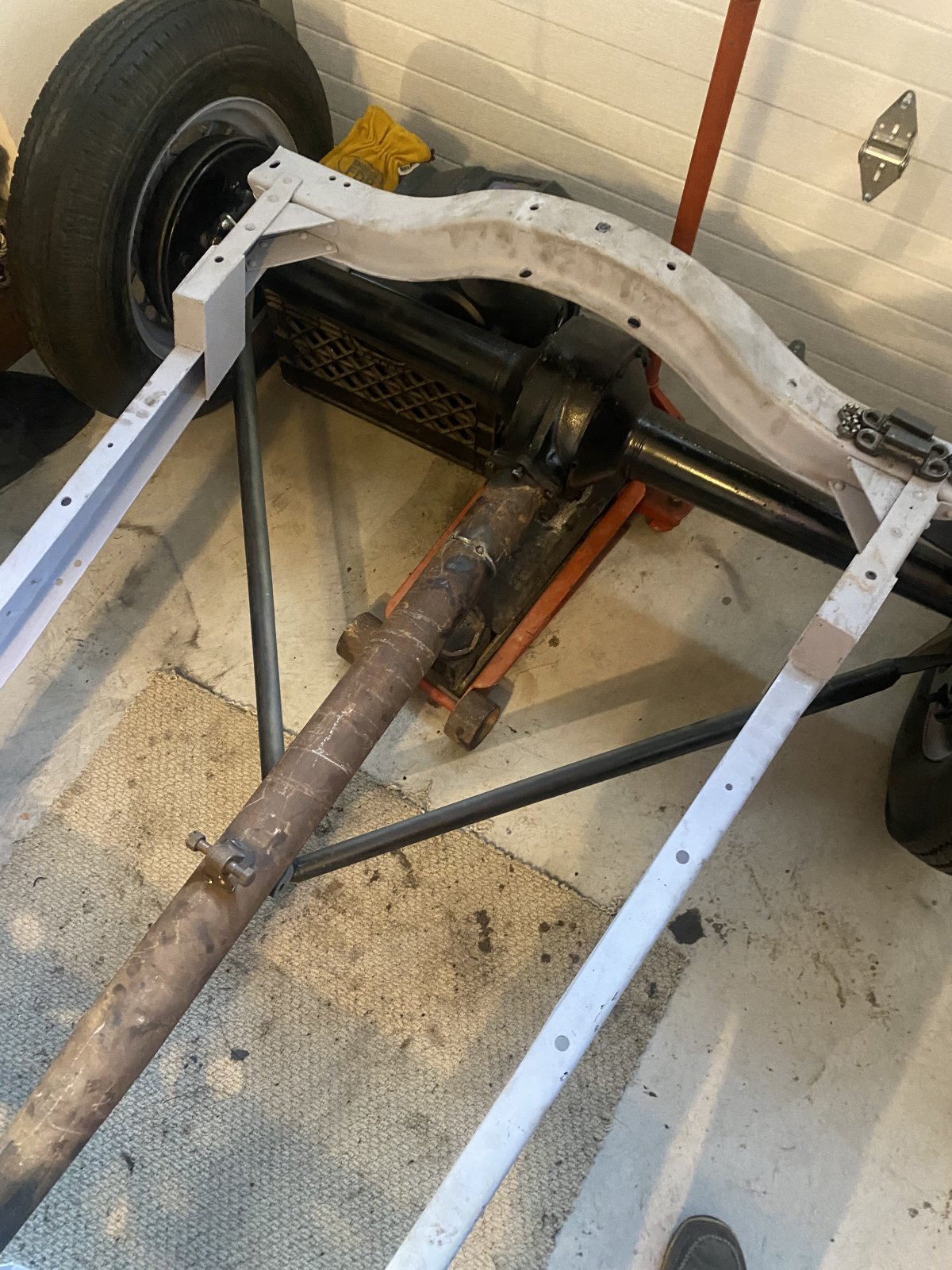

    Hey guys. I need to heat & bend my rear radius rods & a couple other items, but I don’t want to spend the $400 to buy an oxy/acetylene torch set up. Are there any cheap alternatives? I don’t think a handheld propane torch is going to be hot enough.
    Thanks

    No, a Bernzomatic would be like going big game hunting with a BB gun. Sure you don't want that torch set? I really couldn't get along without mine.

    Propane tank with a rosebud made specifically for propane (think roofer or gutter work). That's what I use. Not as fast as oxy acetylene but dirt cheap.
    Or a press if you have one.

    Radus rods can be bent cold in a hydraulic press, depending what shape you are looking for

    The only thing I can think of that I can personally attest to is using a TIG arc, with the machine set to high cleaning and a large gas lens to pull the arc further away, and use no filler rod. Basically use the TIG arc like a flame and use that to get the part hot enough to bend. But even that is limited in it's useful application because the arc is still tiny compared to an O/A flame and doesn't heat up large enough areas to bend a bigger part, plus I'd be using a $5000 machine to do the job of a $500 torch and tank set, so it's not economical in that sense either.
    Bottom line is you need the right tool for the job.

    I've used MAPP gas with a rosebud tip to heat parts to cherry red. It takes a while, and uses a LOT of gas, but it may work for you.
    OA is much faster and you should be able to find a used setup pretty cheap.

    Oxy/Propane works just as well as Oxy/Acetylene . Price for a torch set up for propane will be about the same, only difference in cost is acetyline is more than propane. Propane burns cleaner than acetyline, no black smoke when lighting it.
