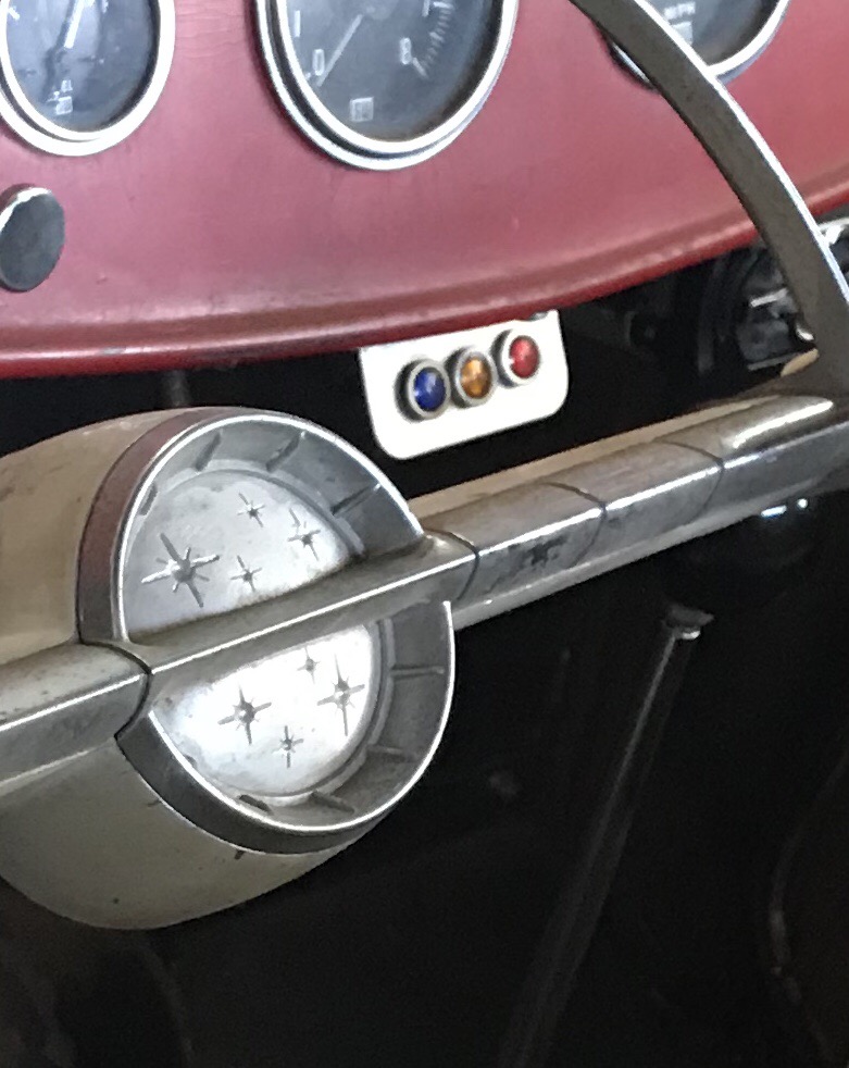

    7E74D402-41C2-4C9B-B056-699F96837D14.jpeg I run idiots.....just because,
    scrap metal 48 and Desoto291Hemi like this.
