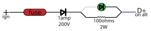

  5. brading
    Joined: Sep 9, 2019
    Posts: 841
    brading
    Here you go
    loudbang and scrap metal 48 like this.

    if a 100 ohm resistor will work, then use that.

  27. PhilA
    Joined: Sep 6, 2018
    Posts: 2,117
    PhilA
    There's a good reason for the LED by itself never going out, particularly on the 10si and 12si series alternators (and with alternators that have similar regulator packs).
    It's all down to the amount of current that the LED can p***. A regular 2 Watt light bulb will, at 12V forward voltage p*** 0.16 Amps (160mA). An LED is rated in the region of 20-30mA (0.03 Amp) at about 2.5 Volts. A "12V" LED that fits in a socket has an integral resistor inside to reduce the amount of current that's going to p*** through the LED at 12-14 Volts from a regular battery (or heck, even 6 Volts) else it turns into a little plastic fuse very brightly and quickly.
    So, when you switch on the ignition, with an incandescent bulb you are connecting 12V from the battery through the bulb to the regulator pack, via a transistor that has a Zener diode (electronic pressure relief valve, if you will, that conducts once a certain voltage is across it) connected to the "sense" wire that the regulator pack uses to determine if the battery voltage has reached fully charged.
    With the battery voltage greater than the output of the alternator, this transistor can sink current through the lamp and so the bulb has a path to ground and illuminates.
    Once the rotor is spinning, the base current to the rotor windings is determined by the current that is flowing through the bulb into the regulator circuit through a comparator transistor. Both these paths require about 60mA (0.06 Amp) to trigger the transistors into conducting. That's why revving the engine up will eventually trigger the comparator because the output from the stator rises above that of the battery with the base rotor current. At that point the output of the alternator meets that of the battery so the bulb no longer has zero volts on the other side and no current flows- the light goes out.
    Also, a side effect is that you have a very dead, crummy battery and rev the engine hard the output of the alternator is high enough against that of the battery and the gen light will glow- current p***es the other way through the bulb. An LED will not do that, by nature of being a diode.
    In short, the LED will always glow because inadequate current can p*** through it to trigger the regulator pack into correct operation. Placing a resistor shunt across the diode allows enough current to p*** yet not a complete short circuit that inadequate current flows through the LED to make it illuminate.
    This LED plus resistor method is what's used in modern cars, and it does work satisfactorily.
    So, if you MUST use an LED, that's the proper way to do it- wire a 100 Ohm 1 Watt resistor across the back of your idiot light terminals. (That's also why wiring a bulb in parallel with it makes it work).
    --Phil

  30. Redrodguy
    Joined: Nov 18, 2016
    Posts: 121
    Redrodguy
    @brading showed a diagram with a 1 amp 200v diode (post #5) before the LED and resistor. This may be a question for him, but what purpose does it serve?
