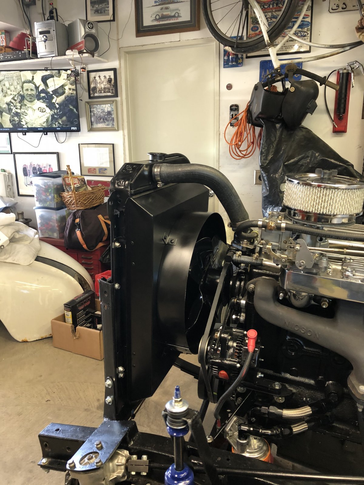

  4. chevyfordman
    Joined: Oct 4, 2008
    Posts: 1,488
    chevyfordman
    Any 80's or 90's Toyota alternators will work good and are so easy to mount. 427C9178-8FF6-410D-BB1A-A18330E1F8F8.jpeg

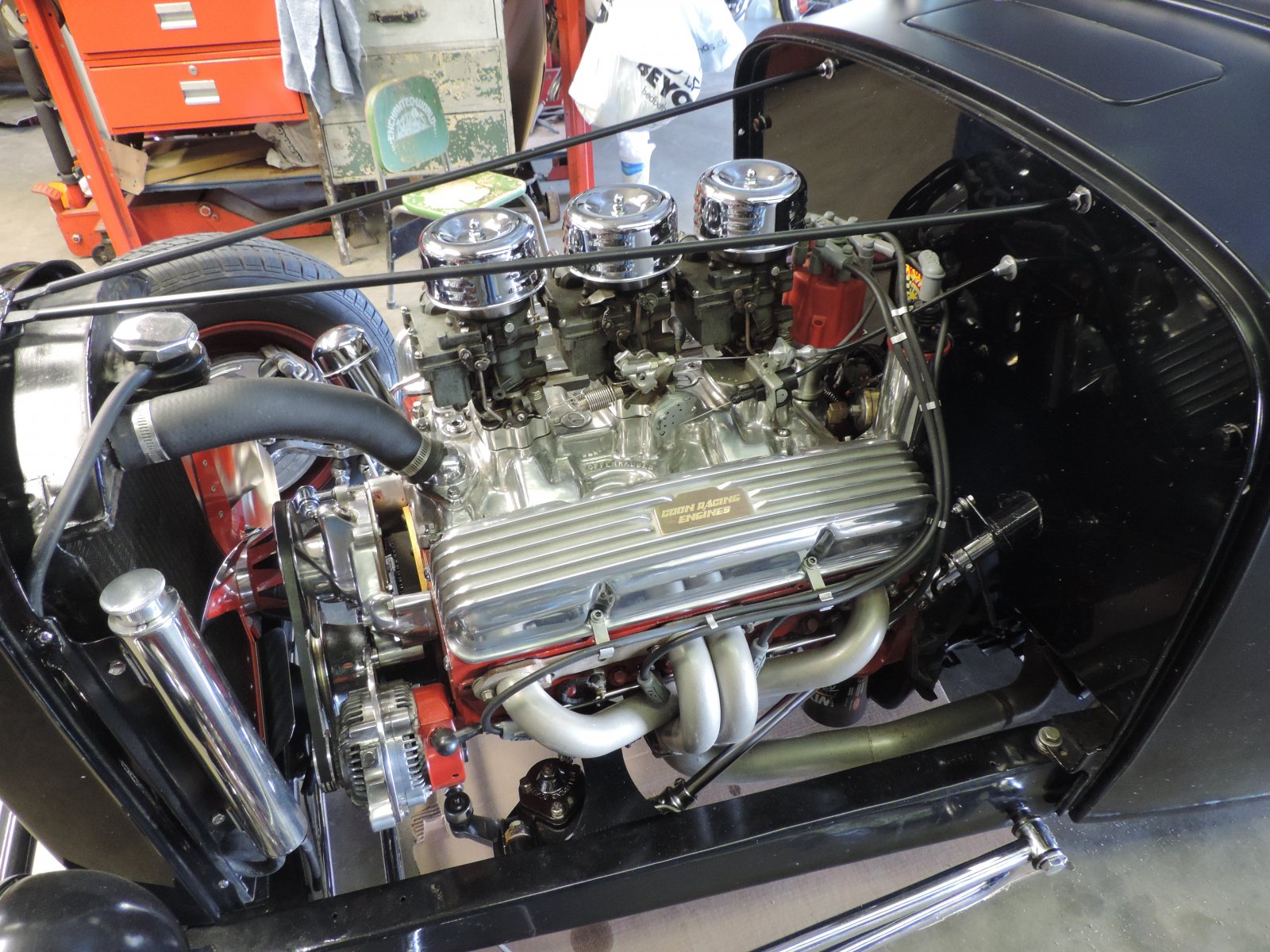

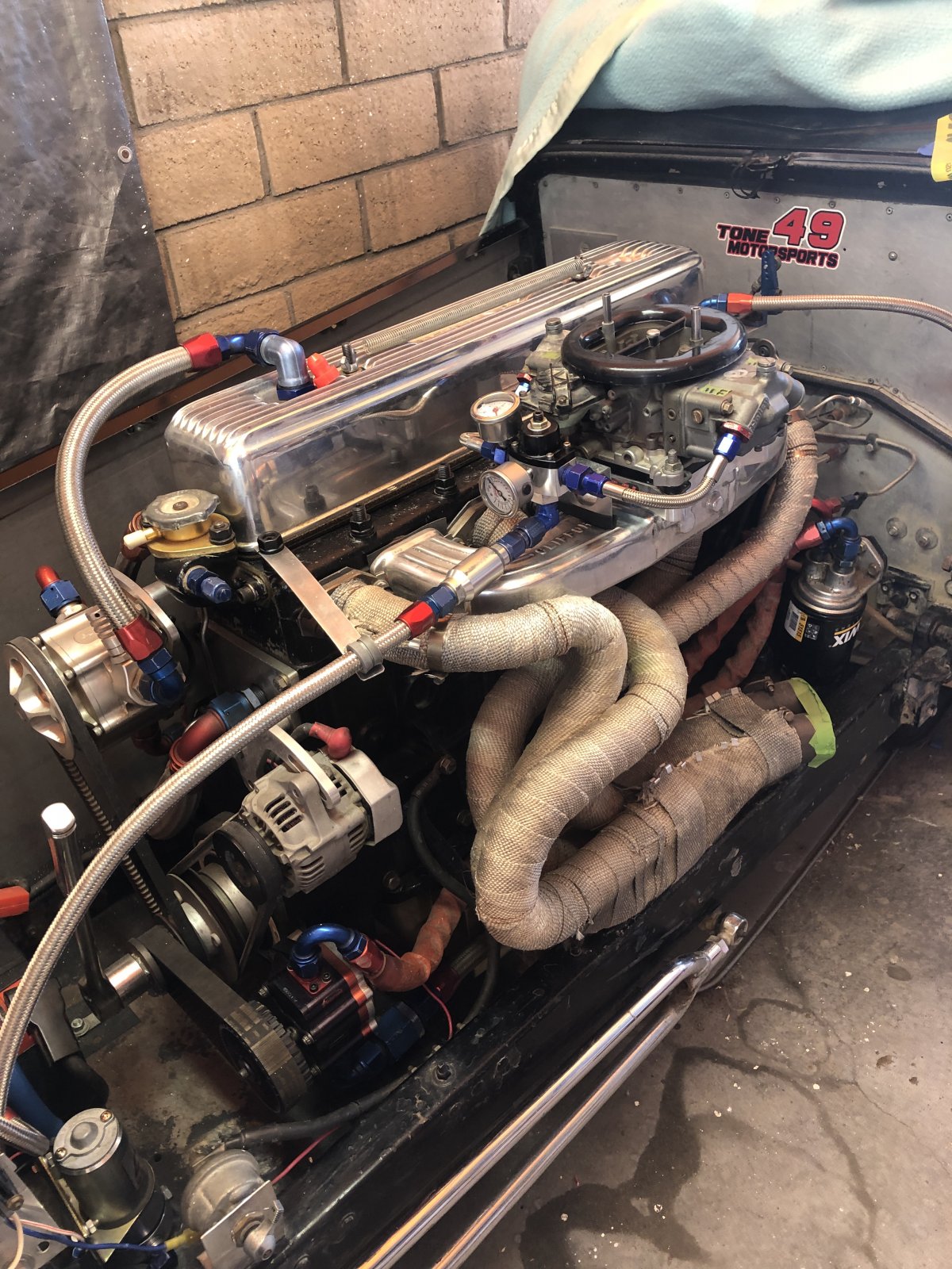

  7. jimmy six
    Joined: Mar 21, 2006
    Posts: 16,786
    jimmy six
    Yep. 3 of them, on Circle track Dart SBC that sees 7000 rpm, a 302 GMC that’s used on the street and the 302 in my LSR roadster which sees 6000, All single wire that connect on the starter solenoid lug. The SBC photo will get thrown off. The CT race cars turn crank speed and the streeter probably 2x’s like a normal engine and the LSR about 1-1/4 speed.

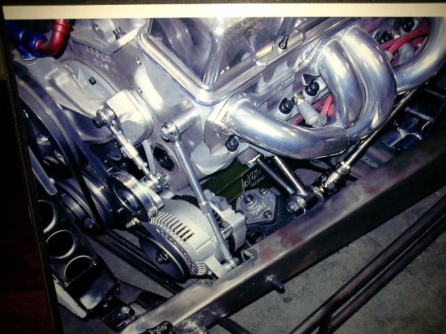

  8. DDDenny
    Posts: 21,722
    You may not want to cut into your framerail like I did but this was my answer so I could use the Ford Motorsports alternator I chose.
    The decision was made only after trying the two possible mounting points on the alternator housing and the direct to block mounting (with one small spacer) and related pulley spacing.
