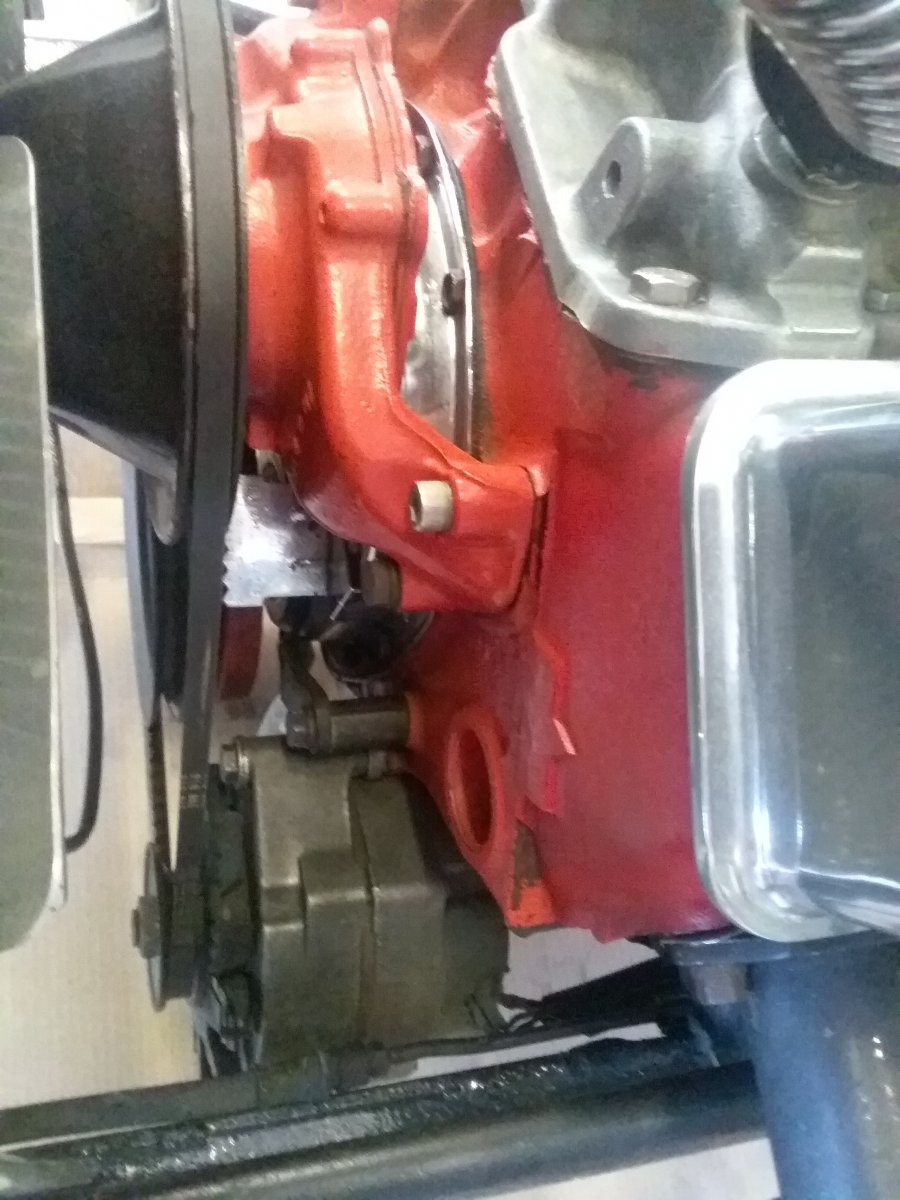

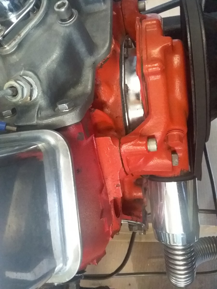

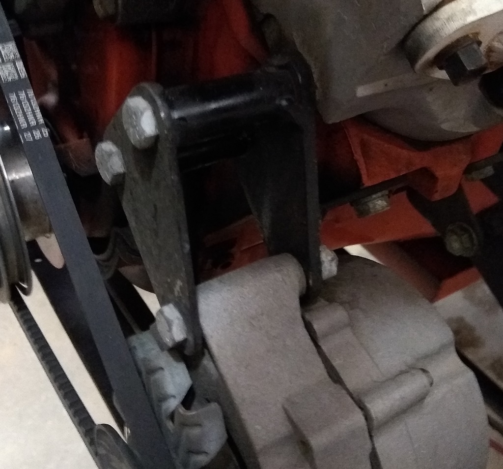

    Looking for a proper way to mount my alternator on my T. Right now, it's got two adjusting brackets bolted together underneath, besides being just wrong, makes it floppy... the adjusting brackets I've seen seem to come from above the alternator and I think would hit my frame. Any suggestions? I would like to keep it low, but will mount it above if necessary. The engine is a '66 283 with no threaded holes in the heads. 20190603_172019.jpg 20190603_172034.jpg

    adding another spacer to the top bolt, and a short plate between the two bolts, right in front of the alternator, would make it pretty stout

    Am I right in ***uming that I need a long water pump to use a top mount?

    Yes unless you find a aftermarket setup.

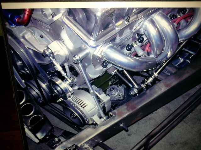

    this is on a big block, but might give you some ideas? over 20k miles on it, never any problems at all and it has been revved past 6500 too many times

    The long water pump used a p*** side alternator mount, and used the holes in the head. The driver side alternator mount for the short water pump used brackets on the exhaust manifold and no holes in the head, or the later ones used the holes in the head and a different bracket. There were a couple different designs of brackets to mount to the manifold, or headers, you can buy aftermarket setups like this pretty easily, the alternator hangs out a ways though.

    jimmy six
    Directly to the block with a spacer and a bolt will break the bolt. You need a mount like Jim shows..

    Roger that guys. I will do a search for a driver's side mount. The big block mount style would hit the frame.
