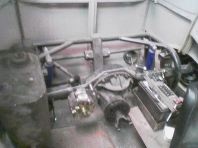

  16. i did it on a 1930 Ford roadster i built back in the 80's for my father. it worked just fine....of course as has been said i won't charge standing still. with a basic car it was never a problem. as soon as you started moving from a stop light it would charge again.
    so, if you would ask me why did it?..i would say because i could. i have never done it again since that. my advice for you young bucks is to go ahead and do it...once....so you can say you did

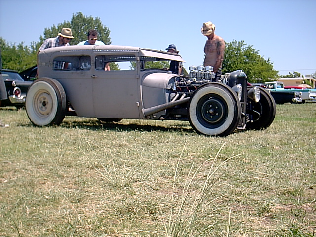

    I built that car at my shop.

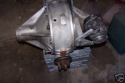

    Like Yekoms said Jones Racing Products make a nice set up and also Powermaster Performance has them under Circle Track Kits. Also in San Diego you can try Barrett Engineering that builds a alternator inside the water pump pulley (619)239-0037, the web sight is www.racemate.com

    We run a Sprint car with a Alt mounted on the Quickchange. It's been done for years without any problems. Ran a set up like that on the street in a bare bones Model A also without any problems.
