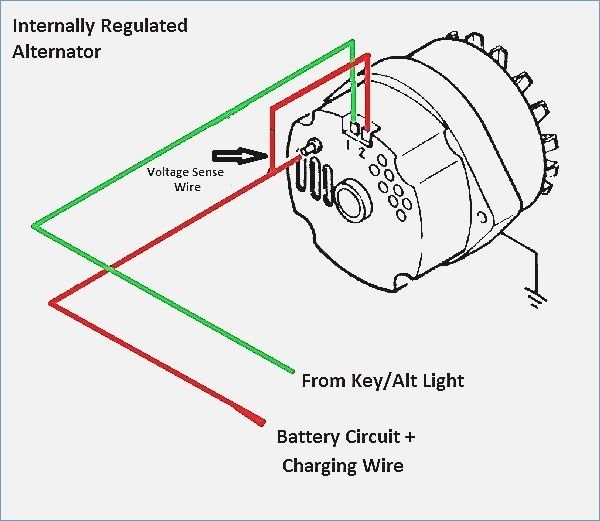

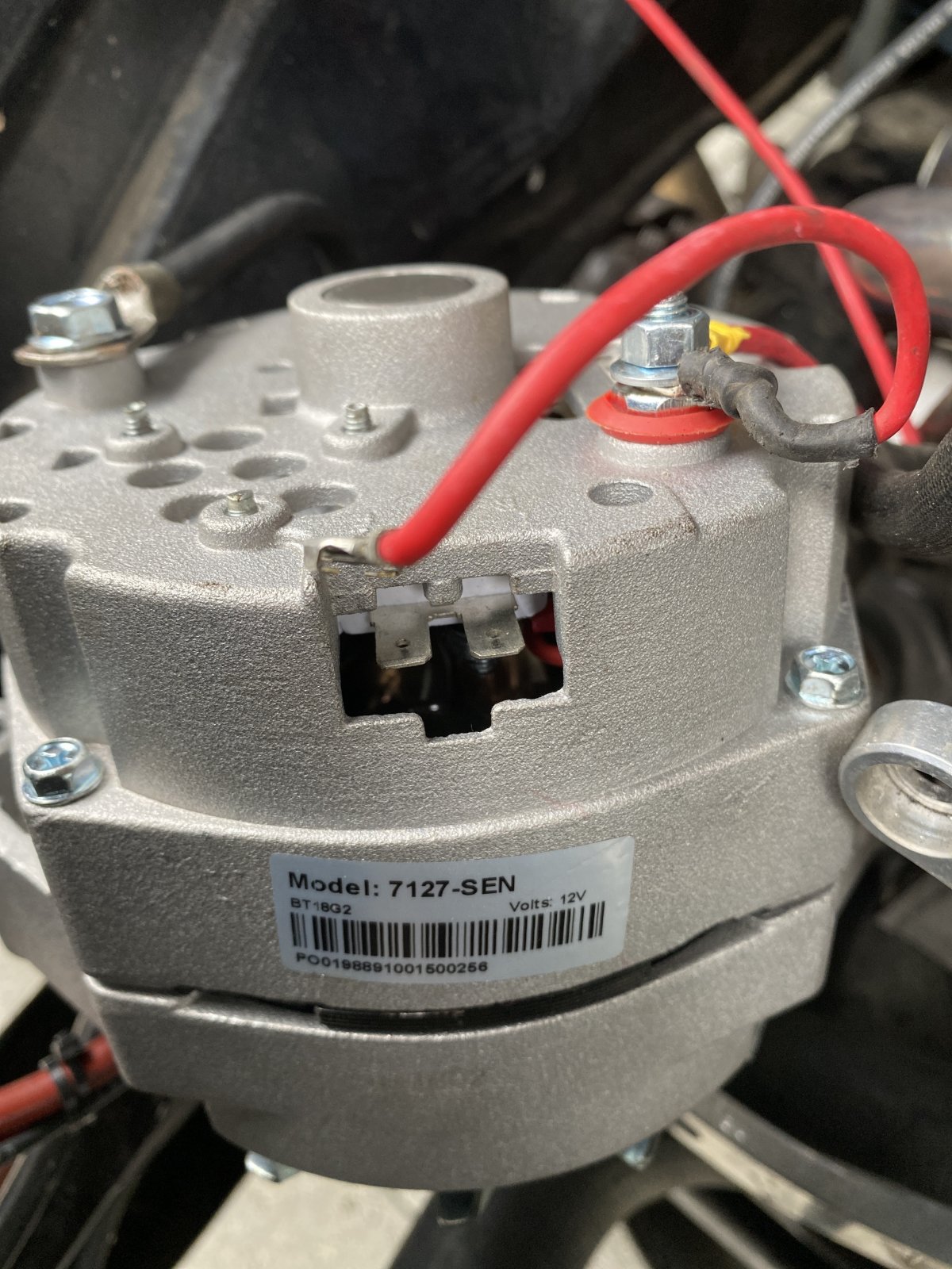

    Hi so I’m having issues with my 63 c10. The alternator will not kick in and as a result I had a flat battery the other day after a nighttime drive.
    I have bought a new 3 wire gm si series alternator. I’ve wired it correctly the same as my old one which ran for years like it . Pin 1 is to exciter pin 2 12v bat and then that goes to the power output on the back with a bat cable that goes to the starter.
    if I remove the bat cable whilst running the engine the generator emits power but when I put it back on to supply the truck it dips off as if its straining under load but I believe still running as it should. But I only see 12v at the battery.
    did some digging and the exciter wire when ignition is off is constant 12v live and it’s travelling down that wire from the alternator to the fuse board and into the accessory loom so powering my radio etc with ignition off ?! If I unplug the exciter wire under dash radio goes out and then will work as it should when you turn on ignition.
    So my question is should I have 12 v coming from the exciter on the alternator when it’s not running ? I don’t think that’s right and why would it happen? And I also read that the exciter needs over 12v to excite the alternator is that true ?

    Is this how you have got t wired up. You should have no voltage coming out of terminal 1 when it is not running.

    Yes that’s excaxtly how I have it . I just don’t get it unless somthing is arching on the plug I have no idea. It does it on my old alternator and new. And that’s with engine off key off. If I disconnect it under dash I get live from the fuse board with ignition on engine off and live from alternator. Switch ignition off and alternator wire stays live and so powers all my accessories it’s mad. It’s a new loom etc also American auto wire one.

    I believe wire #1 should go to the battery so it reads the condition of the battery, not connected to the output wire as that makes it a 2 wire alternator. JW

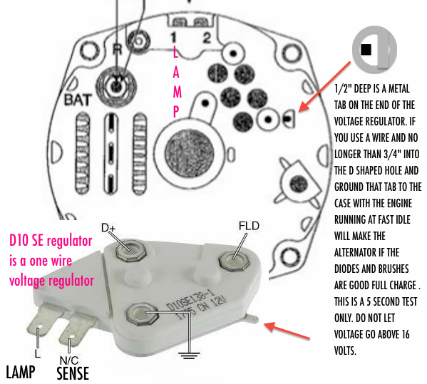

  5. Aside from wiring schematic, I ran across this once. Some rebuilders leave a pin in the case to hold the brushes up, while re-***embling. Check and make sure it's still not there.I don't have a picture, but should be able to find location for the hole, online. I've use a toothpick to ***ist me in the past. It's removable, after ***embly.

    In the diagram above, the green wire should come from the "gen" light or an "ignition" source.
    I'm not sure that attaching the "bat" terminal wire from the alternator to the starter will be an issue. But to be sure, I have mine attached to the battery.

    That exciter wire should be a switched ignition wire. You could have a problem in your fuse board. Are you running a charge indicator light? Does it function properly?

    I have a Painless wire kit, so not sure if wire numbers would be the same, but it should give you the general idea. The 914 wire is the exciter wire.
    From my instructions:
    CHARGE INDICATOR LIGHT Those wanting to add a charge indicator light will need to re-route the WHITE #914 wire found in the Alternator Section of wires. This wire will be connected to the light and then out the other side of the light to the alternator voltage regulator. The way the light will function is this: Electrical current moving from the fuse block, through the filament, and out to the alternator causes the light to illuminate. This light illuminates when the key is in the ON/RUN position and the alternator is not charging because the engine is not running or when the alternator is not working properly. Once the alternator is charging, the voltage regulator no longer needs the switched ignition voltage supplied by the #914 wire, which stops the current flow. Since power is no longer flowing through the filament, the bulb does not illuminate.

    I know the hole your talking about but it does kick in and work IF I pull the bat feed on the alternator off and you can hear the change in alternator noise when you do . But when you put the bat cable back to the stud on the alternator it dips off. I don’t think the alternator dies off I think it’s loading off somewhere I’m just not sure where

    So I’m back home now working on it . And the power from the batter at terminal 2 is getting to the exciter wire by link between the two spade terminals on the alternator ? Is this right ? Can’t be surely.

    The lamp wire needs a #57 lamp in the circuit or a diode . That terminal will back feed . You should NEVER operate an alternator open circuit !! You may have toasted the output diodes .

    I’ve hooked u the main power to the stud as before and then from there the power supply to terminal 2 . And removed terminal 1. The alternator now fires up with power. 16 volts I’m getting IF I unhook the power from the back of the alternator stud as soon as I reconnect it struggles and the charge isn’t great enough to charge the bat so I’m guessing it’s shorting out !? No burn smells though

    (1) The green wire should go from I terminal ( ignition terminal ) on the ignition switch to the number 1 terminal on the alternator sometimes via a charge warning light. It sounds to me that the green wire at the moment goes to the A terminal ( accessories terminal ) on the ignition switch which is why you are getting accessories on with the ignition off.
    (2) Sound to me like you have a faulty regulator in your alternator as there should be no feed out of terminal 1 when the engine is not running. This is how it should work. There is no power coming out of terminal 1. You turn the ignition on and this feeds 12v to terminal 1 on the alternator lets say via the warning light ( makes it clearer to understand ) this goes to earth in the regulator so your warning light comes . You start the engine the alternator build up power then basically turns the earth off and sends 12v via terminal 1 to the green wire. Now you have 12v coming from the ignition switch and 12 v coming from terminal 1 alternator. Now you have 2 opposing 12v volts which cancel each other out so that you have no voltage in the green wire, no power to the charge light and it goes out.

    Terminal 1 is connected to the excited wire one the American auto wire kit. It plugs in under the dash. And that then goes to the same feeds in the accessory’s loom . The problem isn’t that though it’s the cross link on the alternator on the picture in the last post. It joins 1 and 2 together which gives that look a permanent feed. Which I’ve never seen before!
    I understand how the light works. It basically won’t let the bulb have an earth so long as the current Is equal both sides otherwise the light will be dim or even bright when off.
    The alternator now comes on with out the exciter wire hooked up and runs strong but as soon as I hook the power lead to the back of the alternator it seems to die off. That’s the next problem.

    I live in he Uk . I bought it off a guy over here who’s had it for a year or so . Do you think cutting that link that connects the two would Benifit in anyway ?
    I’m now getting power from the alternator but as soon as I hook it up the alternator shuts off so can’t get the battery to charge.

    I think it’s wiring related because 3 alternators all do the same thing. It’s as soon as you hook it up to power the alternator dips off or the alternator stops charging altogether, I’m just lost with it . Still haven’t figured it out.
    I’ve wired an idiot light up for it and it goes right out to say the alternator is charging yet I only see 12 at the battery.
