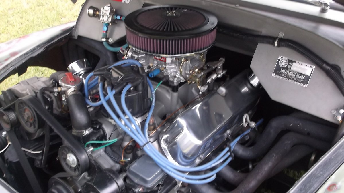

    Why not keep the Ford alt ? My old Morris had a 140 amp Lincoln alt. The wiring is simple. Note the regulator mounted on a cut down A/C and power steering mount bracket DSCF0955.JPG

  25. southcross2631
    Joined: Jan 20, 2013
    Posts: 4,412
    southcross2631
    Like I said a 140 amp Lincoln alternator will handle all of your electrical needs. A/C. power everything , electric fuel pump etc. Scour the salvage yards shouldn't be hard to find. I bought the whole car delivered to my shop for $ 500.00 off Craigslist and when I got everything off I needed.302 roller motor, AOD trans wiring and some other stuff. sold the car for s**** and got 200 back.
