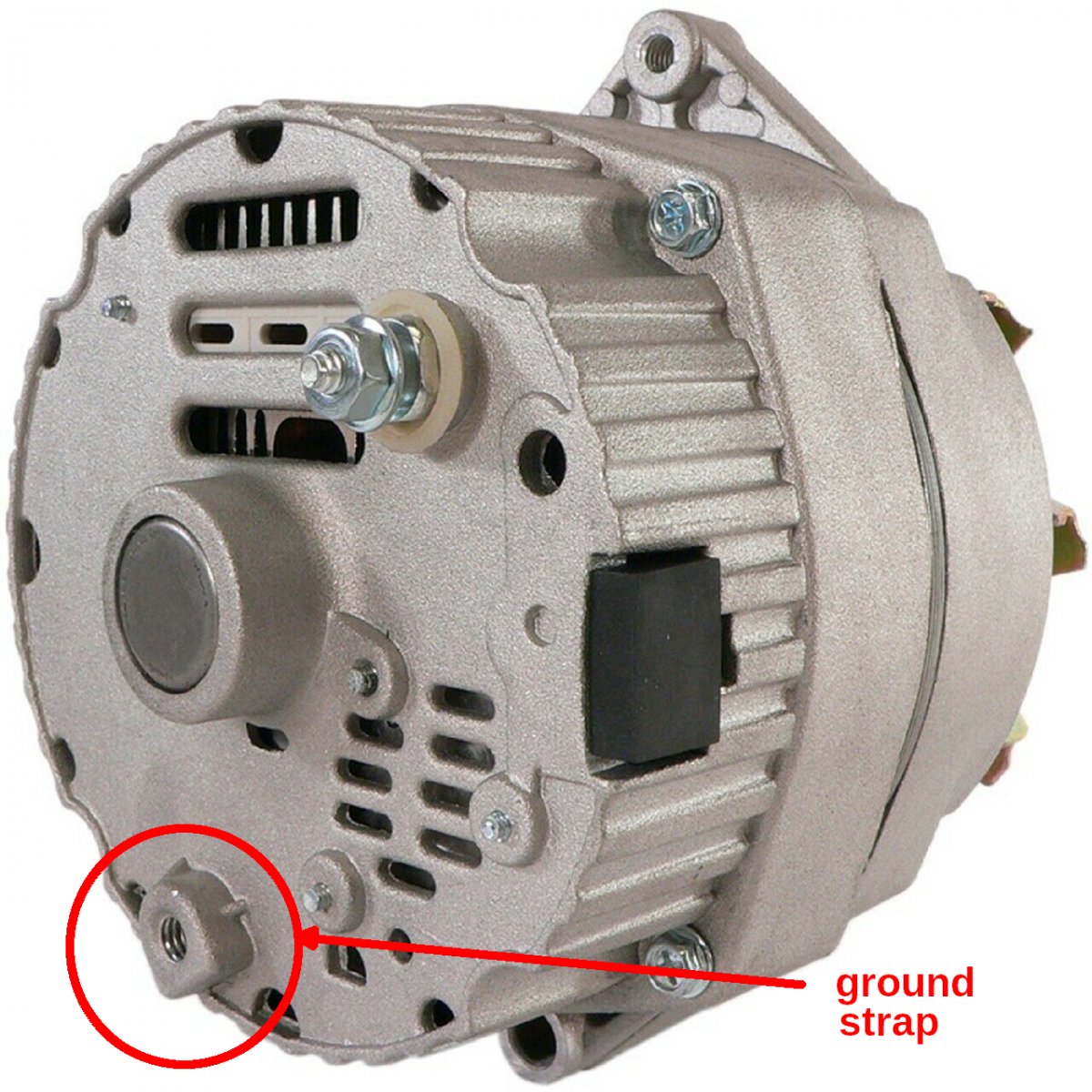

    It is also critical for good ground of the alternator with internal VR, as poor ground can cause increased voltage.

    38Chev454>>>It is also critical for good ground of the alternator with internal VR, as poor ground can cause increased voltage. >>>
    This. Install a separate ground strap to a good ground. That's what this threaded hole is for. The alternator mounting points sometimes don't provide a good ground to the alternator's aluminum body. Then quit monitoring & fretting over the alternator's output voltage with your multimeters. Your battery will be fine. Jack E/NJ

    I wonder where you got 12 volts from? I think you'll find lead acid batteries like to be over 13, when they're in a system doing work (ie the engine is running). If the system is at 12 volts, the battery is either discharged a lot, or will be soon.
    And that "ground strap" threaded hole on the back of the alternator, is for a mounting bolt, it's not for a ground strap. I've never seen an instance where a securely mounted alternator is not getting a good ground, unless perhaps it's one of the oddball ones that has vibration isolation mounting bushings. But then it would not be a 10SI alternator.

  26. If you've got a alternator with a powder-coated case and/or the mounting brackets are coated or even if it's all painted, it's possible to have a poor ground.
    I know that Ford used a separate ground wire from the alternator case to the regulator case on their externally-regulated units to prevent this very problem...
  27. squirrel
    Joined: Sep 23, 2004
    Posts: 60,088
    squirrel
    GM alternators, before the internal regulated type came along, had a ground stud on the back. I can understand having a ground reference for an external regulator. But I still have not encountered an alternator that was having trouble grounding the case to the engine.
