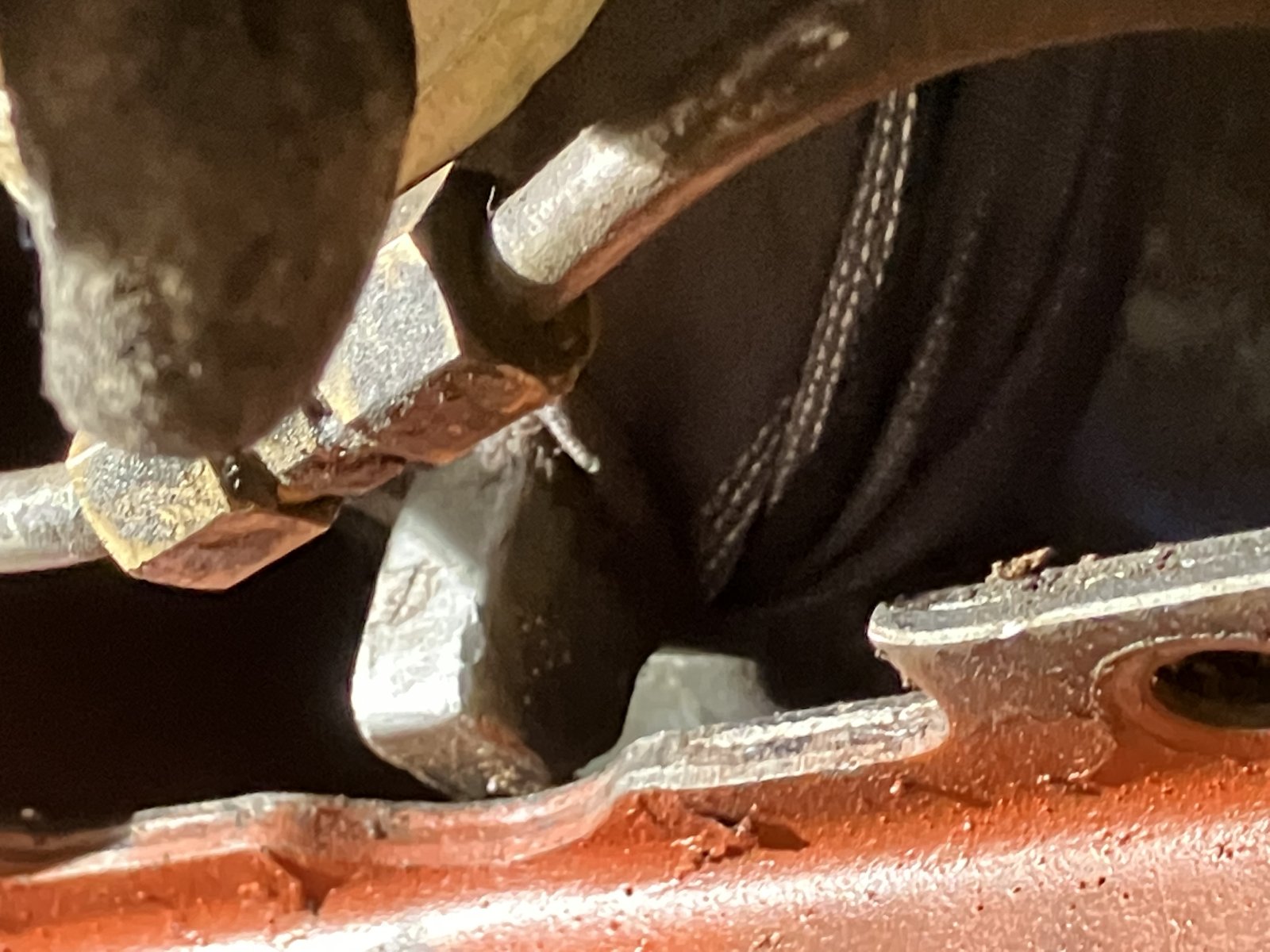

    EEBD6451-99D6-4921-B3F4-E0DD4C7E36BA.jpeg Theres a square pin under my alu powerglide Im wondering Whats for. And most important, is it solid or hollow. It argues with the hight, as it rests on a crossmember.
    Anybody know? Can it be chopped?

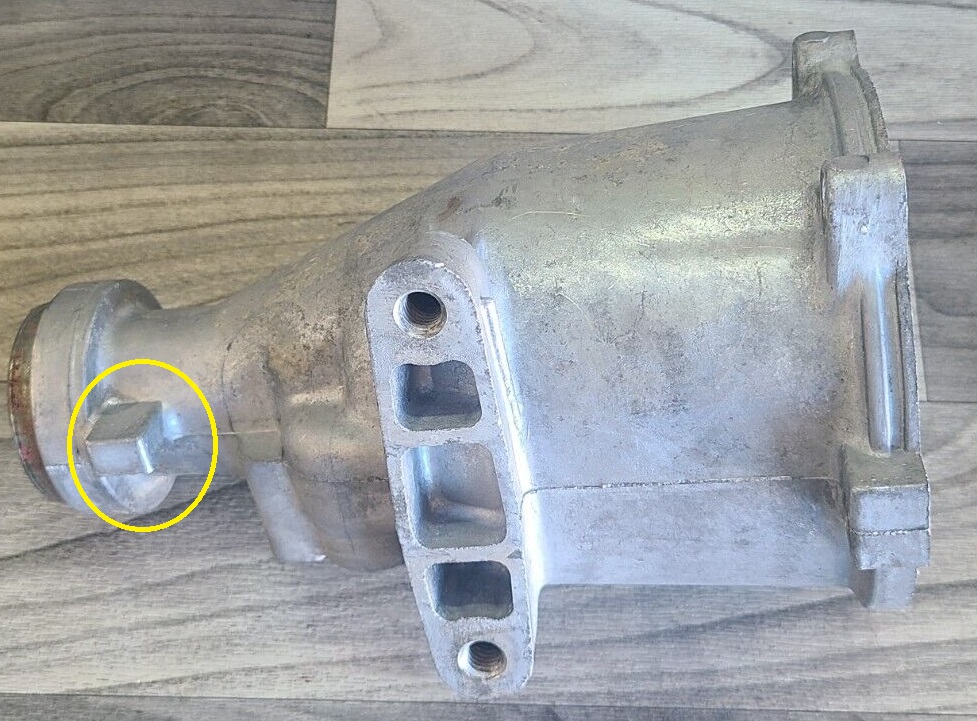

    Is it this part, in the yellow circle? Or something else? Hard to tell from your picture, you took the picture too close to see where everything is.
    I think that part is solid, and can be cut off. But it would be good to make sure that is what you are talking about, first
  3. LarsL
    Joined: Sep 28, 2012
    Posts: 317
    LarsL
    from Norway
    Thats the one yes.

    The orange portion had me :confused:. Never would I have guest it was the tail housing.
  5. You can remove it. I believe it was part of the fixturing one the ***embly line? If I gambled that is where my money would go

  6. LarsL
    Posts: 317
    LarsL
    from Norway
    What you see here is that pin squirrel has shown in yellow. It lays on my crossmember, that can look orange.
  7. LarsL
    Posts: 317
    LarsL
    from Norway
    I was also thinkin that, or a moulding thing.
  8. You can cut it off, it is solid cast aluminum.
