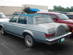

    I believe there are 2 or 3 styles of them. Some with small windows and some without. There may be more than one bolt pattern as the Versailles used a smoothie too. The biggest problem now is that so many of them have been melted.

    Nope, he means Lincoln Towne Car and Versailles. My buddy Krafty B has 'em on his '64 Caddy, they look killer. The big car wheels have the 5x5 bolt pattern, the baby Lincoln is the small Ford 5x4 3/4. Happy hunting...

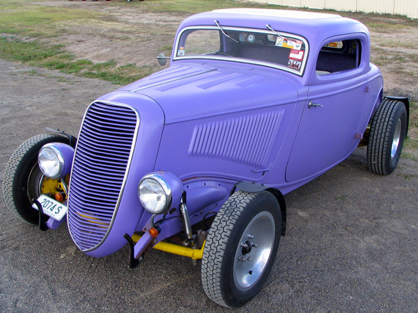

  13. All 15x6, some 5 on 5", some 5 on 4 1/2". Some had the small slots near the center - I always liked the solid ones and, years ago, I made a complete set into some pretty decent smoothie Halibrand lookalikes. Narrowed a pair to about 4 1/2", filled the holes and machined the lips where the center caps sat, machined off the wheel weight mounting lips on the front faces and gave them a light polish to look old. This was before Coker had their repop sprint tires so I fitted what I could find...

    These were Hemi Steves with the green tape attached.
