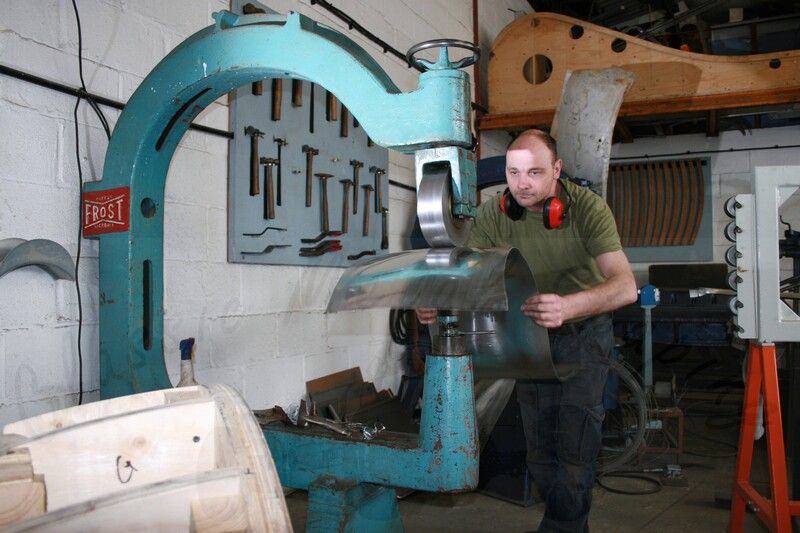

    Time to do some wheeling.
    I started to shape some sections for the rear wing.

  8. Mindover
    Joined: Jan 18, 2009
    Posts: 1,661
    Mindover
    from England
    We do! here we call it a wheel or wheeling machine. I have two and a little harbor freight style machine.
    here is my other one its behind me in the photo.

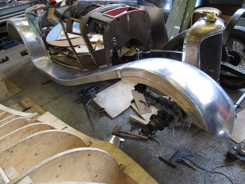

    The back section was wheeled next these were checked on the buck the flanges were marked and thrown and then shrunk to match the buck and the two sections welded together...
    Everything was double checked on the car as I went because this was the first set of wings made on the bucks and its easy at this stage to spot and correct any problems. It all fitted as it should...

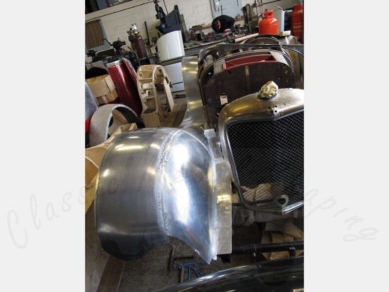

    I use only gas welding for aluminium.
    This is the two sections welded.

    I made these wings in the same way as the originals.

    Made the front wings in the same number of sections as the originals. all the parts were welded together using oxy acetylene welding.
    Wings and Bucks...
