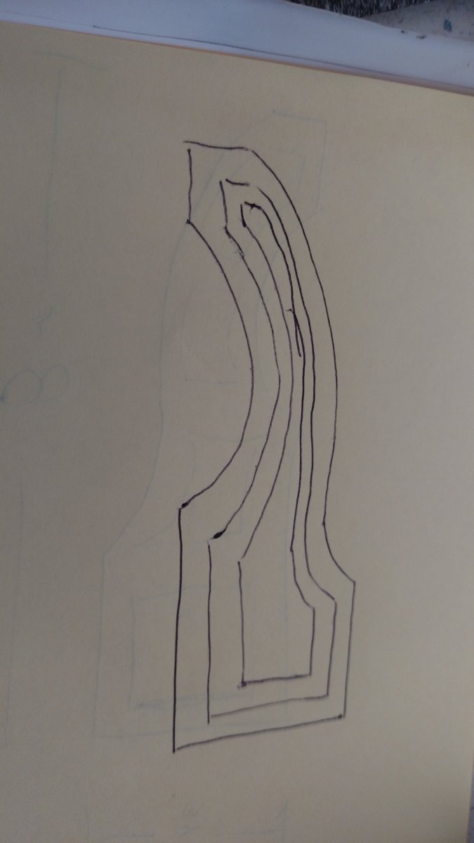

    ...and you clamped the straight edge to the material??? Of course, I've already warned the wife that she's the power motor... she said "will it be as hard to turn the crank as the running boards?". "Oh no dear, much easier"... I like the Ford pickup design above, but it leaves LOTS of panel without the added rigidity of a bead... Maybe a "double outline" like this...
  16. JOYFLEA
    Joined: Jan 22, 2013
    Posts: 2,056
    JOYFLEA
    Depending on your thickness . I use .063 and found the ford design to be good and stiff . The fender will stiffen it a lot as well as the round top .
    Tried some one side rounded step dies today and I think you will be happy with the results . No flex and makes a good panel with not much wrapping. I pre stretched the 2nd panel and no warping . Get som pictures in morn .
    So your going to save on a gym membership . You may have trouble with that small throat on going around the fenders .

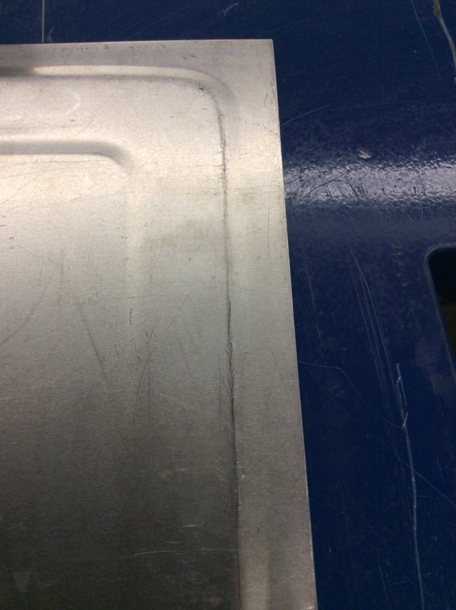

  20. JOYFLEA
    Posts: 2,056
    JOYFLEA
    Skier , left my iPad at friends house so I’m late . The dies I would use are nylon step dies the bottom one has a radius, and bottom ( or vise versa ) has square corners. My roller is adjustable but you can do the same with washers . Play on s**** . I don’t use a guide but a nice straight line with a then line Mark a lot . Go slow . The photos are on s**** with no lines . The square corner is a good line up reference. More ? just ask . Practice on s**** is your friend .all this was free hand . Blue

  21. wetskier2000
    Joined: Jul 11, 2011
    Posts: 1,895
    wetskier2000
    from NH
    Oh boy! That's a really nice style of bead,,, I don't think I have a die like your lower. right one... i'll have to check,.,,
