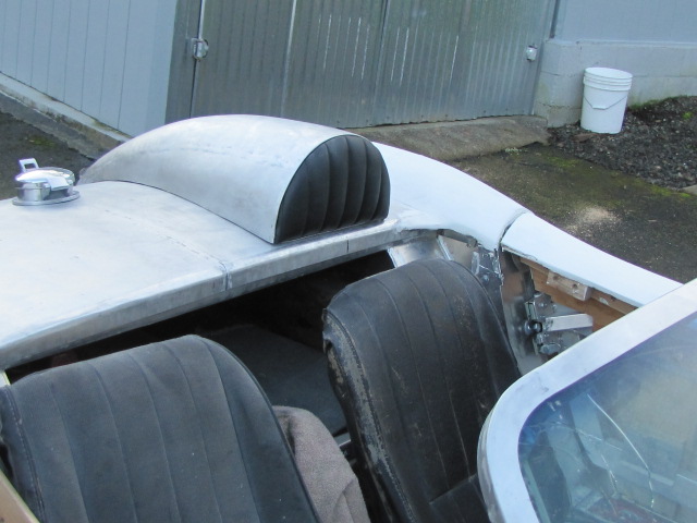

    frankinplymouth
    Busy today making a longer headrest fairing with a pad, lowered the rear of the car a couple inches. Mocked up a longer hood scoop to give the car more length.
    I think i will take up golf................Ray

    I have watched this build for quite sometime and been amazed at the craftsmanship which well surpasses my own. If I may be so bold as to give creative criticism....what are your plans for the windshield? Many have noted the vette windshield does not go with the car and is the last remnant of the old vette..I am assuming that you are leaving it there to tease us. Please tell me you have something in the works.
  18. frankinplymouth
    Joined: Sep 6, 2008
    Posts: 358
    frankinplymouth
    OK, Here is my answer to the vette windshield issue. #1 I have shaved the "cat ears" off which helps. #2 The VIN tag on a vette is on the windshield post #3 I'm 6' 7" tall and needed the C3 tub/chassie and windshield height to work with my size.
    Bottom line is that i need to pick my battles. I have had many builds that were way cool but impracticle. . Not being grumpy...........It's about the build and having fun.Ray

    I agree 100%. I'm tall too and I get it. The corners shaved will help.

    I'm 6'5", I feel your pain... Windshield is a pimple but you put some coverup on it so it's not too bad. The rework on the nose helped tons... I'm impressed Ray... Good work :)

    Also being 6'6 and having vettes that I looked at the top window frame, actually only fit well with the t tops out. Did you drop the seat down and back to fit in better? I have been watching in amazement too. I also like the new nose shape and looking forward to the finished product.
