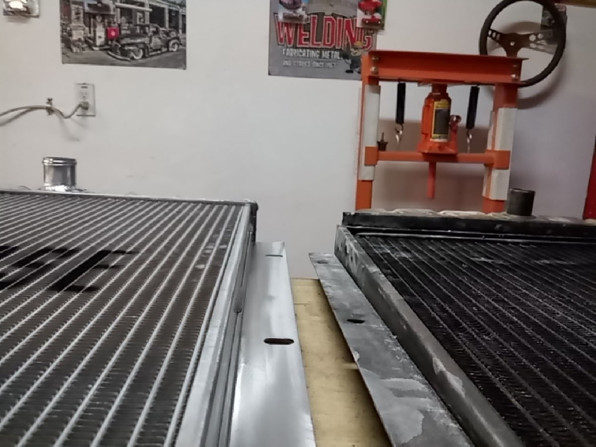

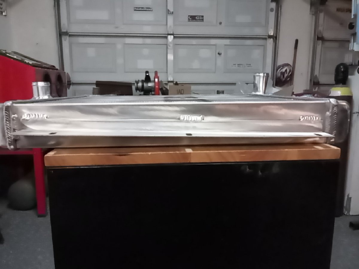

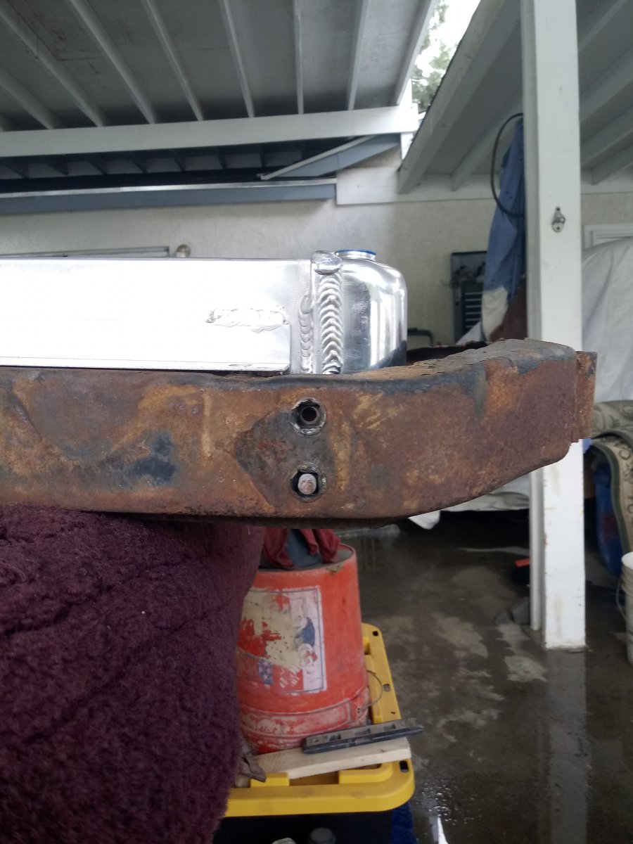

    Fellow enthusiasts...
    I recently purchased a Cold Case Aluminum Radiator for my 1951 Chevy 3100 Truck. The cold case website says that this is a direct fit replacement, however it is too thick and not angled correctly so it does not even come close to clearing the fan. It's worth noting that I have a Chevy 235ci engine out of a 58 Chevy so I've already installed the shorter water pump kit to give me the necessary clearance. My factory Harrison fits like a glove but this Cold Case, although its beautiful and new, doesn't fit.
    Has anyone here had a similar problem with this? If yes, how did you get it to fit. Always appreciate your guys/gals knowledge.
    MM

    This should be a problem for the manufacturer or seller. If it doesn't fit you should return it and get the correct rad or your money back.

    Can you mount it to the front of the core support?
  4. Mr48chev
    Joined: Dec 28, 2007
    Posts: 35,562
    Mr48chev
    I think they just flat welded the brackets on wrong. That or welded the angles to the sides and then put the tanks on the wrong ends. This is the one I bought for my 48 and the photo shows the side bracket coming almost even with the back of the radiator at the bottom. http://www.speedcooling.com/1948-1954-Chevy-Truck-Aluminum-Radiator.html It's out in my storage van and there is a big freaking snow drift beside the van so I can't go check it to see where the brackets are on it. I'm running a 68 292 and for sure don't have any extra room.
    I ran a big thick radiator from an early 50's 2-1/2 ton for years in my 48 and have two 1-1/2 ton radiators that are at least as thick as yours is and they fit in without issues. I'd contact the seller and see what the deal is.
    porknbeaner likes this.
  5. squirrel
    Joined: Sep 23, 2004
    Posts: 59,206
    squirrel
    seems to be kind of common lately, I guess the companies that make these radiators don't have a stock one to see how it's really supposed to be made?
    send it back. Try a different one. Look at pics first to make sure the second attempt does not look like the first one did.

    If i attach it to the front of the bracket then I have to modify (cut) the hood latch panel. I also thought about cutting the bracket down centerline and shortening it but thay looks like more problems down the road. Thanks for replying. I'll let you guus know what Cold Case says as I emailed them this weekend.

    Just cut and reweld the brackets on the new radiator

    Ok. So the Cold Case radiator is made for a V8 only. It will nor fit with the factory 235 or 216 engines. Classic Industries took it back without issue. Unfortunately, on the websites, neither say it is for V8 only. A lil misleading when it says 'direct replacement'. Moving on. Thanks for the feedback, everyone.

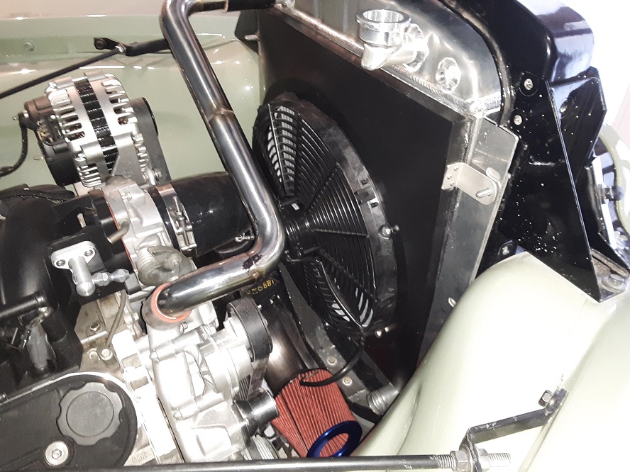

    1. A-D Truckers
    I had similar problems with the radiator for my '49 GMC. I tried several brands and found the US Radiator fits best.
    It is worth noting that the GMC radiator fits further forward in the radiator support than the Chevy - the GMC truck engine was about an inch and a half longer than the Chevy, so the GMC radiator is recessed into the support more to compensate. If you needed and inch or two of clearance, you could run the GMC radiator in a Chevy truck.
    I eliminated the mechanical fan altogether and put a SPAL electric fan on the engine side of the radiator. Here's a foto of my fan and shroud on my '49 -
    [​IMG] .
    And installed in the truck-
