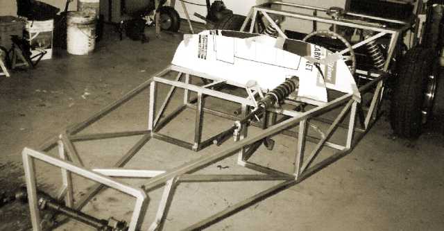

    Another approach would be a lightweight space frame. My Locost has a frame made of 1" square steel tube. The frame tips the scale at 120lbs. Made from aluminum, it would likely weigh less than 100lbs.
    It would not be difficult to adapt a straight axle and crosssprings to this type of chassis.

    I suppose one caution would be that it might be more difficult to pass tech if the intent was to make a 200mph pass in a locost space frame. While I trust it to putter around on the streets, there would have to be some serious re-engineering to make that thing safe enough to be a really fast racecar.
