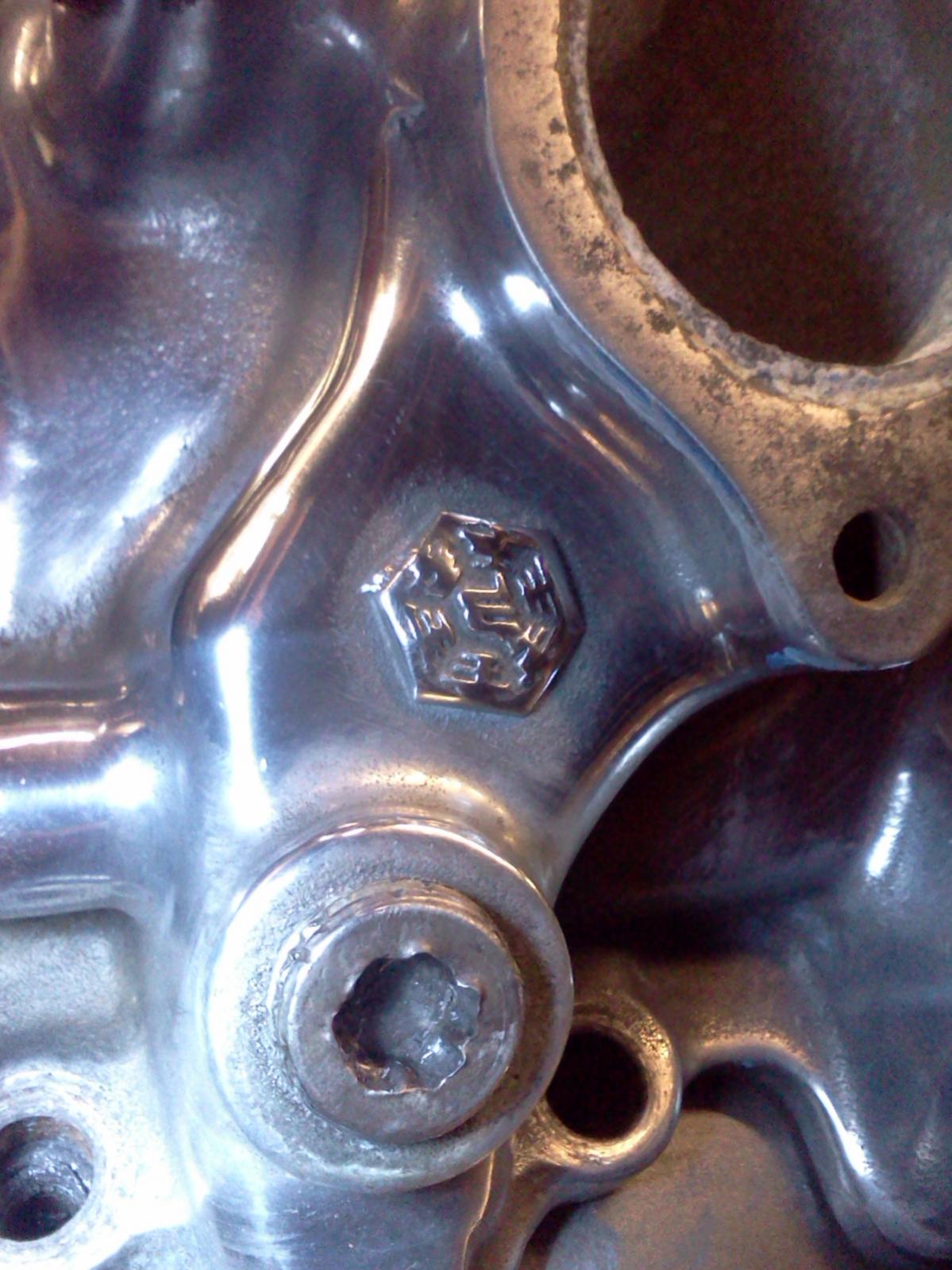

    I got an old Holley intake for a sbc that I want to save/use. Has the winters W on it and says dominator. Im thinking its kinda old. Its got a allenhead plug in one of the front water outlets. Ive tried getting it out, but it wont budge. Im afraid of breaking the aluminum. Any tips or tricks to getting the plug out would be appreciated..Thanks

    Winters foundry used a snowflake not a W for their logo. If it says Dominator it sure ain't a Winters.

    Could that W stand for Weiand ? I know they usually spell it out on their intakes, but maybe not on this version.
    Don
  11. How about a picture of this intake as well as this "W"?

    Holley used winters to cast some manifolds - I had a "zora duntov" edition street dominator that was basically a single plan with a divider cast in and a crossover around the back - it had the winters (snowflake) logo and the firing order on the runners...

    Isnt this the winters W logo? The allen head is bad. Ill try the heat again. Only paid $35 for the intake at a yard sale.

  16. Seems like the Winters mark.
    It looks like you have enough of that plug sticking out to use a pair of Vise-Grips on it. You can also try to hammer in a Torx bit into the hole. That works at times as well.
