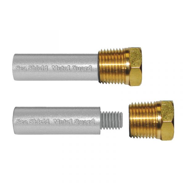

    I'd run a magnesium sacrificial anode (from an RV water heater) to protect the aluminum.
    vintage6t and Bandit Billy like this.
  25. ClarkH
    Joined: Jul 21, 2010
    Posts: 1,573
    ClarkH
    A plain old marine pencil zinc will do the job, and they're cheap.
    mad mikey and saltflats like this.

    I use antifreeze, distilled water and Water Wetter in all my cars. Not for cooling purposes but they advertise that it helps avoid corrosion and electrolysis. I can't answer to that, but it is cheap insurance. The radiator I bought from summit came with a sacrificial anode and a threaded bung in welded in to accept it. Must be something to that.
    saltflats and vintage6t like this.

    Not as well. Check the Galvanic Table, and if you have any knowledge of chemistry, you will see why.
    The magnesium anodes are not that expensive either.
