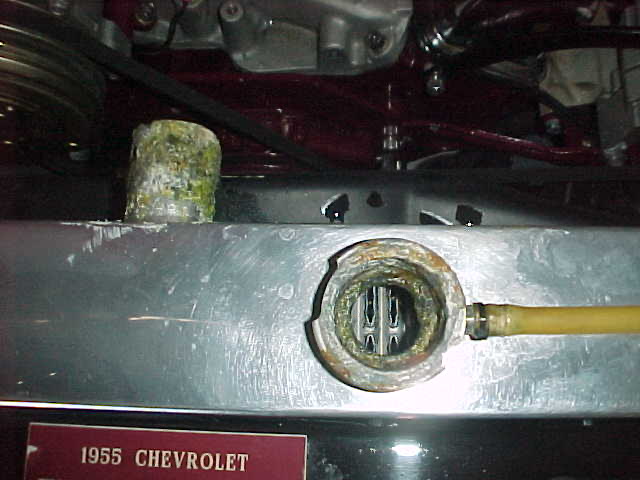

    Anything still requires maintenance on a regular basis. This is my brother-in laws 55 after no maintenance for about 5 years w/anode.
    Radiator Cap.JPG Filler opening.JPG Thermostat & water outlet.JPG Water outlet.JPG
    Blues4U and bchctybob like this.

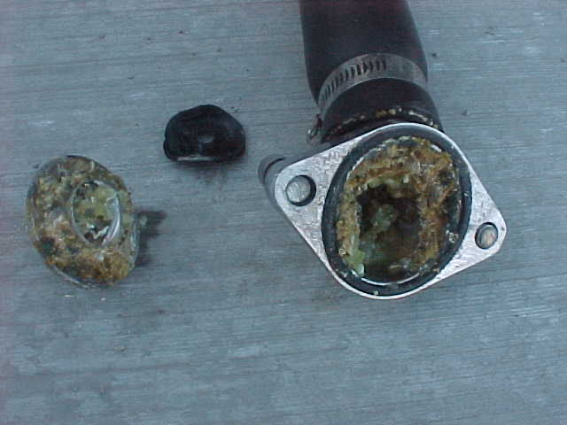

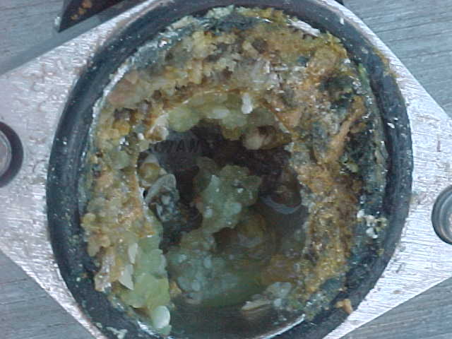

    Seeing as how we are posting ugly pictures and speaking of magnesium anodes, this what happened in my '51 in one year. It was a clean engine with fresh coolant. It has Edmunds aluminum heads that I want to protect. A new anode is shown for comparison
    Dan Hay, rod1 and bchctybob like this.
