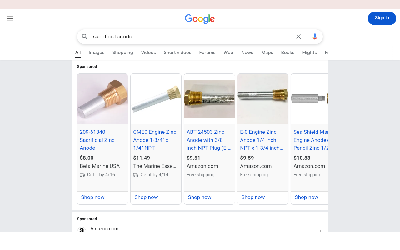

    Cheap , any 1/4"npt access , block drain , radiator , intake , etc Screenshot_20250402-155556.png
    Ziggster, partssaloon and 1biggun like this.
