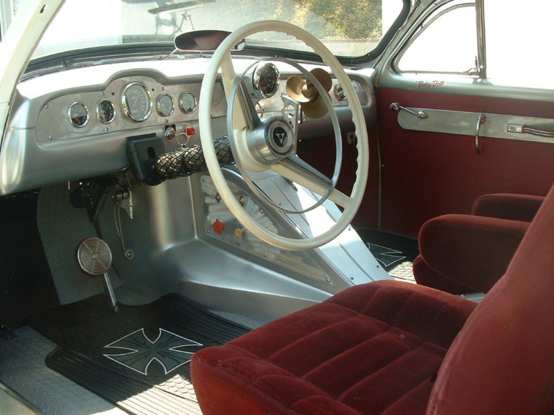

    Thanks, That was my first hot rod and I learned a lot, Really liked how the interior turned out but as with many first timers I was more worried about being really low than having good proportions so the car was about as pretty as a soup sandwich but had some neat features. So I sold it, live and learn
    here is a couple more pictures

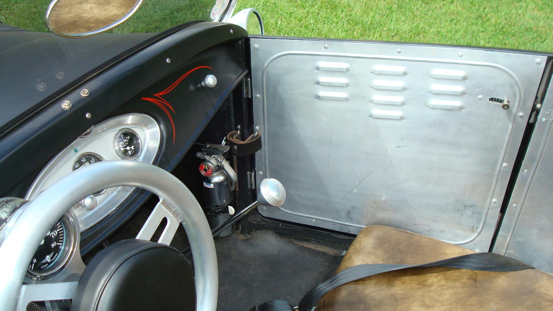

    Different take on aluminum door panels. Used a bead roller and the louver punch on my Zipper panels

    Denis, that is neat! I really dig the little door latch gizmo you have on there. My model A doors always fly open on big bumps and want to add something like that. I hate it when my doors fly open! lol. Any details on how you installed those? Thanks.

    Voodoo Twin....the latches were made by Zipper and they're nothing more than a spring loaded barrel bolt. You can buy something similar at any good hardware store and make it fit.
