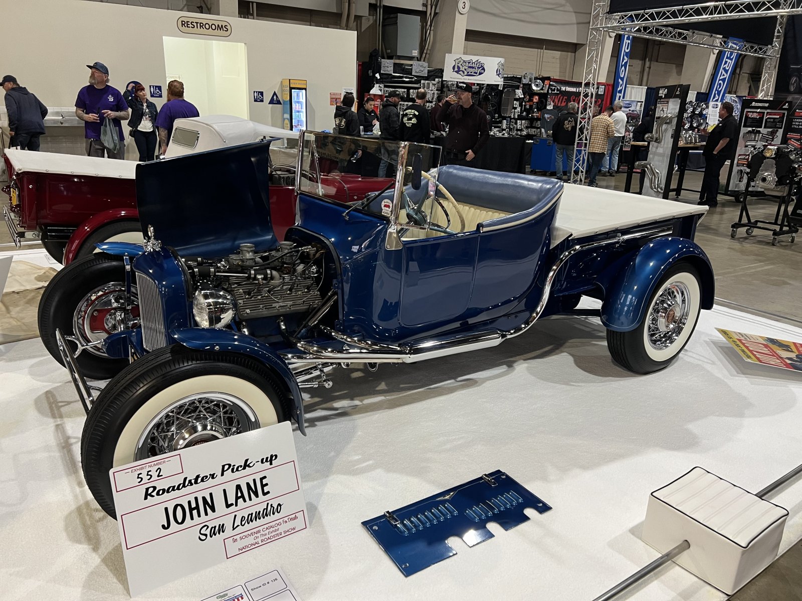

    And I saw that pickup you mentioned at GNRS this year. You can still see the Von Dutch stripes it’s surreal.

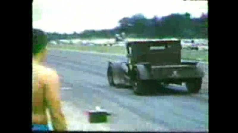

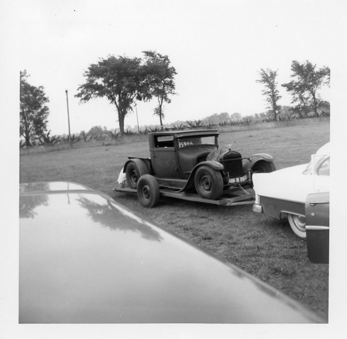

  16. I would not use an aluminum frame on a car to be driven on the street. This car was built in 1953 with an aluminum frame. You can see the aluminum front crossmember in the first picture. It is basically a steel t-bucket with a roof. It was built for drag racing and the street. My brother bought the car in 1974. In 1976 he drove it from Detroit to St. Paul for the NSRA Nationals. When we got back, we found the frame sagged about 1-1/2" in the area of the firewall. He straightened it and reinforced it. Then in 1979, we made another trip to the Nationals in St. Paul. Got home and found frame had sagged again in a slightly different area. That winter I made him a new chassis out of 1-1/2"x 3" steel tubing. That frame is still nice and straight today. carline4-c.jpg 27t1.jpg suicide ride.jpg
    Rand Man, clem and Budget36 like this.

  20. I agree but it is my brothers car not mine. It ran at the 1960 NHRA U S Nationals at Detroit Dragway without fenders and he likes that look det dragway.jpg
