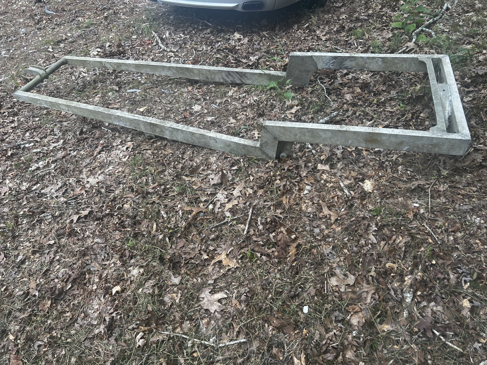

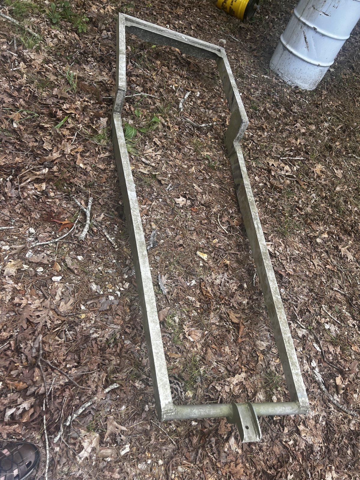

    May be 6" deep some places. Heat treated C channel with 2" wide flanges. No welding so as not to upset the heat treat. open sides. cast aluminum inserts with everything bolted. That was how the engineer built an aluminum frame. This is not what I'm seeing in these pictures.
    This frame is wall art.

    I wouldn't trust that mitered and welded "Z". That thing needs a lot of reinforcing and gusseting to be stress-worthy.
    An aluminum frame would also be a pain in the butt every time you needed to attach a tab or bracket to it unless you were okay with bolting or riveting steel stuff on there.
