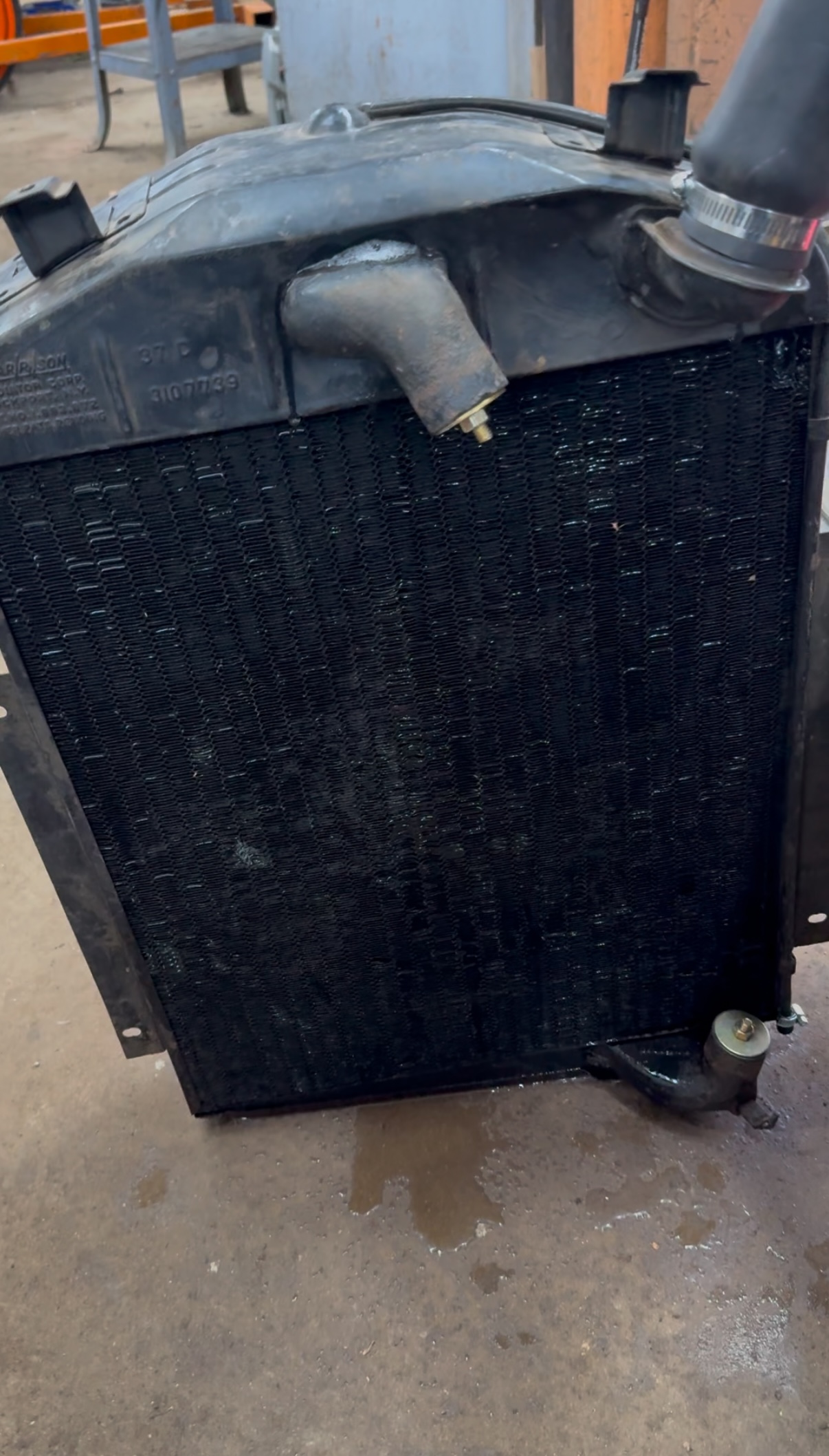

    Bringing this thread back up as i found some big expensive leaks in my Harrison radiator for my '37 Buick and now i have to make some decisions. Theres been a few suggested shops around Mass from people in regards to having my copper/brass original one repaired, and while money isnt the deciding factor, it does have some input, of either having my old one repaired to great expense or having a new aluminum one made, for probably similar money im expecting $1000-1200+ in either scenario. The 320 straight 8 has been completely rebuilt, and plans for the car are to be able to get in and roadtrip it without having to worry anymore than any other car about the cooling system. The 1937 Buick radiator is a little different than the equivalent year Chevy ones and the aftermarket seems to only mention the slightly thinner ones for the smaller 248 engines, so it cant be completely off the shelf but they arent exactly power houses horsepower wise either. Brice Thomas Radiators makes some made in the US aluminum and copper brass ones, with their aluminum branch having a 37 buick one, but i could ask about having it done in copper brass. Im not interested in playing with the china/ ebay ones, and while id rather the look of the original, the radiator isnt really out in the open on these cars either.
    What would you do?

    Yup, just trying to weigh my options. When i first found the leaks, immediately went to trying to find a capable radiator shop that handles the old stuff to repair the original. After a few days, my mind starts to wander and started thinking of "maybe new would be a good idea" since the current one seems to have some big leaks and is just kind of beat up over all. Dented tank, leaking around the water neck, corners had some pissing when it was pressurized, etc.
    If there was a new copper/brass one that Brassworks or US radiator or another company had listed as a buyable piece, and i didnt have to have one custom made because 'oddball Buick', i would have already bought it.
    I know i want copper/brass because it will look right and im trying to do things correct with the least amount of concessions, but also trying to make the best decision for the least future headache.
