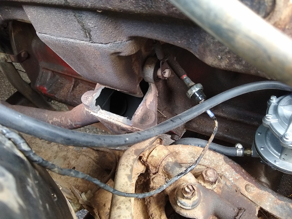

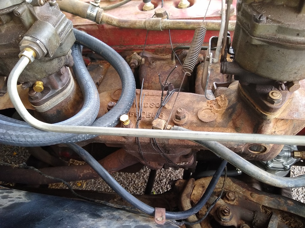

    I call it baling wire, but it's sold as rebar tie wire, all the hardware stores and building supply places have it. I go through a roll probably every 5 years, it's handy around the shop.
    The Hudson is not running as well as it ought to...fuel starvation was plaguing me on the way home last night, not sure what's going on.
    Turns out it's kind of hard to find that Twin H exhaust manifold, it's not the same as the 2bbl. I don't have a line on one yet. I might attempt to repair it, or see if I can get a 2bbl setup to work--I have access to one of those, but the carb has been sitting for probably 50 years, and I'd need to do some exhaust pipe mods, etc. to make it work. My car originally came with a 2bbl, but someone swapped in the 54 engine with the two carbs.

  6. I hope you have better luck at welding old cast manifolds than I do. I have had good success welding and brazing North American cast manifolds. I found that what made the difference for me, was thoroughly cleaning the manifold ( what I did, was sand blast it, then grind the groove in the face where I was going to weld, and then preheating it to 400). Don't forget to use the wife's oven to slowly cool it. :)
    I have used the barbeque to do the heating and cooling, and it worked great.
    My attempts with UK cast manifolds, is another story.
    In my case, I found I had an easier time welding the cast with the machinable cast rod, even though it was more expensive.
    I have also successfully brazed cast manifolds, which is a much easier proposition.
    Good luck with what you decide. I hope you get the problem sorted out in plenty of time.
    Bob
    woodsnwater likes this.

    Baling wire is HAMB friendly now days it's listed as mechanics wire. If you try to braze an exhaust manifold ask yourself just how hot does it get? I've seen them get red hot how strong is br*** it that temperature/.
    47ragtop likes this.

  15. It was done all the time in the late 50s when guys wanted to have split manifolds on a 6 banger. My buddie's brother brazed the exhaust on a GMC 6 banger, and I knew the truck well over a period of 5 years, and there was never a problem.
    This included brazing the plate on one side and making the exhaust extension on the other. I am not saying it is the right way, I am saying that I saw it done successfully.
    Bob
