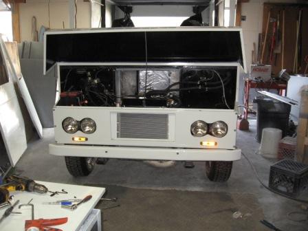

    More primer; I'm just about done with the inside panels. I hope to get everything primered by next weekend except for the rear roll up door and start getting the painting finished up. It's been so hot here it almost kills you to work outside but today was a little better, only got up to 95.

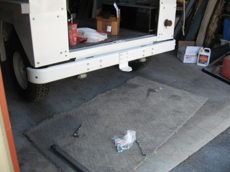

    I was off today so I got some really tedious jobs done. The back bumper and several 1" metal angles and strips that hold in the window gl*** and the wiring harness to the roof all had several coats of paint. I sat in the chair all morning with a 2" grinder and a box of paint stripper discs and got them all cleaned up and primered on the front, black Rustoleum on the back. I painted the inside of the hood black. The front bumper got dropped at a local shop to see if they could get the kink out of one end. The motor had a miss under a load so after messing with carb adjustments for a while I decided to put a better coil and ignition module in my $59.95 Ebay HEI distibutor. Much better now; I guess the Chinese company that built it used some bottom of the barrel ignition parts.

    Pardon my previous rant; I've been working with a really good hearted 19 year old young man who is addicted to heroin and his mom who had been a drug user her whole life. This kid has a lot of promise but his mom insists her drug use has no affect on him, he's angry and doesnt want to try because she lies all the time... it's just a big mess and really painful to watch them both go down further and further. But this is a car thread, I shouldn't bring it here; my apologies.

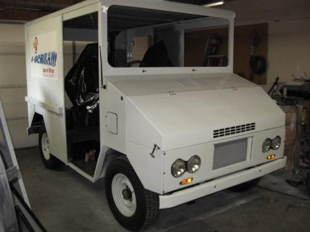

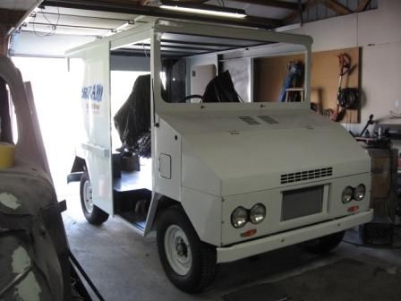

    Back to business; I got the last of the outside panels painted; doors, hood, bumpers, plus some inside trim for the windows. I have to get some more paint to finish the inside panels but it's just about there.

    FV, is that the original bumper? Also, maybe I missed it, what color have you decided to paint it?

    Those are the original bumpers, Otis. I just painted them the same white as the rest of the truck.

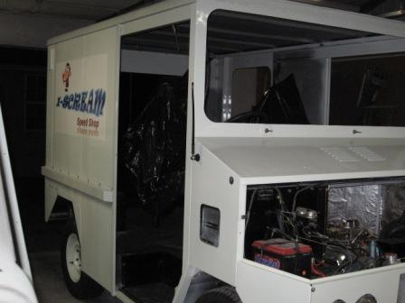

    Got my decals on tonight!

    Those are very nice! Fits that truck!

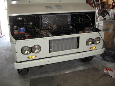

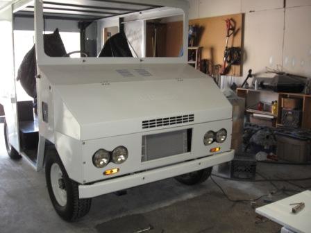

    Thanks sarge; I'm glad it's in the home stretch. I got a 48 Plymouth coupe that I've been neglecting for too long and would like to start working on again.

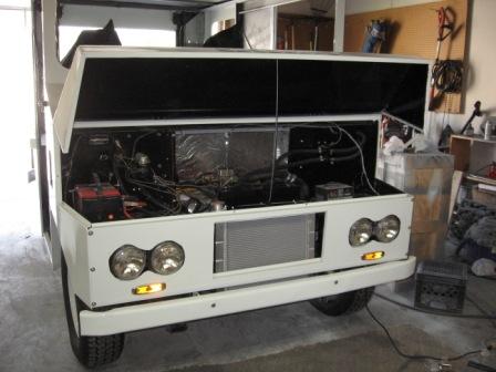

    Got a pretty good amount of work done today. I got both bumpers put back on, put the hood on, built a hood prop, mounted the hood hold downs, made some plate to go on the sides of the radiator to keep air from flowing around the radiator instead of through it, and started cleaning up the windshield for re installation.

    Man FV, I can only hope mine will look half as good when it's done.

    That thing is looking real good, man! I have been checking in a lot and lurking. You have the old box looking good!
