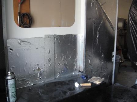

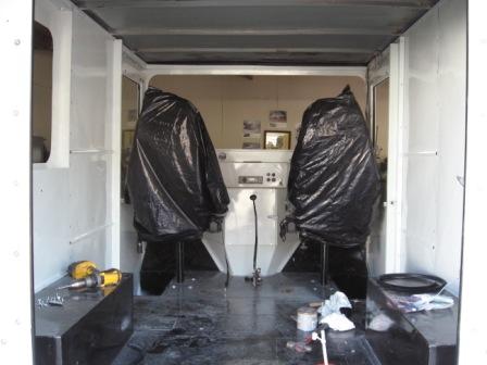

    OK, I got a new windshield on order; should be done Wednesday. I had them cut it all in one piece instead of using two pieces with a divider. Yesterday I got the final inside panels painted. Then I started putting some generic Dynamat insulation on the inside. I got the spring window mechanisms cleaned and greased up; then put the door back together with new window channel; and finally installed the door and the inner panels. I just got one side done, we'll work on the other today. Also, here's the roll of coin grip rubber flooring I bought. I'm doing the whole floor, front to back, with it.

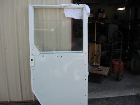

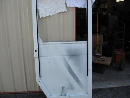

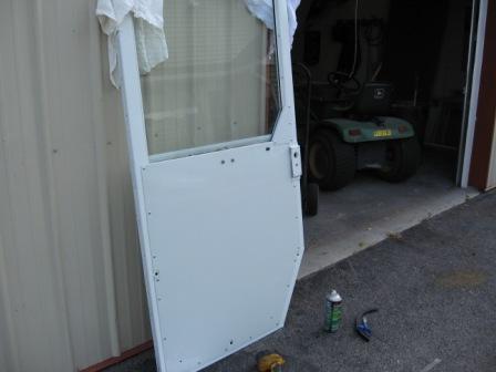

    Finished up side the other side today. The doors seem to work nice and slide easy. I'm going to be making a headliner covered in black ozite carpet with some inset lights and speakers. I also need to cut new panels for the roll up door; that will probably be the last item on the list.

    Over the last few dyas I've put some soundproofing on the ceiling, finished cleaning up the rear wiring harness and installed the inside corner panels and some upper pieces that will hold the headliner, and cleaned up, painted, and installed the door hardware. I needed to chrome the headlight rings and grille but just couldnt spring for the cost so I'm trying this two part chrome finish that Eastwood sells. You have to paint it over gloss black and then put a clear on it. I saw it on My Cl***ic Car on TV and it looked pretty slick so I'm going to give it a shot. Here Ive got them painted black but the directions say you have to paint it in 50% or less humidity so today was out.

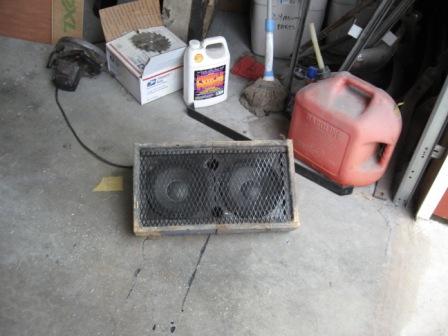

    Bear with me; I went a little picture happy today but got a ton of work done. First off, I needed some speakers so I was going through old band stuff and found a 2- 8" guitar monitor cabinet I built many moons ago and havent used in several years. I cut it in half, put a new side on each half and will be mounting them to the wheelwells. I wanted speakers on the ceiling but when you open the rear door it comes right to the back of the seats so that wasnt happening. Next I cut some 1/8" plywood for headliner panels, installed some conversion van lights, covered them in black Ozite and there you have it. Worked all day from 6:30am to 5:30pm but I'm really happy with the results. Even my beautiful wife pitched in and helped.

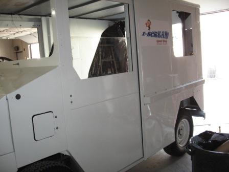

    Got the new windshield in this morning; I decided to order it in one piece rather than two like the old one. I also got the floormat cut and the speaker boxes finished. Not that you'll be able to hear the radio but it has them, anyway. I'm going to let the rubber mat relax for a few days before I glue it down as it was rolled up for a while.

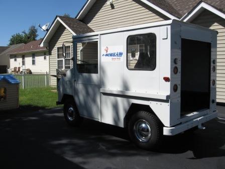

    Well, other than putting the back door on and a couple minor tweaks; I believe I can call it done. I finished up the wiring and it all works, swapped to an auto choke on the Holley (and found a pretty good vacuum leak in the process so it runs much better), finished glueing down the floor, put on the mirrors, hubcaps, and trim rings, put in the side window gl***, and several other minor jobs. I took it a few miles down the road and everything seems to be great. It's running smooth, it's loud as hell, and it'll smoke the tires pretty good so I'm happy. I'll throw a few pics on when the back door is done next week and try to get a burnout video done if I can ever get my son to take a few minutes and help me with it. I might put a start to finish slideshow together if I get the the time. But there she is; just a little under a year from start to finish. Cant wait to cruise as soon as I get plates on it!
