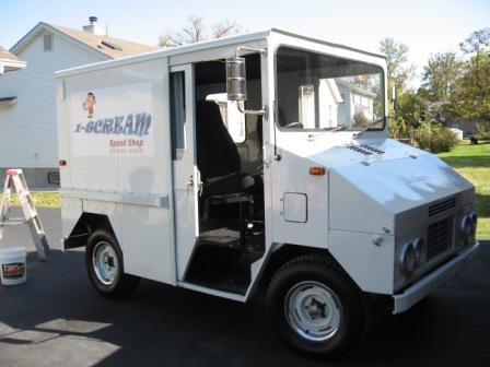

    Quickie burnout in the city water dept parking lot; I was going to do a donut but the back wheel started coming off the ground so I figured I better not. Still some tuning to do but not bad for now.

    Thanks for the kudos, Patrick. Top 5 is quite a compliment. First car show this weekend! I still dont have the back door on it but it's going anyway. Also changed the hubcaps to a full moon style; the baby's didnt quite fit and wouldn't stay on. I went through three different sizes and gave up.

    I finished rebuilding the back door this week. I had some new plywood panels cut and cleaned up all the old hinges, latches, etc.. I think it came out pretty good. Cleaned it up and crusied a couple of local shows yesterday; too. I'm definately going to need to build a fan shroud; it runs cool when your moving but definately does not like sitting still for very long.

    Very cool & a clean build. You are gonna like that big Olds. I put one in my old pickup a while ago. Never fails to impress me how much tq they have.
    I noticed you have the heater hose lines going way up. If they go higher the the radiator fill point, you will have air in the system. You can fix this by either adding one of those radiator flush kits that add a "T" into one of the heater hoses, or add a surge tank from an old Vette. If you add a "T", make sure you put it at the highest point. You will also need to top off your cooling system from the T as well.
    If you decide on the Vette surge tank, they have their own rad cap. You would need to install a high press cap on the radiator, & a lesser one at the surge tank. The surge tank will also need to be the highest thing in the cooling system, including the heater. They reproduce these tanks at most Corvette parts sites (ecklers, paragon, zip, etc). You will need to specify a tank for a non-ac SB car, '70-'72. They look cool & racy too, with the aluminum tank. make sure you get the straps. The tank will need to tap into a heater hose.
    Also, the Olds motors have a big port in the center of each head that dumps hot exhaust into the manifold. If you were doing the heads, it's normal in any Olds performance modifications to fill & shape the crossovers in each head with molten aluminum from a cast piston. Since your heads are already done, I think Edelbrock sells thick aluminum plugs that snugly fit into each crossover. Don't use the thin steel plates that are sold for a block off. The exhaust will also sound better.
    Regarding your motor heating up, make sure you have enough ignition advance. Olds engines will get hot fast if the timing is too far retarded.
    Good luck man!

    That's great info, thanks! I set the timing to the Chilton specs for 1975 and it seems to run good but I'll definately look into blocking that exhaust port in the heads and a surge tank. I'm planning on selling/trading this in the spring and would like to have all the little bugs worked out of it. I used the valley pan and silicone for the intake gasket but I've since seen that there are standard intake gaskets available. Did you eliminate the valley pan on yours and just use gaskets?

    The valley pan "turkey tray" gasket is good to use. It will keep the hot oil from cooking on the bottom of your intake manifold - where the exhaust crossover runs.
    There are the plugs I was referring to, which fit into each cylinder head.
    http://www.summitracing.com/parts/EDL-2733/
    This is the method I would recommend if you were still working on the heads
    http://www.realoldspower.com/phpBB2...days=0&postorder=asc&highlight=miller+filling
    http://www.robertpowersmotorsports.com/Tech1.html
    Also, if you are heating up in traffic, you will need to install a shroud. I would also be using an 18" or 19" factory style clutch fan for maximum air movement.
