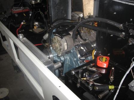

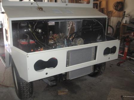

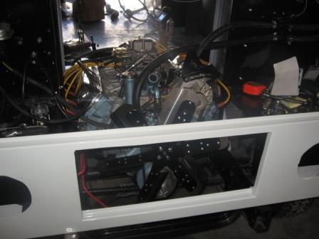

    I took a day off and kicked some **** on this thing yesterday; I hope to test fire the motor today if I can finish a few more things. I got the front end back on and mounted the radiator after building some brackets. I'm going to try a flex fan and see if that will keep it cool. It's a fairly stock engine other than a few bolt ons so I'm hoping it will. Plug wires and hoses are all on, new aluminum 3/8" fuel line run to the back and I've got the tank painted and ready to go back in, trans cooler mounted back in the frame, inside and engine wiring done other than hooking up a few small things and cleaning it all up, all the rear light cans painted and back in, headlights in; it was a pretty productive day over all.

    Try one of the composite/nylon flex fans instead of the aluminum ones (if they still make those...). The "plastic" fan works good and is a lot lighter -- easier on the water pump. They are good up to around 8000 rpm.

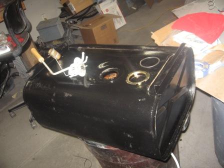

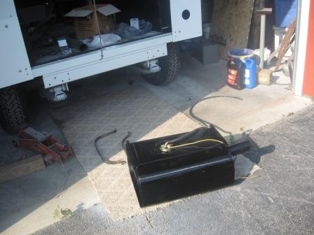

    I finally did get it to a point where I could test fire; finished the fuel tank with a new sending unit, got it in and wrapped up some other small stuff. The battery was dead so I took advantage of the moment and cleaned the shop for three hours while it charged. Still a long way to go but I'm not falling over eveything now. i've got fuel coming up out of the rear air horn on the carb and it'll try to fire but wont. Sound like a float adjustment?:confused: Time to quit for today; lots of holiday honey do's to attend to. You guys have a great memorial day!

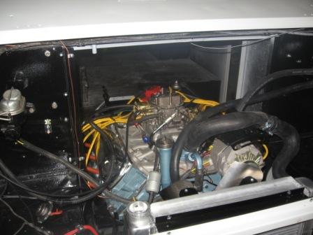

    I got it fired up for the first time tonight. The motor sounds great and all the vitals look good; i forgot just how sweet an open headered big block sounds! I had the distributor 180 degrees out; reset the timing, the rear float and she fired right up![cl[cl

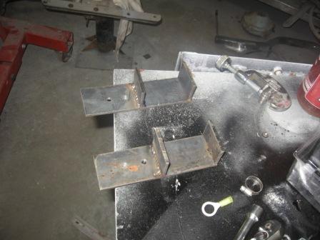

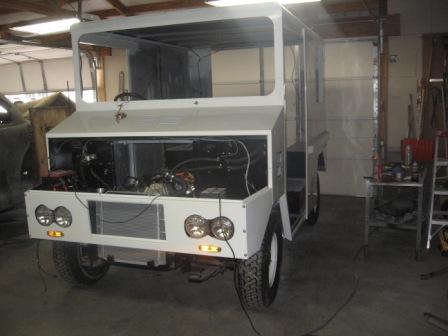

    I made a trip to the boneyard Saturday and picked up some seat sliders from a GMC van and a pair of Jaguar seatbelts. You wouldnt believe how hard it is to find cars with black interior anymore. Everything is gray, maroon, or tan. I think the Euoropean car section had the only few cars with black in the whole 50 acre yard. I got my driveshaft back; looks like they did a good job. The original one was so small in diameter that I had to have them make a new one from scratch. I also spent a few hours yesterday finishing up my seat stands and getting one seat mounted. Also, my decals came in and they look really cool; can't wait to get them on!
