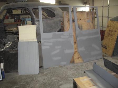

    I had to take the inner wall panels off and the top door tracks, then they came out fairly easy. Mine were hard, too. It was because of years of crud built up in the rollers on the top. They should work fine now. You can get new hardware cheap from www.stepvanparts.com. We did have a good 4th, although my sister lost her house to a fire from fireworks. Luckily they all got out OK.

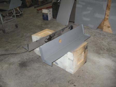

    Anyway, I'm in the process of fabricating Lorrie's Engine and Storage Cabinets. Had to make some NEW Saw Horses on which to cut the Verola Plywood. When I got the Plywood, I also got the FRP Paneling to line Lorrie's Walls and Ceiling. So NOW it's just the HEAT, HUMIDITY, Mosquitoes, and Fleas that are holding up the progress. I'm going to start working early in the morning, and late in the evening when it's cooler, and all it's going to take is a big can of OFF! :)

    My friend got the hood straight for me and I've been working on the doors and inside panels. I got some of them primered this morning. Gotta stop for today, my oldest daughter is moving into her first apartment so I've got to go load up.

    In the meantime, I've fabricated two NEW Saw Horses, and have them set up in the Light/Vusic Studio where it's cool.
