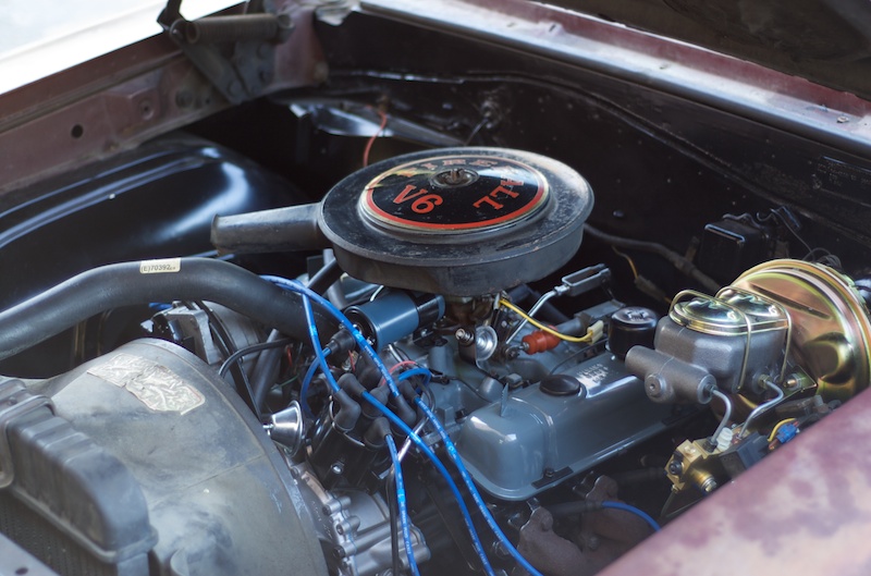

    i learned something about the nailhead, thanks for that. it's definitely a fireball though, since it says on top. the car runs absolutely great, until it hits that upper limit. then it sputters a bit and goes slightly rich.
    i'll check the oil in the rear end. most everything else is new. engine is 125psi in all cylinders. i thought of the clogged muffler, but didn't think it was likely, has anyone had a problem with a clogged muffler before?
    here's a couple pictures

    Here's a goal for you......many years ago, I had a '64 Skylark hardtop, 225 V6/2 speed automatic for a daily beater. One night, I held it to the floor for around 5 miles on a fairly flat highway, and finally got the needle to touch 100 mph, so I know it's possible. Have someone sit in it (with the engine off!) and hold the accelerator pedal to the floor. Peer down the carb throat with a flashlight and make sure that it's fully opened. That Rochester single barrel can't afford to be misadjusted if you want to squeeze all 17 horses out of that "Fireball".

  16. check the muffler and air filter too, its gonna need to breath w/ zero restriction so to speak...also as said, make sure its opening all the way.
    I've also heard of exhaust piping being "layered" on some vehicles and the inner layer collapses some restricting heavy breathing...run great normal driving....dunno if this is even the case with that car though.

    I didn't check to see if your car has a heat riser. If it does, make sure it's operating and allowing flow.

    I had a 307 chevelle that would top out at 90 ,Id check the muffler and carb ,Glad zman is back,I needed a good laugh

    oh, someone mentioned fuel pressure.... these old cars often have clogged fuel filters. i'd check that first. my 62 235 started acting up. no power... i'd have it floored going up a slight hill. i removed the fuel filter and it was clogged so badly with rust particles from the gas tank that i couldn't blow any air through it. how the motor got any gas at all was a mystery....

    Seems like you have a fuel delivery issue. Check the fuel pump or fuel filter. Maybe check the air filter too.
