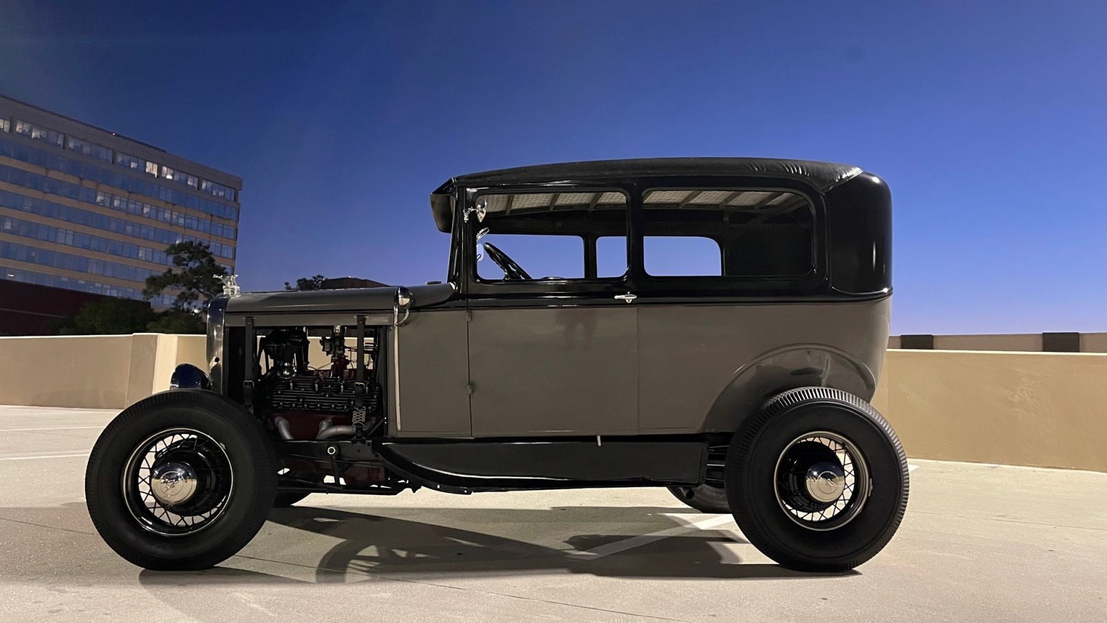

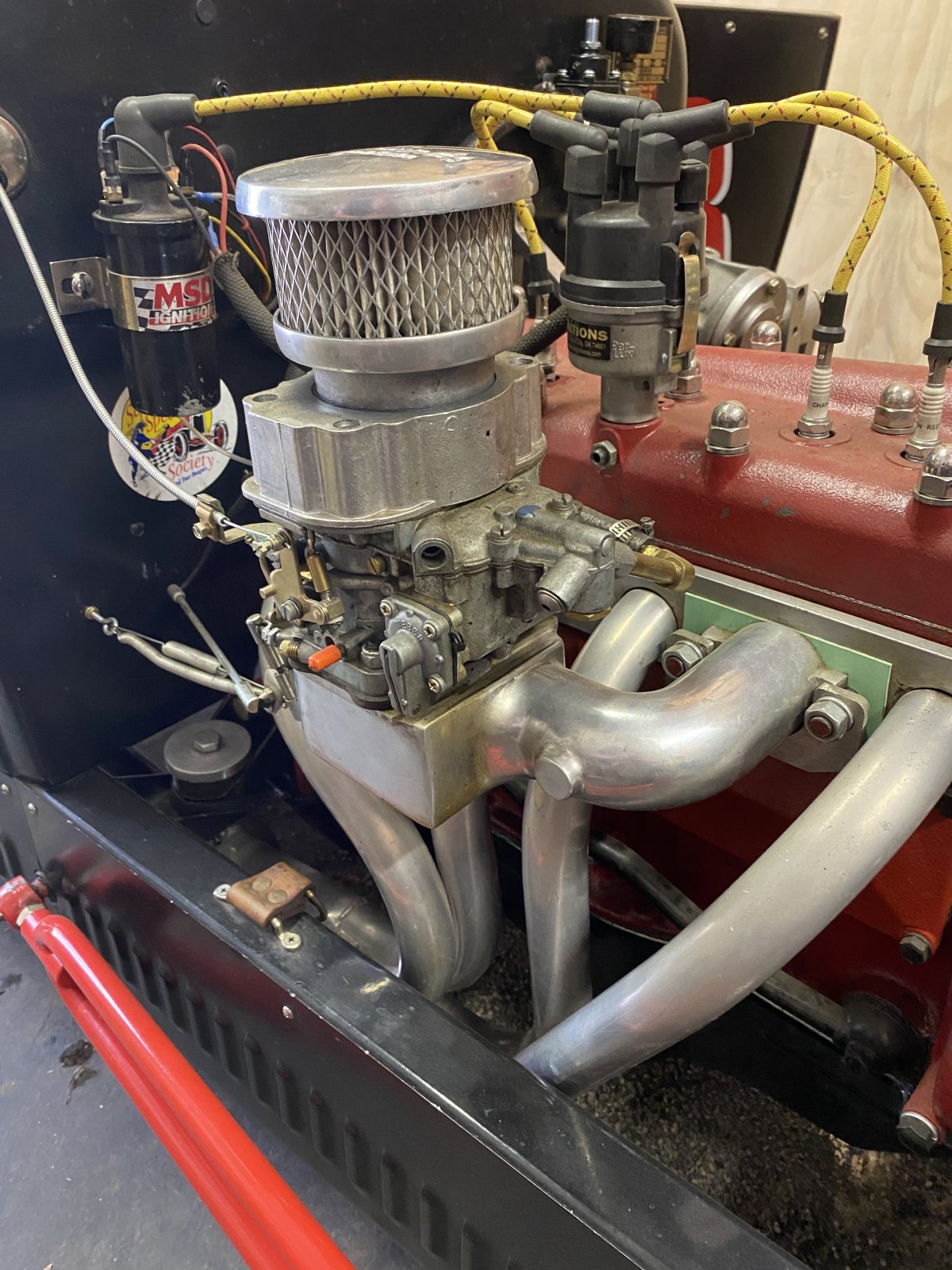

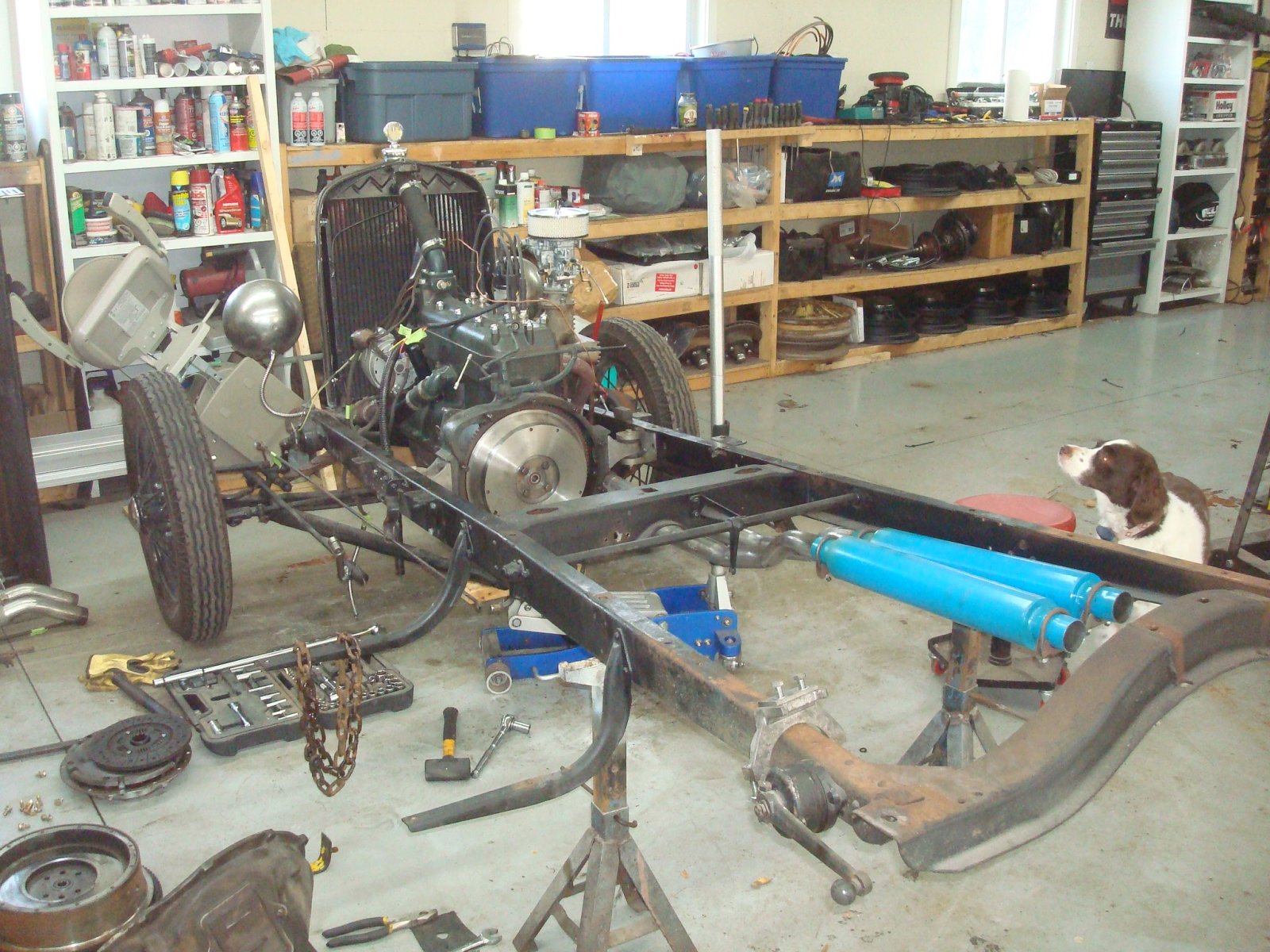

    My dream too!
    Engine/Driveline a bit newer. But, still a Banger!!!!

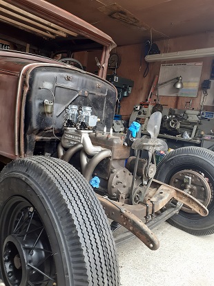

    I would say GO FOR IT ! I am currently building a Banger powered 30 Coupe - I`m unsure of the era but I am sure plenty folks will tell me when its done .It is not cheap for 4 banger speed equipment though ,especially here in Scotland !!!I have put a picture up for you but if you go to my Youtube channel (jimshotrod) there are a couple of videos of progress and I will be updating them whenever I have done any significant work.........it`s not a "how to" channel more of a "this is achievable" channel. 20220714_104254.jpg

    @trikejunkie what headers are those on your coupe? Really cool piece!

    Those are from Charlie Yapp ,definitely different than normal headers..

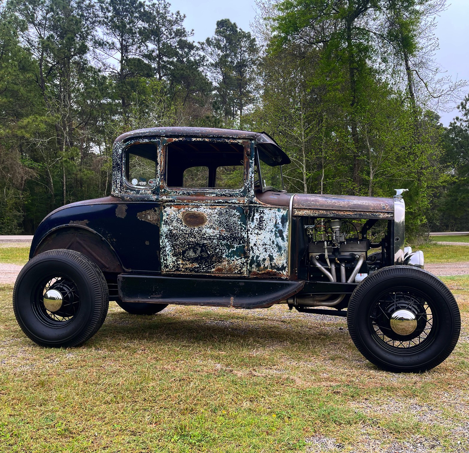

    So I have done things backwards... I have owned a banger coupe, then rebuilt a flathead v8 car, sold that to buy and build the blue banger coupe. Stock bangers are ok, everyone should drive one once..... Hop up that banger and its alot of fun trying to go fast in a slow car. Get some major HP in a banger, around the 100 hp mark and some deep gears and really change things up. My stock crash box trans behind the 95 hp b motor rolls 65 to 70 easily. Put it this way, from stop lights I outrun most normal traffic without trying even with the stock trans.
    The flathead v8 I had was 120 hp probably. One thing notable, you have to spin the flathead v8 up more for the same torque of the banger. Noticeable difference in driving, the banger will outperform just about anything of the years on the bottom end. Torque curve like no other.
    There is a reason I am back in a hot banger car. Now trying to justify a miller ohv to myself is the hard sell. But it could net me some big power.
    In order of my last 3.... The blue banger is my latest... The cream car was an unrestored survivor, was too nice to cut apart at the time. Its addicting man... enjoy....

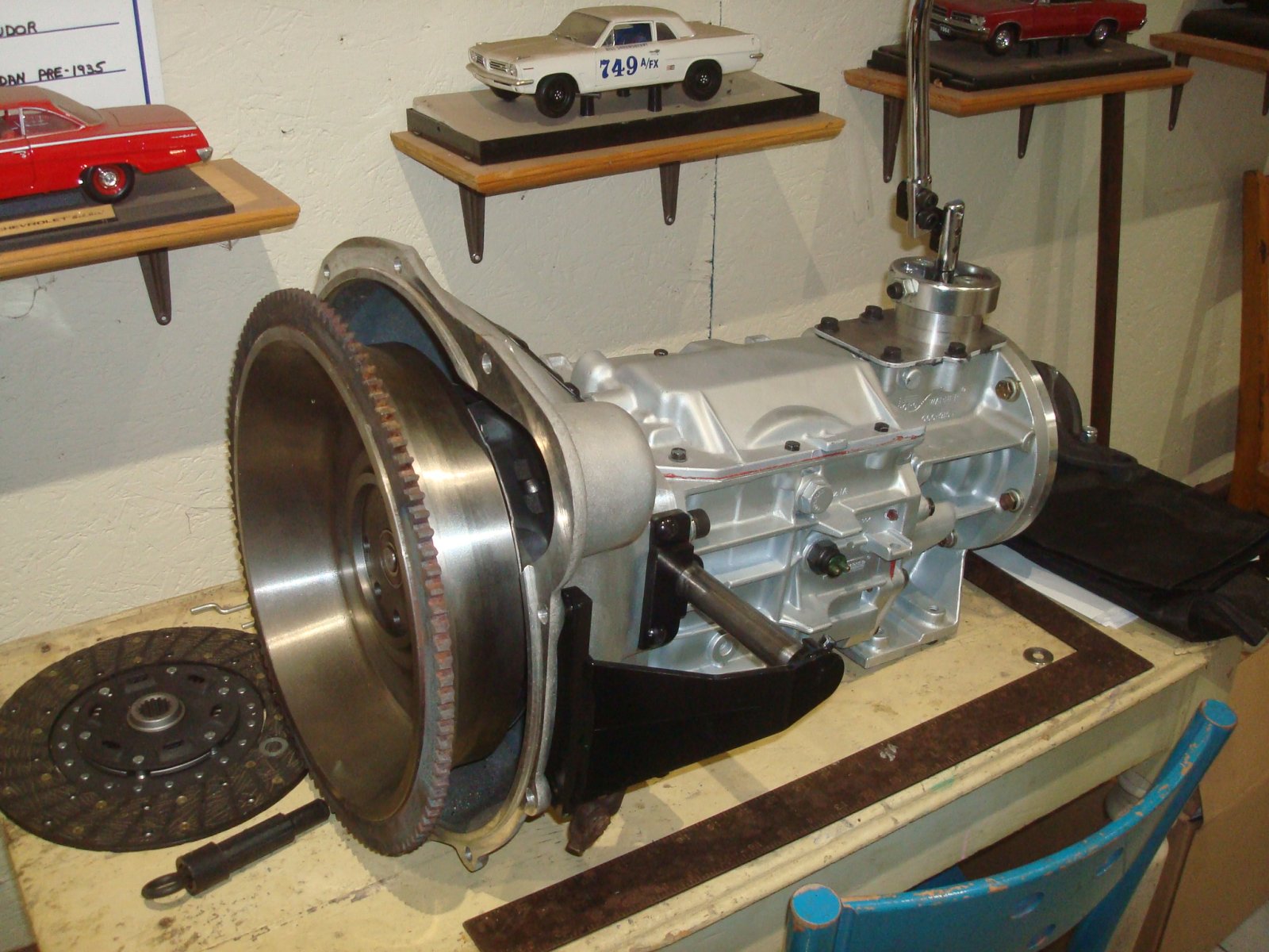

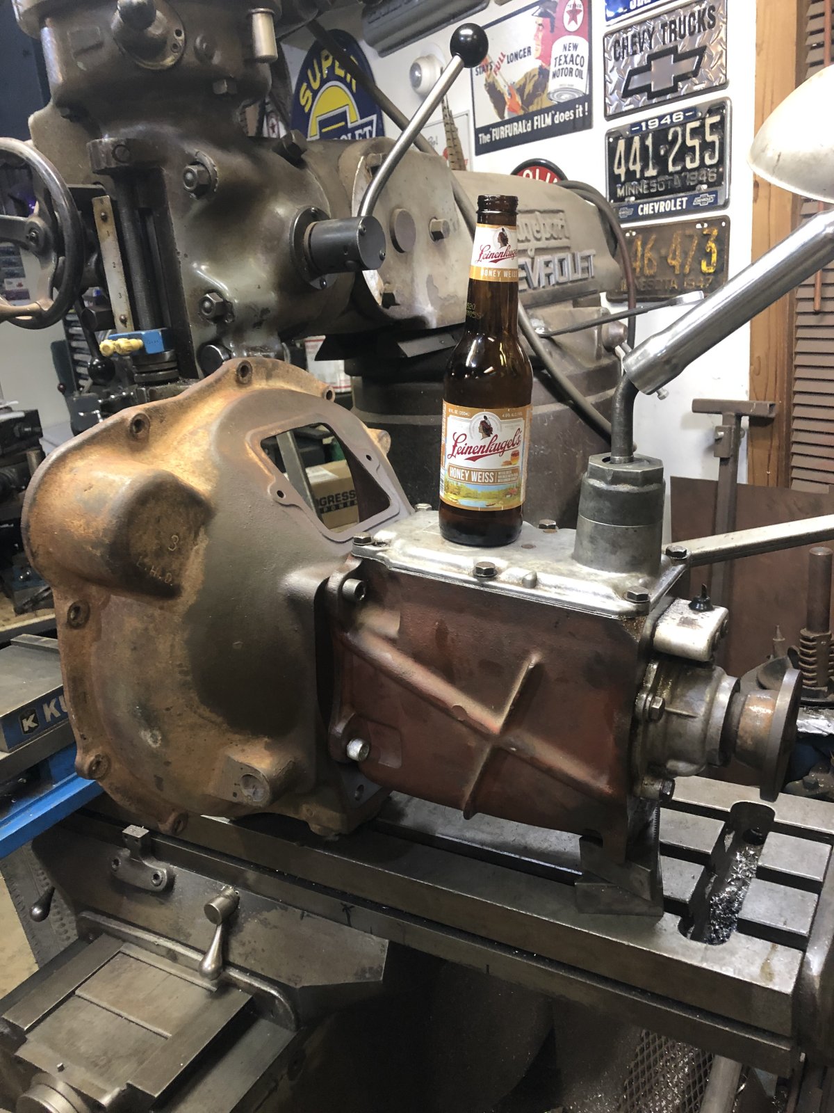

    One of the Hangups of running a banger is low hp.Its still plenty of hp for a light car. I think one of the biggest improvements i made for drivability is getting rid of the stock 3 sp and going so something like the t-10 or the Volvo 4sp conversions i have been doing.  IMG_4102.jpg
