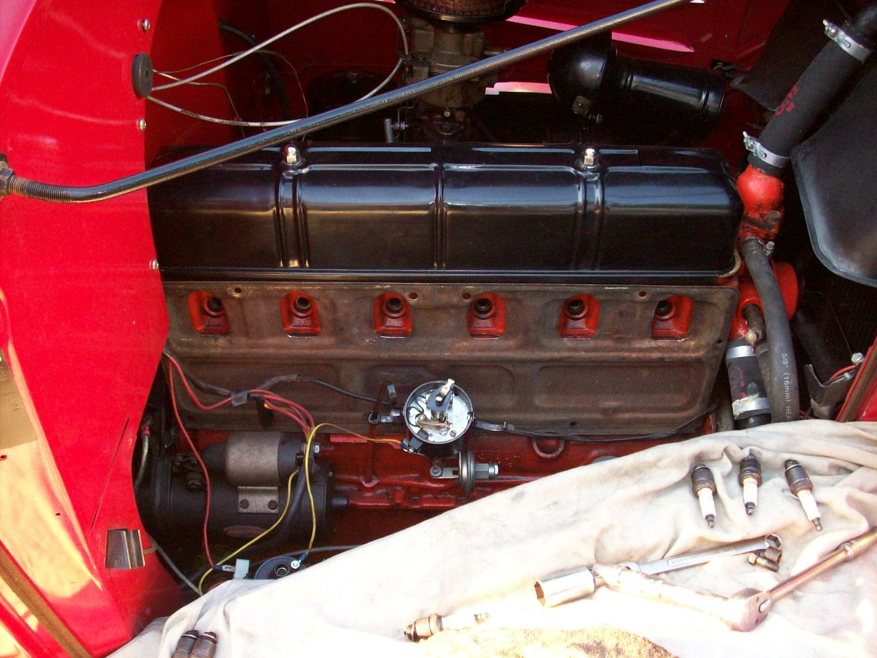

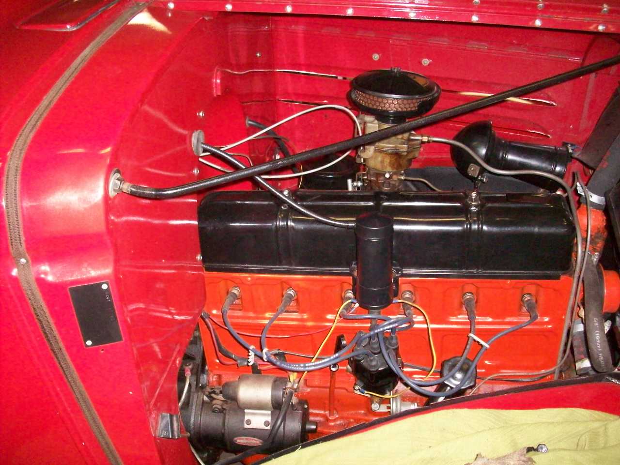

    You really dont have to do it to get a full side cover,right now I am trying to prefect the installation of a 216 side cover on the later 235s and possibly a 261 if one would show up. The first one I made is noticable but has fooled some but I want to do it better,the only reason I am thinking about the early 235 is my present 235 has some noises that thick oil as made less noticable so I got problems and with a early 235 I wont have to fake the look. Here are some pics of what I have done so far on the side cover,I recently picked up a 37 cover with the plug wire holders but need a junk head and block to get the area around the plugs a little better then what I have done so far.

    Flop
    heres my problem my junkyardjeff. those look good !! takes a good eye to realize whats going on !
