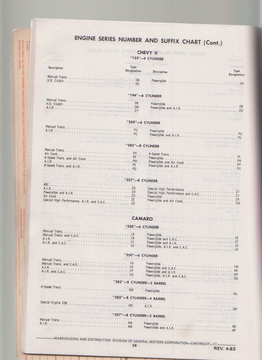

  10. squirrel
    Joined: Sep 23, 2004
    Posts: 59,241
    squirrel
    Chevy says they put the 283 in 67 Camaros....2bbl or 4 bbl, engine suffix MD, MJ, MO, MP depending on carb and transmission.
    You probably have a rusted away head gasket in the original engine....
    volvobrynk and BnG Engine like this.

    Jim....MO and MP are 1967 Z28 302 engine codes...definitely not 283. Don't know about the other codes offhand. Also no 283 engines in any Camaros ever. 1967 Camaro V8 was 327.. 2 and 4 barrel...SS 350...SS 396...and Z/28 302...if it is a 1967 283 it's either out of a Chevelle or full size Chevy like Impala...
  18. metlmunchr
    Joined: Jan 16, 2010
    Posts: 876
    metlmunchr
    MD and MJ were 283 codes but the Camaros with those engines were built and sold only in Switzerland.
    MO and MP are codes for a 302
    Camaro specific code info at http://www.camaros.org/drivetrain.shtml#PadStamps is far more accurate than the same info that shows up on other sites where code info across all Chevy lines is included.
    In reality, the Camaro didn't need a 283 because the 2 bbl 327 they used in base models was so anemic you needed to watch a reference point to see if the car was even moving :D

    One of my neighbours bought a brand new '67 with a six and a PG. Boy, if you thought the base 2bbl 327 was anemic...
    Funny thing was, a year later, another guy just down the street had a new grey '68 Z/28 with factory 4.10s. Quite the contrast.
    Kinda makes me chuckle when I see all those guys with typical HAMB 3.08 geared street rods on Jim Sibleys thread, laughing and making snide comments about all those "losers" who "think" Camaros are hot rods...Oh really?:rolleyes:
  20. squirrel
    Posts: 59,241
    squirrel
    ok, I guess it's a misprint in Chevy's book, they didn't know the 283 was really a 302.

    Never saw a 67 Camaro with a factory installed 283. Had a friend in high school that had a 67 Camaro 327 2barrel 210 hp I think. I helped him install a junkyard cast iron 4 barrel intake with the small Rochester 4 jet carb. 1 5/8" headers & dual exhaust with real Corvair turbo mufflers from the Chevy dealer. It came from the factory with a 3 speed floor shifter and 3:55 rear gears. It really woke up the performance of the little small block!

    Jim...not busting your balls...just want the right info out there. That book you showed is a trip...is it a GM parts book or a Motors manual?

    Same here. When the OP said he had a 283 from a Camaro, I knew immediately that wasn't the case. No big deal except for the fact that he's talking about boring (and buying pistons). There are several instances of 2 letter codes beginning with D where the same code identifies a 283 and then identifies a 307 a year or two later. With both having a 3.875 bore I figured it was useful to mention the need to make sure what he actually has before buying parts.
    If the OP would post the complete engine ID we'd likely determine its a Corvette motor. After all, out of the hundred million SBC's made over the years, at least 50 million of 'em were Vette motors once they were out of a car and up for sale :D
